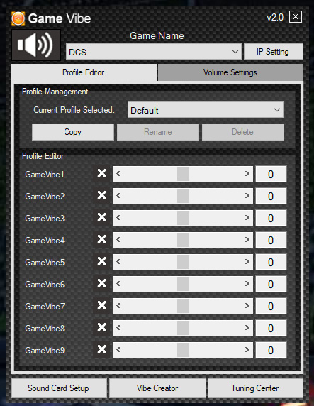

    Help, after reinstalling windows and re-installing everything, I have this problem, I don't have game data.
    22,196
    154,639Coins
    +11,206 / 57 / -2
    Just checking, do you have a Pro SimTools license.
    If so can you please post pictures of all of your settings.

    DCS plugin don‘t support game vibe.

    If I have a PRO license, it happens in all games, nothing changes. Gamevibe1, gamevibe2, etc. always come out

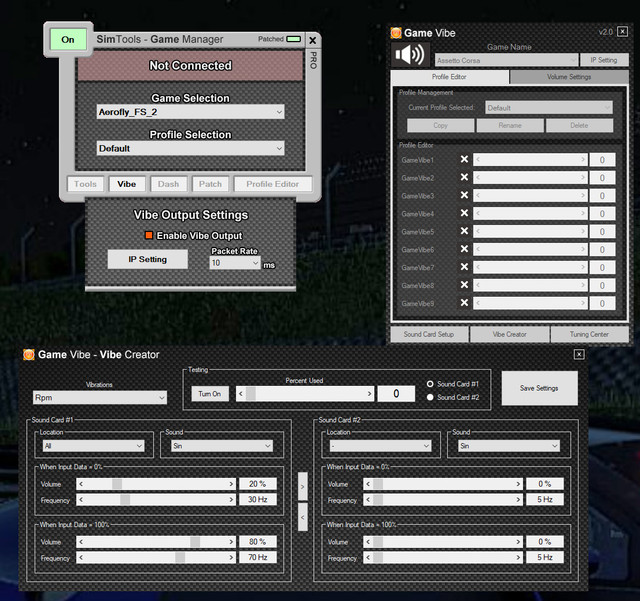

    The games you have shown pictures of, DCS and Aerofly, do not currently have GaameVibe support. So test with LFS then configure for games that do have GameVibe support.

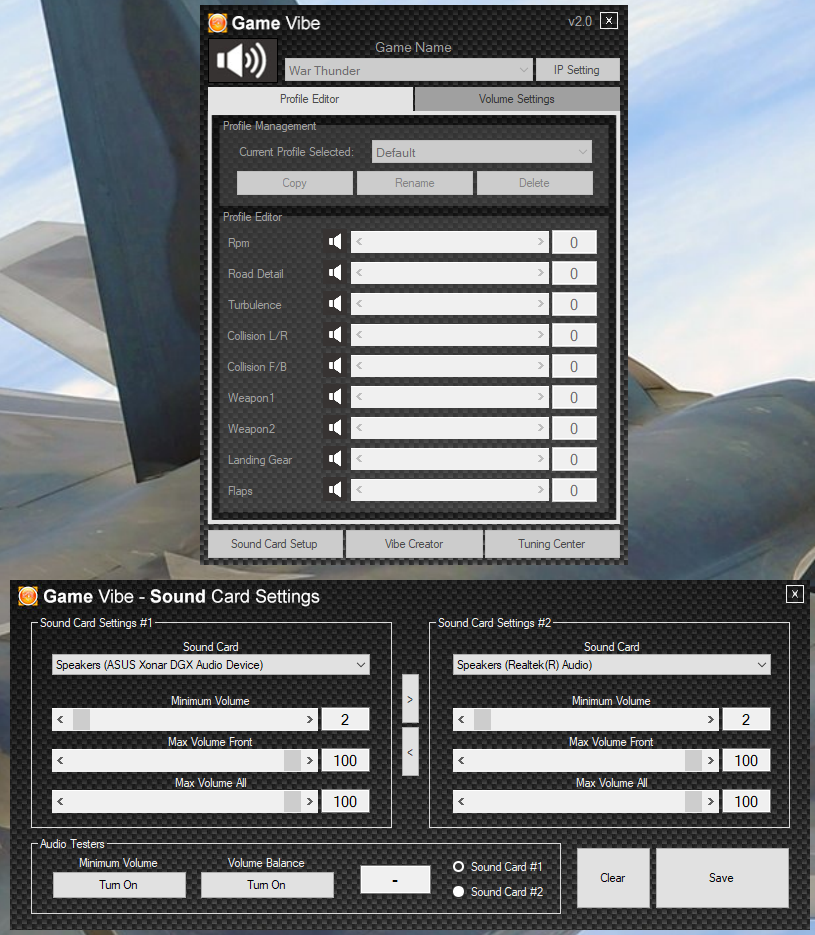

    I just installed Gamevibe today.
    When flying in War Thunder my Hotas controls stop working?
    When I turn my amp off the controls work?
    What am I doing wrong?

    That sounds like USB problems. did you check different usb ports?

    I just swapped all 3 USB’s, the throttle the joystick and the rudders into a different USB powered PCI card and I have the same issue where when game vibe is running I lose the hotas controls? When I turn the amp off I have control of my Hotas controls again
  13. yobuddy
    51,734Coins
    +5,205 / 19 / -0
    This sounds like a possible grounding issue?
    What does you GameVibe setup look like buddy?

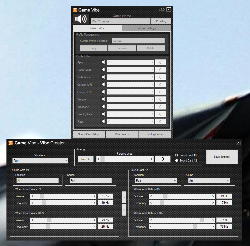

    @yobuddy - Sorry for late reply.
    I have 2 soundcards setup for simvibe. I have successfully added these to gamevibe and they both work in the soundcard setup.
    However in the gamevibe creator setup only soundcard 1 will work? What have I done wrong?
    I have also setup the gamevibe tuning.
    I am unsure what ip address to add, so I added the IP I have fir the game engine. Is this correct?
    I have no issues using simvibe with my racing games.
    I have no issues with my warthog Hotas setup when using the Next level racing V3 seat mover with their platform manager tactile feedback.
    For some reason my Hotas controls stop responding with gamevibe?

    If you using GameVibe of the same PC as Game Manger / Game Engine, then the IP should be 127.0.0.1.
    You select sound card 2 radio button click turn on and nothing?
    I only ask because the same code is used to test and configure sound.
    So it makes little sense to me why it would worn in one spot and not the next is all.
