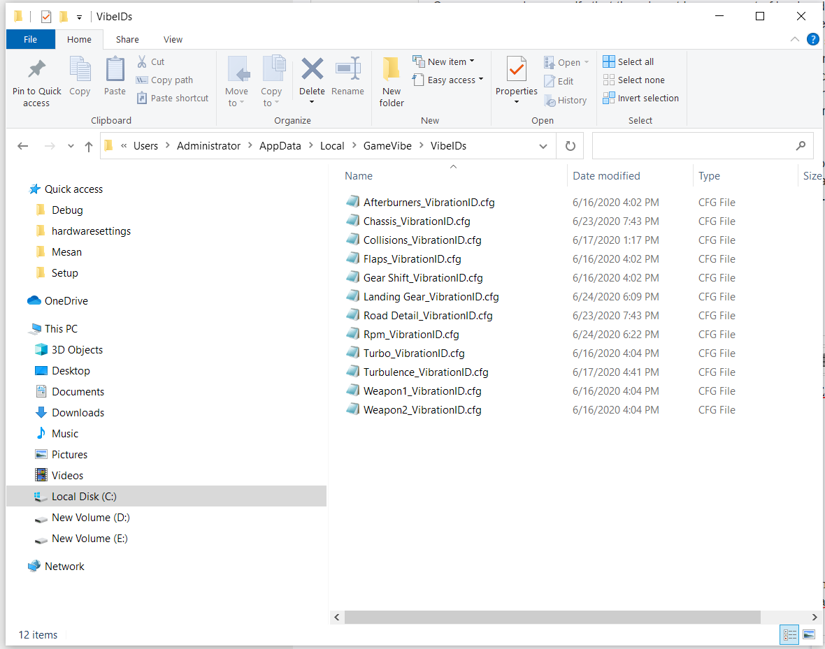

    @ERGUN OZYURT,
    Are you using the latest SimTools and GameVibe version?
    Could you please list the files its looking for?
    These same files get used for all games, so if others work...
    It has me a bit stumped.
    Chat soon,

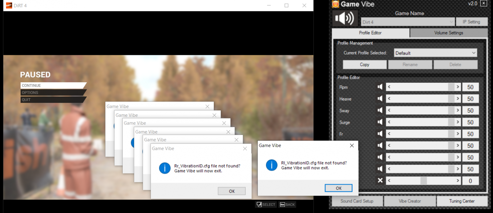

    Yes. All of them are latest. Also I can not find files which are listed in error messages. What is the folder of files they should be in ? I looked folder "C:\Users\Administrator\AppData\Local\GameVibe\VibeIDs" but not found. This is the scrren of that folder.

    @ERGUN OZYURT,
    Do you maybe have a beta copy or something?
    The files look right, but the files it's looking for seems to be out of date?

    I have pro license of simtools. For vibe, I downloaded from simtools.us web site before install. Very interesting...
