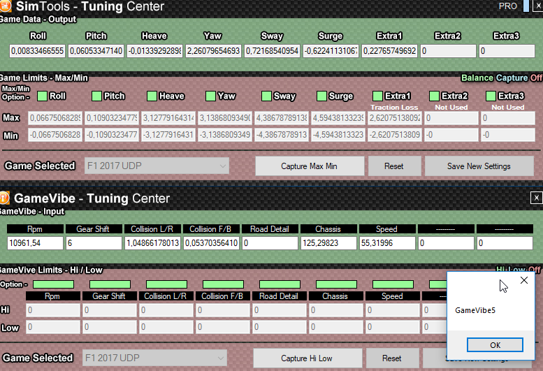

    Hello everyone,
    Due to some requests, I'm starting to look at adding gamevibe support to the various UDP plugins I made. As it was mentionned, it is pretty straightforward if you already manage gamedash data.
    However I have a strange issue : I do get a modal popup that stops gamevibe from updating :
    What is this GameVibe5 dialog box ? A value gamevibe didnt like ?
    I'm currently working on F1 2017, Project Cars 2 and both have the same issue (GameVibe3 for PC2, GameVibe5 for F1 2017). I'll work on assetto once PC2 and F1 2017 are OK.

  7. Blame73
    Blame73 Well-Known Member
    Nov 6, 2014
    1,216
    8,315Coins
    +1,140 / 5 / -0
    Seems like a debug msgbox
    Things sometimes you forget to comment in release versions

  9. yobuddy
    51,737Coins
    +5,205 / 19 / -0
    This means there was an error for input with gamevibe5
    GameVibe uses keywords in order to startup the correct sound effect.
    For instance, there is no speed input, Turbulence is the keyword here.
    Turbulence (Speed)
    I'll add to the plugin creation thread when I have time this week.
    Should clear things up a bit.
  10. yobuddy
    51,737Coins
    +5,205 / 19 / -0
    There is no speed input is why.
    Yes what you did works, but that's not how we want to move forward.
    We don't want everyone making up there own keywords or this will be a mess in the end.
    PM me @vthinsel if you need a little help buddy.
  11. vthinsel
    vthinsel Well-Known Member
    Feb 20, 2015
    439
    FRANCE
    6,059Coins
    +570 / 2 / -0
    Arduino, 4DOF
    Oups ! Sorry. I'll update the plugin accordingly and send it to my beta tester :)
