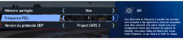

    I also noticed a stupid thing in PC2: they reversed the UDP frequency : UDP 1 means high freq updates, UDP 9 means low freq update. I do not know if they messed the french translation, but it was reversed.

    Maybe I'm missing something but it seems the lower the number is the faster the updates?

    English translation: a low value will generate less frequent data, reducing network traffic....

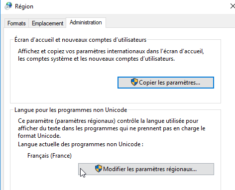

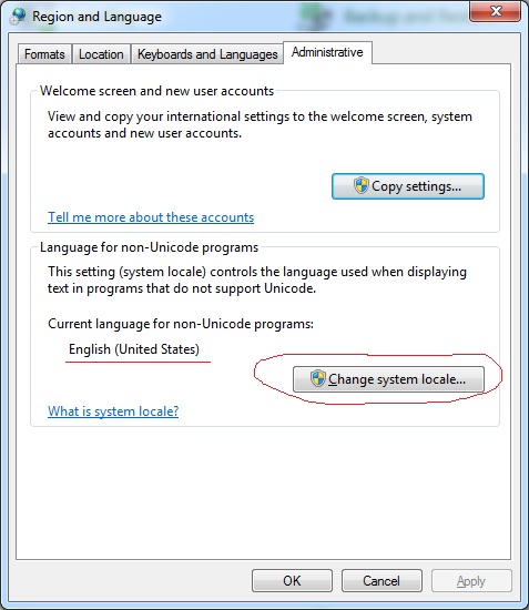

    @vthinsel
    When you did this test;
    What system local were you in buddy?
    Was it set to something other than you system default?
    I just wonder if the results change with a different setting is all.
    Thanks man,

  12. vthinsel
    vthinsel Well-Known Member
    Feb 20, 2015
    439
    FRANCE
    6,059Coins
    +570 / 2 / -0
    Arduino, 4DOF
    It is in french:
    Could try again the tests with separators, but I do not think it will impact the result

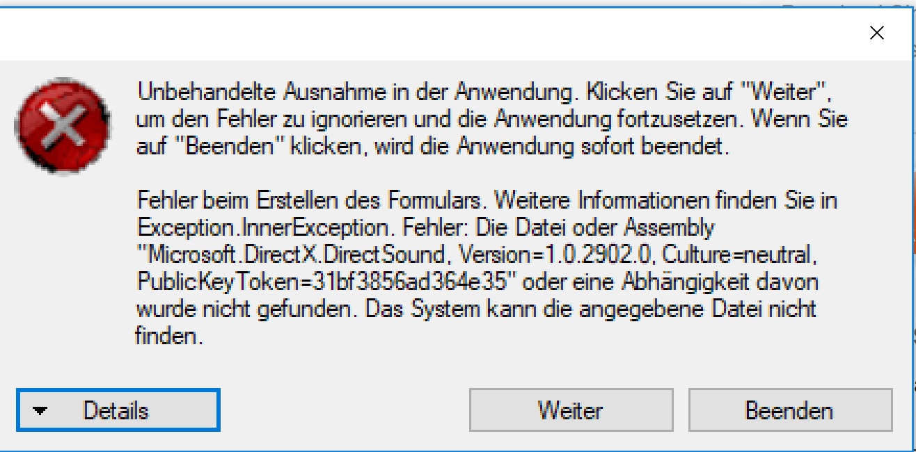

    Hello everyone!
    I hope someone can help me out.
    I have a fresh installed Win10 system and has also installed Simtools and GameVibe.
    Simtools is running fine wihout issues.
    But when i start Gamevibe i get an error.
    I have one onboard audio soundcard (buttkicker connected) and one soundcard is running through HDMI.
    Picture of the error message is attached.
    Thanks for help
    Rene

  17. Rene Leitinger

    Hello yobuddy!
    Thank you for your fast reply.
    Downloaded the Direct X Runtime from your link.
    But at the end at the Setup i got a message that i already have the newest Direct X , so setup didnt install anything.
    When i want to start Gamevibe i got the error message again.
    I dont know whats wrong.
    Thank you for your help!
    Nice Greetz
    Rene
  18. yobuddy
    51,780Coins
    +5,206 / 19 / -0
    You don't have Microsoft DirectX DirectSound 9.0c available.
    Allot of times it gets installed with a game, so you barley know it's missing.

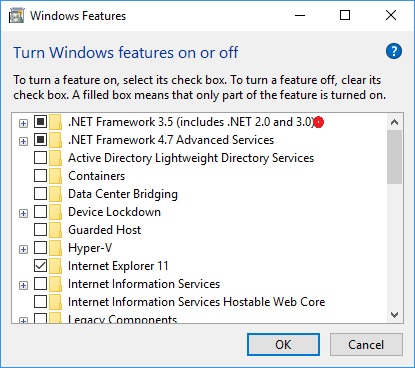

    Since your on win10, you could check that you have .net 3.5 and below enabled on your machine.

    Hello!
    I have checked and net 3.5 and below is enabled on my machine.
    Im surely not the only user with GameVibe on Win10...
    Thanks for help
    Nice Greetz
    Rene
