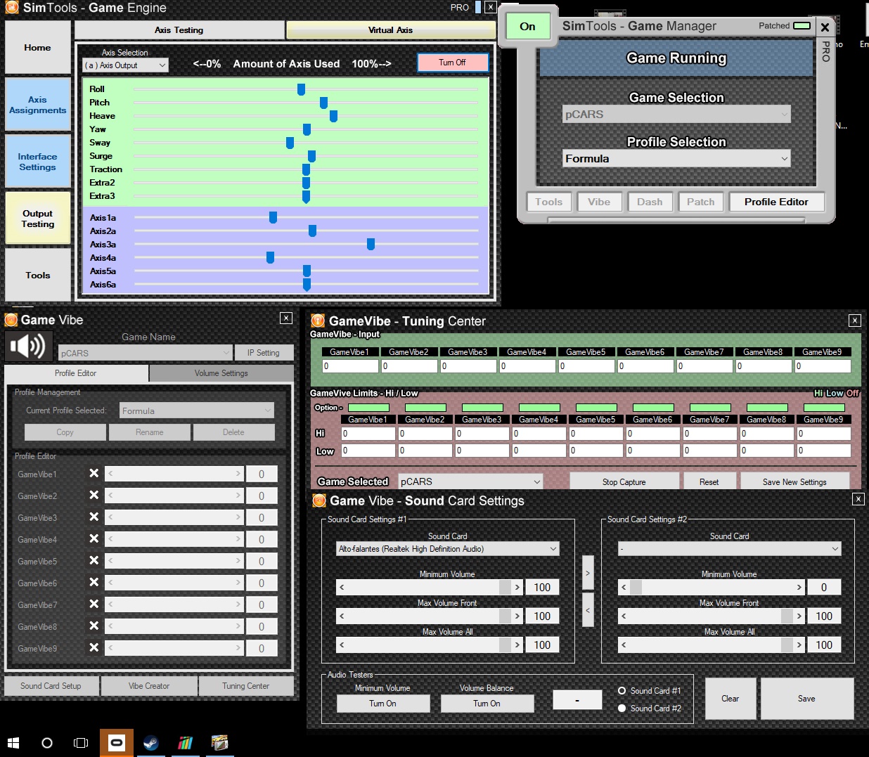

  3. Mu-KwangKim
    Mar 14, 2012
    124
    South, Korea
    - 689Coins
    +33 / 0 / -0
    Single Sound Card to the game sound with only two Front Speakers.
    And apply the Rear channel used GameVibe.
    Which causes noise in the Front Speaker.
    so, added sub sound card.
    Sub Sound card used GameVibe is Good.
    Do I need to plug two added sound cards to use 8 channels?
  4. yobuddy
    51,778Coins
    +5,206 / 19 / -0
    Yes, you need 2x sound cards for 8 channels.
    4 per card.
    Take care,

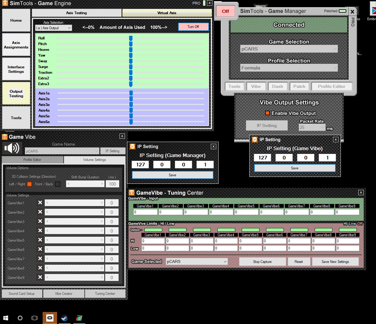

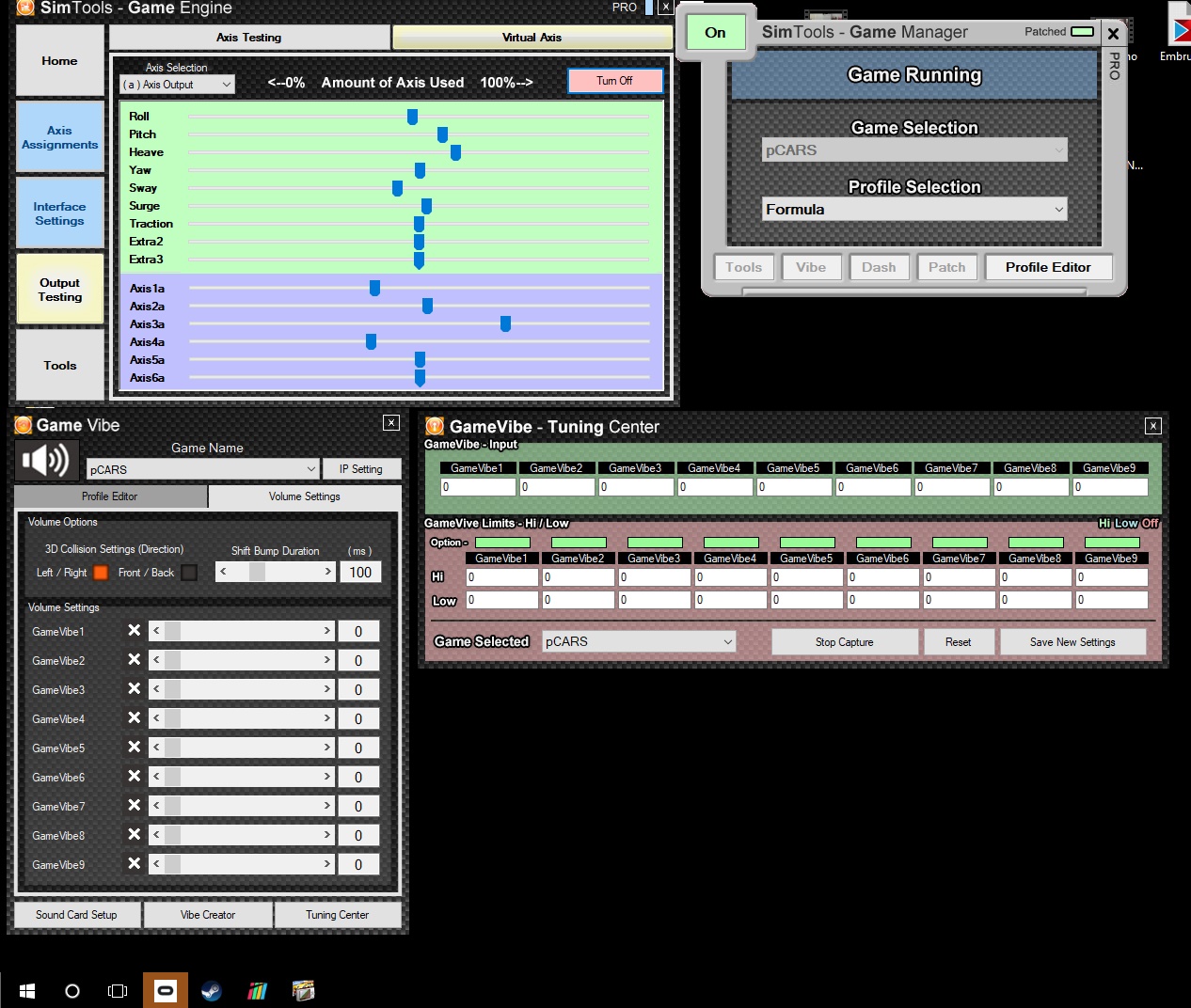

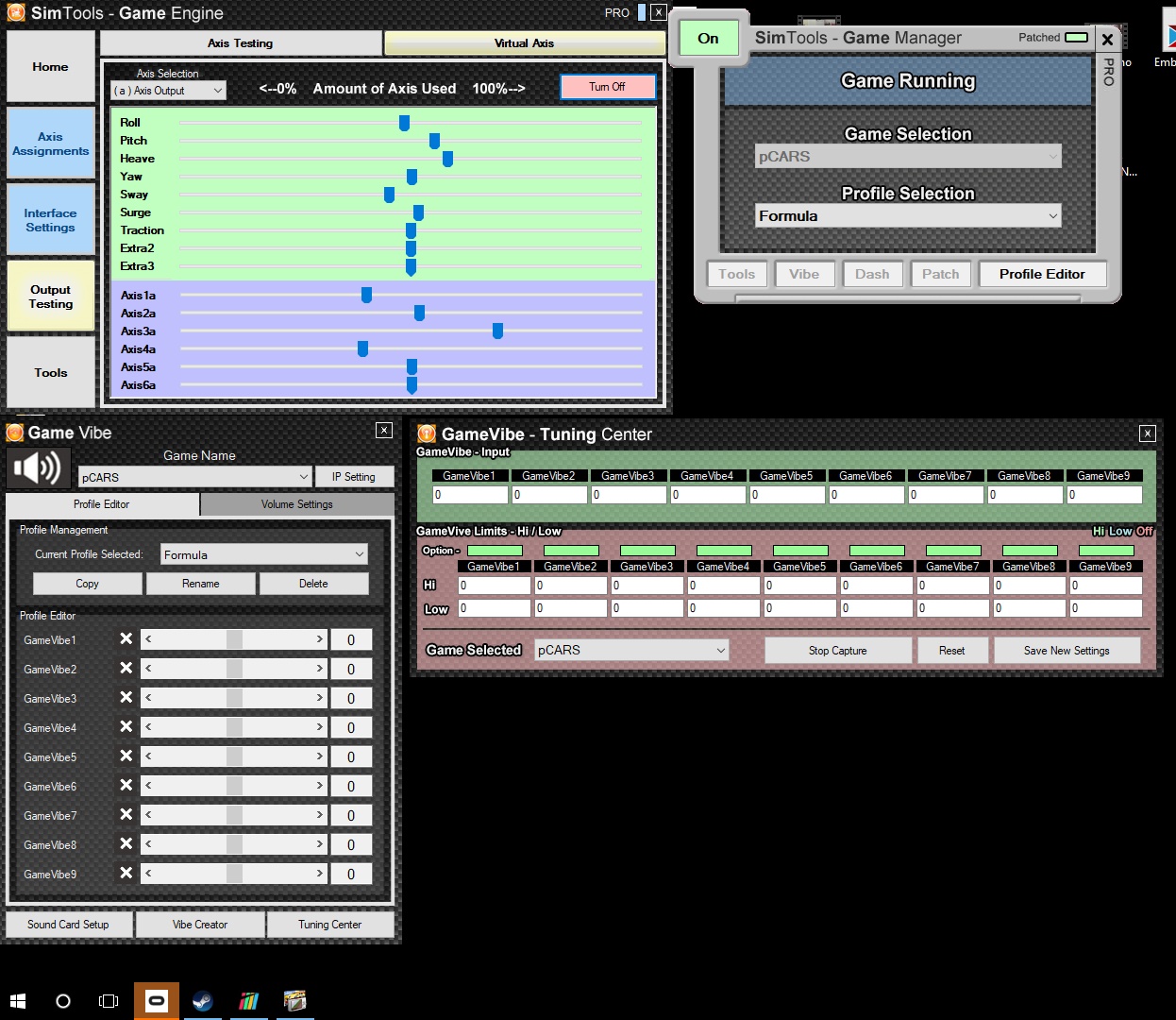

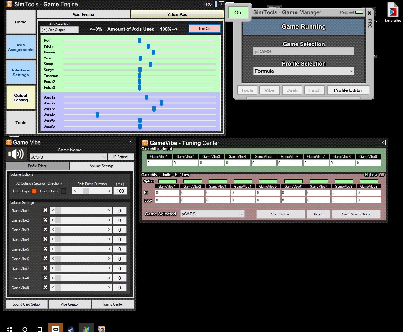

  5. Leandro Kemp
    Leandro Kemp Active Member Gold Contributor
    Oct 14, 2015
    161
    Brasil
    - 10Coins
    +34 / 0 / -0
    Hi.
    Since launching Game Vibe I have not been able to make it work.
    I uninstalled everything, erased all the files and did a clean installation.
    1. Configure the IP of Game Vibe and Game Manager and enable Game Vibe in Game Manager. I do not know if the IP is correct. 00.jpg
    2. In Sound Card Settings I chose the output and when I click on Volume Balance I hear the sound normally. 01.jpg
    3. In the Tunning Center there are no max and min values and in the game vibe there are no sonos and no option to change the volume. Only GameVibe1, 2, 3, .. 02.jpg and 03.jpg
    4. Virtual Axis working normally, but game vibe does not work in the game. 04.jpg
    Can anyone help me with some step by step?
    Am I doing something wrong?
    Tank You.

  6. yobuddy
    51,778Coins
    +5,206 / 19 / -0
    Are you using a GameVibe supported plugin?
    What version of the plugin are you using, got a link?
    No matter which plugin you use, you'll need to configure your Hi / Low values for the game.
    Or at least configure one input so you get some vibrations.

  8. Leandro Kemp
    Oct 14, 2015
    161
    Brasil
    - 10Coins
    +34 / 0 / -0
    Plugin compatible. Last version.
    How do I put a value?
    It would be cool a step by step on video.
