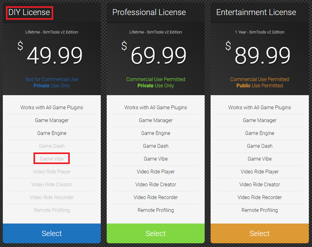

  5. ilbiga
    ilbiga Active Member
    Apr 4, 2014
    233
    Network Engineer
    103Coins
    +139 / 0 / -0
    Goodmorning everyone! I almost finished adding two bodyshakers to my Sim and I was wondering: is there a chance to get the "GameVibe" feature with the DIY license? Or is a Professional license also required using the built-in LFS Plug-in in SimTools 2.2.5? Thank you all! :thumbs
    22,230
    154,849Coins
    +11,228 / 57 / -2
    Game Vibe and other extension modules are all under the Pro license and can't be used with the DIY license.

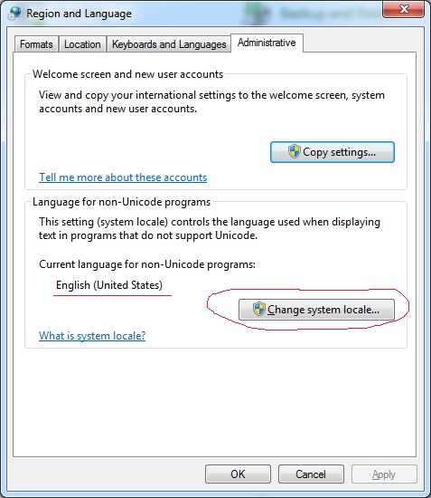

    Have little trouble with game vibe - got vibrations working perfect in vibe creator, but when i launch AC the vibrations works fine only for few second, then all the game vibe get stuck, with vibrations stuck also.
    I got also that " modal popup window GameVibe5" like was mentioned here already..
    AC Plugin and Simtools updated and up to date.
    Could it be non-english windows language..?

  9. yobuddy
    51,778Coins
    +5,206 / 19 / -0
    Yes I believe so, but even installing in another language on a PC in the shop, I still can not get it to mess up. :oops:
    Pretty frustrating, but if you change the system local, I bet it will work fine.
    Let me know buddy!

    Unfortunately changing language version did not work out for me. Still the same - in pits the car vibrates perfect according to RPM, but once i leave pits the the game vibe crash.
    However i have one change - don´t have gamevibe5 poping up, not this guy showed up:D
    Edit: Tried Racerrom also, same trouble except i have MANY GameVibe6 popups, combined with GameVibe 3,4,5..:(
    Edit2: In AC i have always vibe working when ci start the race and car is stationary at pit. Rpm´s works perfect. However when i move the car the vibe crash immediatelly with GameVibeX popups...
    Tried different ways of launching Vibe / first vibe, then simtools, then game, reverse order, first game then vibe etc, run as admin etc no help:( caught it on video...:

    Good news i got it working. It was necessary to change "unicode" settings AND overall "Language Format" to US-ENG..:)
