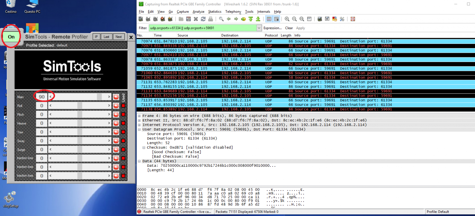

    Ciao @Blame73
    This morning I installed the Professional License of SimTools and I had this same problem.
    The thing is rather strange indeed. Sniffing the data traffic (see below), we can see clients and servers communicating correctly, but the anomaly is concrete.
    If you insert appropriate exceptions on the firewall policies of both PCs, the problem is partly solved; the Remote Profiler PC displays the "ON" status and the values assigned to the axes and to the Main Level are correctly read from the Remote Server (PC running SimTools 2.2.5), but it is not displayed which is the active profile and the image of the associated game ... very strange :confused:.
    I hope I've been helpful to someone :)
    I keep studying the thing ... :!
    @yobuddy : Any idea? Are the UDP ports used only 59691 and 61334, or did I miss something?

  17. yobuddy
    51,764Coins
    +5,206 / 19 / -0
    I'll take a look guys.
    Have you set the correct IP address in the Remote Profiler app?
    There should not be any firewall settings needed if the connection is all on the internal network.
    All of the problems you listed are caused by the remote profiler not receiving data from Game Manger.
    I'll check over the ports also, because I'm pretty sure the ones you listed are not the ones assigned to the apps.

  18. ilbiga
    ilbiga Active Member
    Apr 4, 2014
    233
    Network Engineer
    103Coins
    +139 / 0 / -0
    Ciao @yobuddy. The ip adresses are correctly configured (the wireshark trace show correct interaction), but not All data are correctly exchamged (axis data are now ok, but not show the loaded profile and game picture... very strange).
    As an upgrade, In my opinion was intresting to integrate the “virtual axis” section in “Remote Profiler”. We can see and correct in real-time the data output from the game and tuning the Rig with Remote Profiler.
