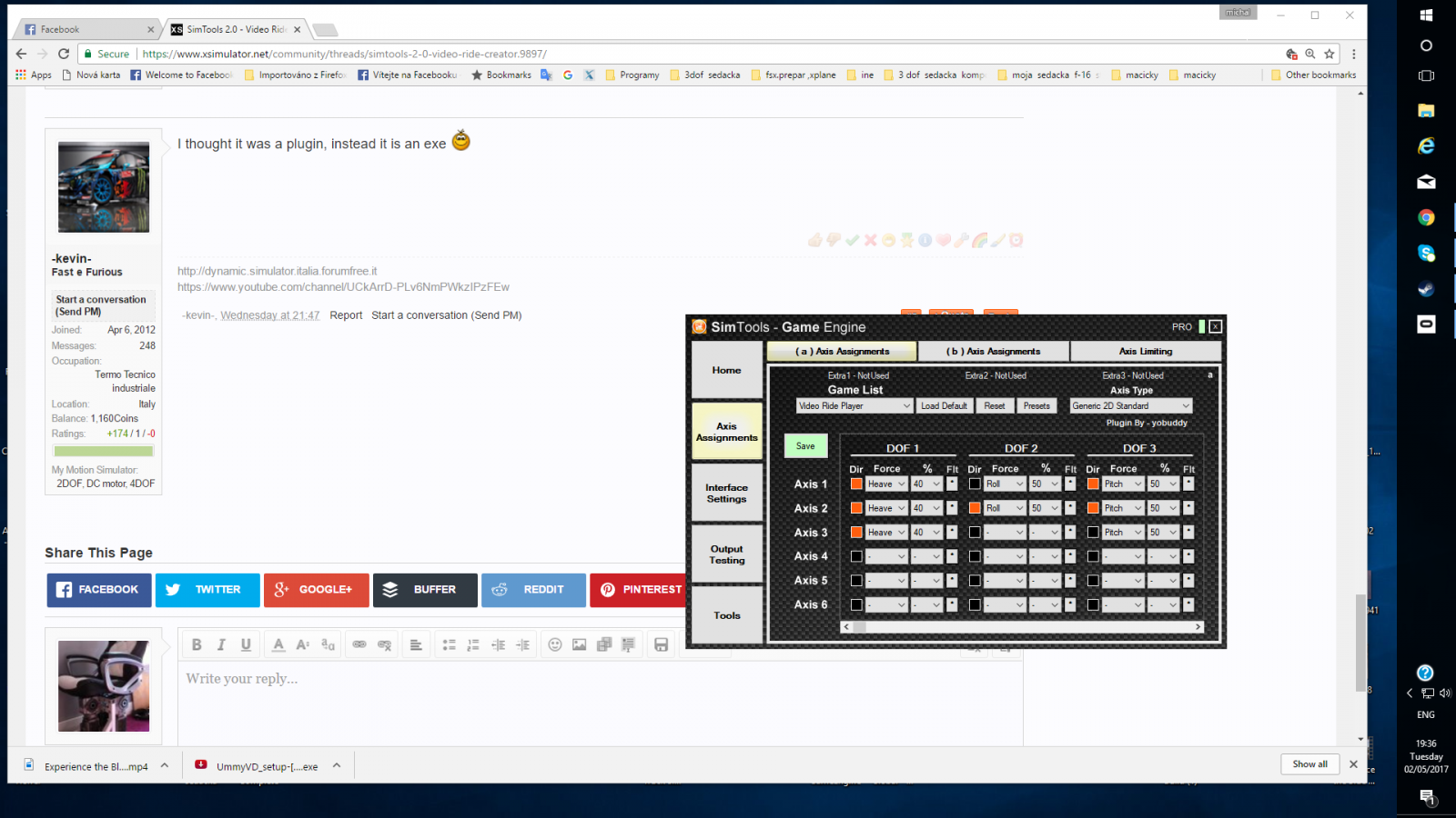

  6. misoswan
    misoswan Active Member
    Jun 27, 2014
    291
    1,032Coins
    +77 / 1 / -0
    3DOF, Arduino, JRK
    hello
    I did everything according to the instructions.. simtools game engine . after play video not blue icon....why?
    thanks
  7. yobuddy
    5,399
    50,607Coins
    +5,159 / 19 / -0
    @misoswan,
    Did you patch the "game" with game manger buddy?
    (Essentially turning the output on for the Video Ride Player)
  8. misoswan
    Jun 27, 2014
    291
    1,032Coins
    +77 / 1 / -0
    3DOF, Arduino, JRK
    hello
    I did patch ....
    Essentially turning the output on for the Video Ride Player ...(What do you think?)
    thanks
  9. yobuddy
    5,399
    50,607Coins
    +5,159 / 19 / -0
    @misoswan,
    Can I see a screenshot of Game Manger's GUI with the Video ride player running also buddy?
  10. misoswan
    Jun 27, 2014
    291
    1,032Coins
    +77 / 1 / -0
    3DOF, Arduino, JRK
    hello
    yobuddy ....My mistake forgot plugins lol
    Now it's okay.
    sorry my stolen you time...
    thanks
    Michal

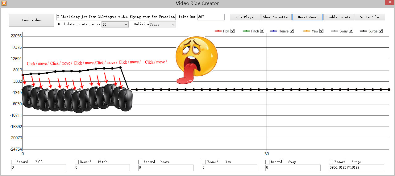

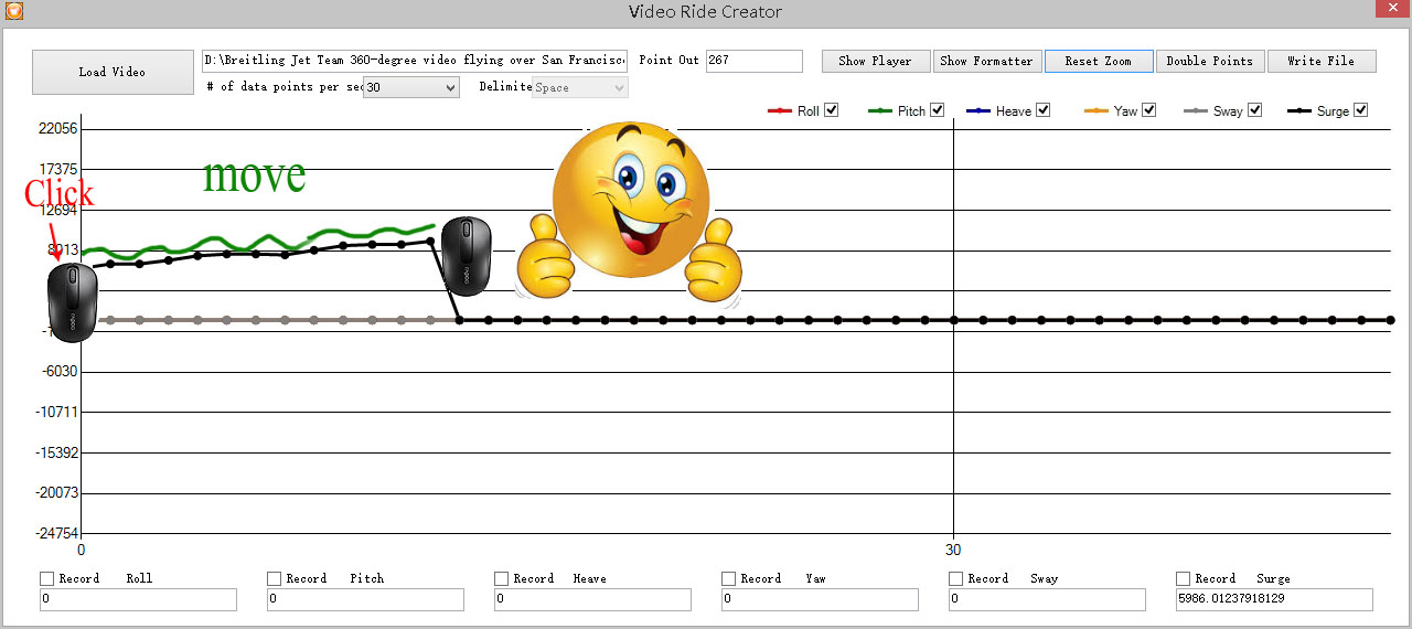

  11. fzxj520
    fzxj520 Active Member
    May 14, 2015
    176
    1,341Coins
    +90 / 1 / -0
    Thank you very much for your tools
    I do not know if the way to create motion data is correct, (click / move / click / move / ...) this way is very inefficient?
    If the black spots can be sucked to the mouse to move the trajectory, (or play the video, real-time cue mouse movement) motion data creation will be very convenient? 2.JPG
    Perhaps the use of key point curve editing method?
  12. yobuddy
    5,399
    50,607Coins
    +5,159 / 19 / -0
    @fzxj520 ,
    I agree the current setup is better suited to re-format an existing ride film for SimTools than create them from scratch.
    But you can sort of do what you want when making a telemetry file from scratch.
    Instead of using 30 data points per second, use 2 or 4 when creating the telemetry file.
    Then simply use the 'double points' buttons to add more points once complete.
