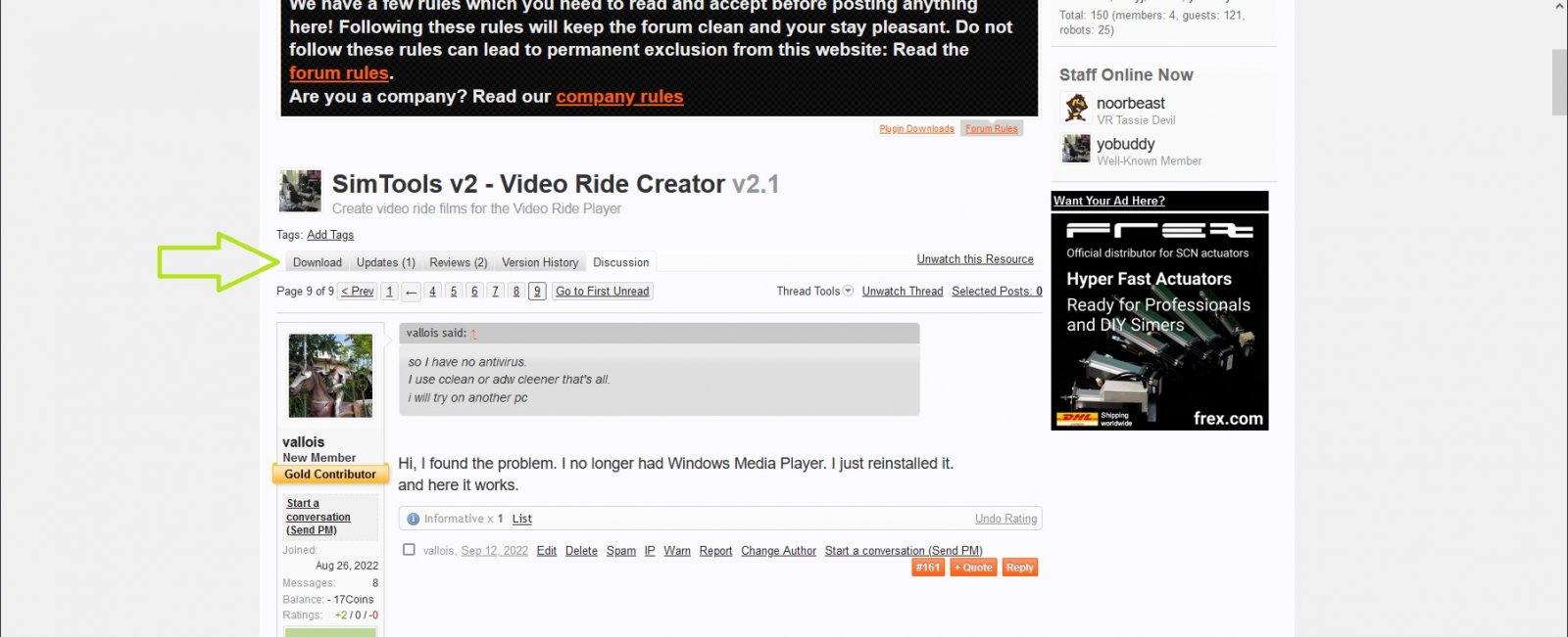

    Hi, I found the problem. I no longer had Windows Media Player. I just reinstalled it.
    and here it works.

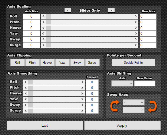

    Hello guys, one more question :
    0.3726527,4.4718328,8.901412,-0.52251667,-0.40772638,0.16505578
    -0.4118793,3.2165813,8.788253,-0.52251667,-0.40772638,0.16505578
    -0.3726527,2.1966896,8.411079,-0.76850337,-0.5991017,-0.0019373155

    here is an example of the data I send to Simtools, I have not understood the way I can scale them to get bigger movement.

    Axis scaling is under the tools button.

    hey,
    I am not good at scaling the values.
    For example I can't get a max and min value
    an other thing, is it necessary to provide my platform with so many at per second, it's like it has no time to reach the first goal , another one is coming already , the result seems to be a very jerky movement, I was looking for something smooth with long slow movements like on a longboard when you ride a 1 meter soft wave
