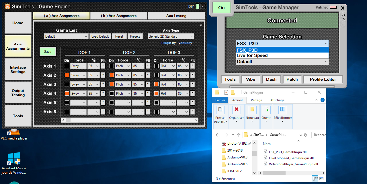

    I'm encountring lots of problems with the video ride player and creator.
    First of all : I have video ride player installed on my computer. I have simtools correctly installed and my DIY licence activated. I hav drag and drop the vidéo ride player plugin on the plugin manager. But, I can't see the vidéo ride player in the game manager. What's happen???
    secondly, I have generate a telemetry file with an arduino and MPU 6050 (I'll post the howto later, when my project will be finnished) but i don't understand how to import it in a video with video ride creator...
    Could you help me please?
  16. SeatTime
    2,572
    +2,854 / 40 / -0
    The DIY licence does not cover Video Ride Player etc. See https://simtools.us/license/ for what each license covers.
