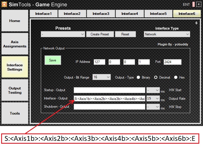

    Hello
    I would like to ask if the settings shown in the 2 attached pictures must be done in order for the Recorder to work?
    Because I don't have a Network interface in Simtools Game Engine.
    (I have a SimTools Professional License)
  4. yobuddy
    51,618Coins
    +5,204 / 19 / -0
    Yes, it needs to be setup to work correctly.
    Take care!

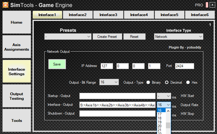

    Hello
    Thanks for the reply.
    Could you tell me why the "Network" option disappeared from the interface list after purchasing the license?
    (There was also Network before purchase.)
  6. yobuddy
    51,618Coins
    +5,204 / 19 / -0
    The Network interface in SimTools v2 is built in, and should just need to be selected and setup.
    With SimTools v3, you will need to install the interface plugin from the plugin manager.
    Hope this helps buddy!
  7. Nagy Csaba
    Nagy Csaba New Member
    Mar 8, 2024
    18Coins
    3DOF, DC motor, SimforceGT, Motion platform, 6DOF
    Reinstallation solved the problem. Thanks for the help!

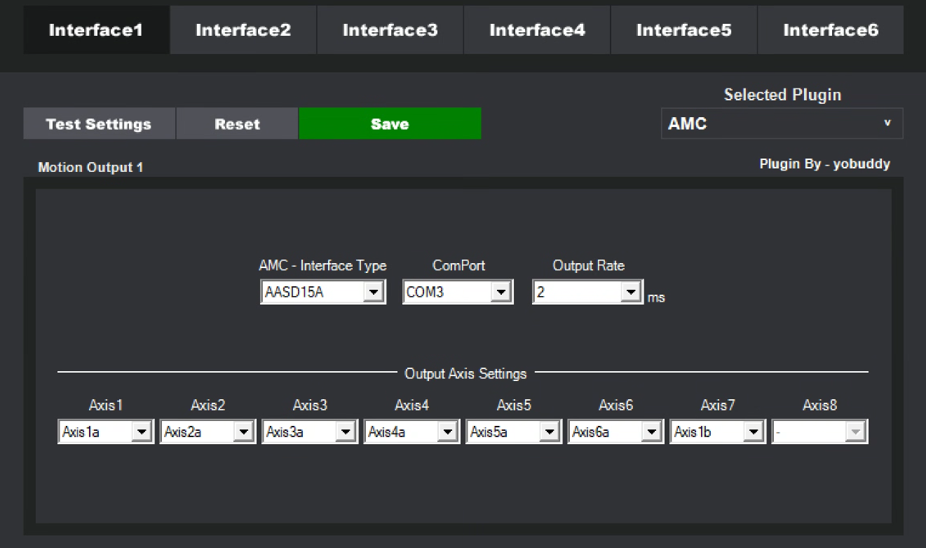

    I attempted it today without success. I see this screen shot about how to configure it, but my system uses a different kind of controller. Is that what might be stopping it?
  12. yobuddy
    51,618Coins
    +5,204 / 19 / -0
    You need to setup the network interface in SimTools, as it sends the data to the recorder app, not the sim.
    You can simply add the network plugin as Interface #2 if your normal interface for you sim uses interface #1.
    Hope that makes sense buddy?
  13. peter stolmeier
    peter stolmeier Member
    Sep 29, 2020
    97
    570Coins
    +55 / 0 / -0
    Yeah, i was able to add the network interface as 2 but the recorder still doesn't' see any telem.
    I'm wondering if I have the ip address right. the example says 172.0.0.1 but shouldn't it be 192.168.ect ect? Same question for the port.

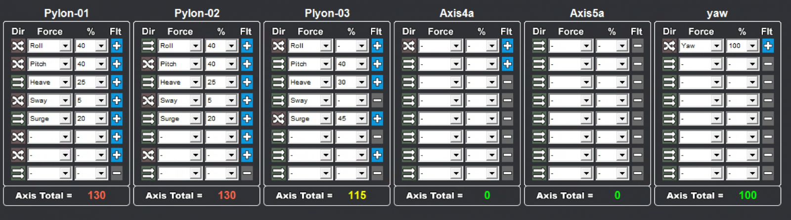

    I also wonder about the interface output. I have a three pylon system so I named them for ease. Should I change what's in output?
    I tried renaming them back to Axis1a / Axis1b but no data yet.
    I know I'm close, this is going to be one of those "oooh duh" things.
