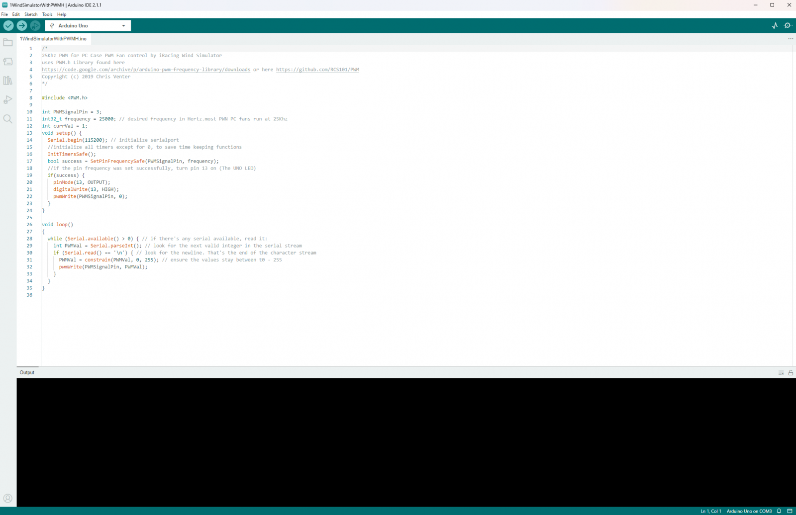

    Hello, I fired the motorshield v2, just remains the arduino with this sketch

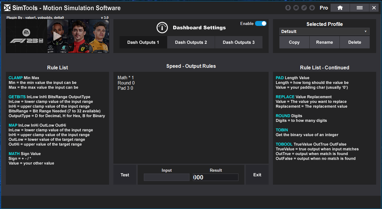

    Ok. Here we go:
    I just put
    Map 0 100 0 255
    Pad 3 0
    And it works. BUT
    Sounds like crazy fans.
    Not a regular 0-370 km/h ( f1 2023 ).
    Speeds increases so fast, on my wheel still at 80 km/h and simtools reach 200.
    I try to change numbers ( 0 150 0 300 ) etc but still so fast.
    I need to understand why it's like this, the old method using math round pad worked just fine (and still does) in v2.6.
    See:
    EDIT: ok, now i understand how it works. if i want a gradual speed from zero to maximum i have to simply put the same values on the lines !! that is, MAP 0 340 0 340 and below the PAD 3 0 to say how long the value should be and then it worked perfectly !!

    just put maximum speed of the car you are using, or approximate. but it has to be exactly the same as the input and output. this actually sets the fan speed equal to the object you chose to use. follow the EUREKA video

    Most of the fan sketches top out at 255 for input to be at 100% fan speed.
    So "Map 0 X 0 255" where x can be anything you want as top speed may work best.
    So, from your video clip
    Map 0 300 0 255
    Pad 3 0
    This will work the same I believe, as the sketches drop any input value over 255.
    Hope it helps,

    From what I tested, the only way to reach the maximum speed proportional to the speed of the fans, was to set the 2 equal values. for example I put 0 255 0 300 and the fans went crazy. accelerates and stops all the time, and when I brake the wind continues. same thing for any non-repeating value ( 0 200 0 200, 0 300 0 300, etc ). if I put 255 at the end, when I accelerate the fans jump from 0 to 100 in less than 1 second, like in the first video I posted.

    All map does thou is clamp the input between the first 2 numbers, and then scale the input to the second 2 numbers. Since the sketch does not allow numbers above 255, sending anything over that will be canceled out is all.
    Code:
    if (Speed > 255)
    Speed = 255;
    Please try these 3 commands:
    Math * 2.5 (the bigger the number the faster it will top out, * 2.5 should top out at around 100 mpg)
    Clamp 0 255 (keep it in range)
    Pad 3 0 (pad to 3 chars)
    Should do the same thing I believe.

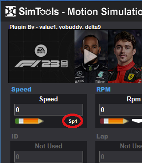

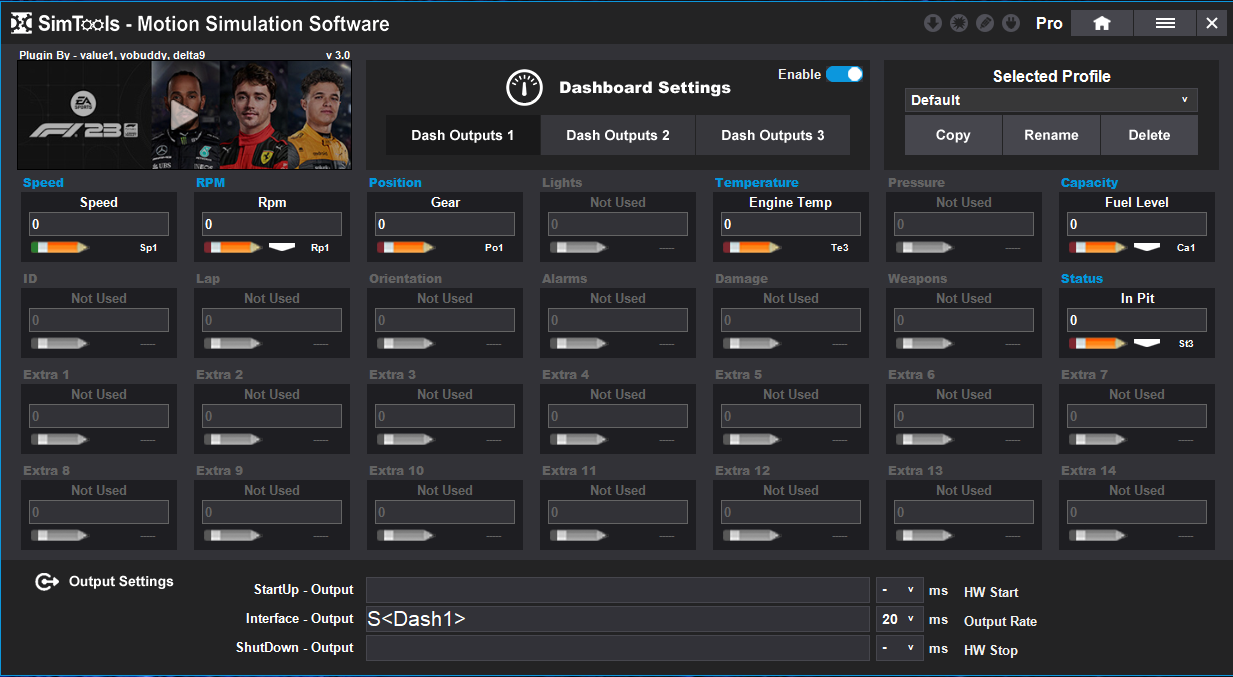

    @offman,
    Instead of 'S<Dash1>' for interface output, give S<Sp1> a try.
    I get that value from here

    eeeeeeeeeeeh yes!!!! finally, after a relentless struggle, my windsim is finally working!!! Thank you all for helping me! Thank you yobuddy!!!!!

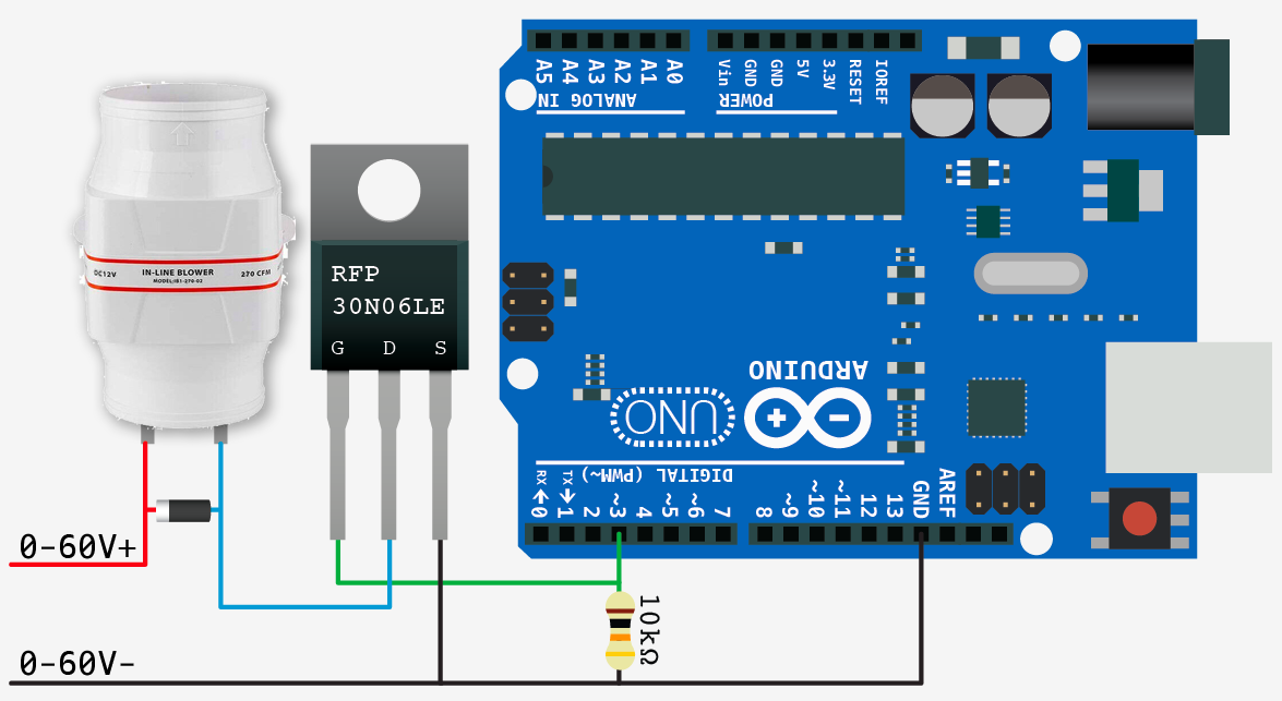

    is there a replacement for the rfp30n06le it is very hard to find online (at least in The Netherlands) would this work
    RL 530N or
    IRFZ44VPBF ?
  16. yobuddy
    51,754Coins
    +5,206 / 19 / -0
    Any N-Channel mosfet should work I believe (being it can handle the power required by the fan).
