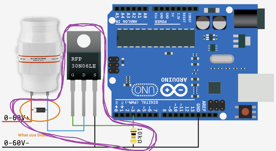

  5. Howard Yang
    Howard Yang New Member Gold Contributor
    May 5, 2016
    13
    West Covina, CA
    - 138Coins

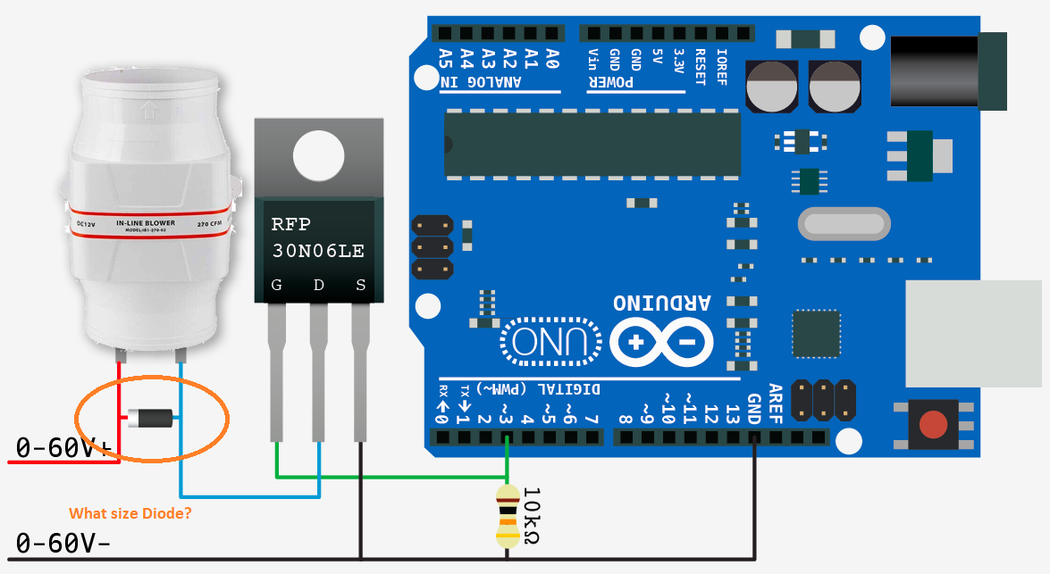

    What size diode do I need to installed in between the motors if running the 12V 6A 270CFM inline Fan? I circled that in Orange
  6. yobuddy
    51,533Coins
    +5,204 / 19 / -0
    Probably depends on the size of fans you want to use, but I can't see a fan outputting that much reverse power when the power goes off.
    Here is a link to the article the pic came from.
    http://adam-meyer.com/arduino/rfp30n06le-arduino
    "We will need a diode fast enough to react to the kickback, and strong enough to take the load. A rectifier diode like the 1N4001 or SB560 should do the job."
    Take care!
  7. Howard Yang
    May 5, 2016
    13
    West Covina, CA
    - 138Coins
    thank you. And if I use a bigger fan then 2A, say the 6A fan bilge inline fan that you’re using in the video, which motor control board would you recommend and do you happen to have a wiring diagram?
  8. yobuddy
    51,533Coins
    +5,204 / 19 / -0
    You would simply make this circuit two times, one for each fan buddy.
  9. Howard Yang
    May 5, 2016
    13
    West Covina, CA
    - 138Coins
    Would the fan connect direct to the Arduino board without a motor control board?
  10. yobuddy
    51,533Coins
    +5,204 / 19 / -0
    The circuit is your 'motor control board' if you will.

    Hello, forgive my ignorance, I have connected it as shown in the diagram... I understand that the 12V goes directly to the fan and with the diagram... I have configured the Arduino and on pin 9 but the fan is always on when I supply it with 12V... shouldn't it be stopped?
  16. yobuddy
    51,533Coins
    +5,204 / 19 / -0
    What does your output settings look like?

  18. Josemanuelrm
    Josemanuelrm New Member
    Jan 18, 2025
    11
    valencia
    65Coins
    I already have it working, but the connection diagram was incorrect.

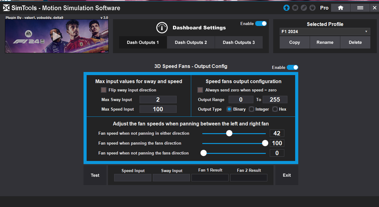

  19. squirrel_captain
    squirrel_captain New Member
    Jul 4, 2025
    12Coins
    DC motor, Arduino, 4DOF
    Hello everyone,
    For awhile now ive been trying to get the Speed fans running, ive used various sketches and serial debugging tools, but i can't seem to get Serial based fans working at all. Running via UDP I got it running with a R4 Wifi, but via serial with an R3 no luck what so ever.
    It's not Fan wiring side of the house (that's all grand) i can't seem to get any output from SimTools V3 for the speed fans, where as my Motion Simulator platform is perfect from hardware side (using R3's for them aswell)
    Ive quadruple checked my Dash Interface settings (Port, Baud etc), and tested an entire bunch of output interface settings with corresponding sketches (most from here, but also debugging ones ive created).
    Regardless if i use `S<Sf1><Sf2>` or `S<Sp1><Sp1>` or `S<Sp1>` or even `S255` i don't seem to get any communication with the R3 whatsoever.
    I was debugging with Serial Port monitor initially, however the time period expired, so now switching to new tools to attempt to see the data output.
    I'm sure there's a potential chance I've missed something, or the R3 is broken (also plausible) so im checking in here to see if anyone has any ideas or checklists to follow to rule anything else out.
  20. squirrel_captain
    Jul 4, 2025
    12Coins
    Reinstalled SimTools, cleared all the previous settings, debugged with com0com to a virtual pair, then also used the virtual interface, and like magic it worked the first go. Not sure if it was a Windows port issue or a weird lock on the serial port, but it works!
