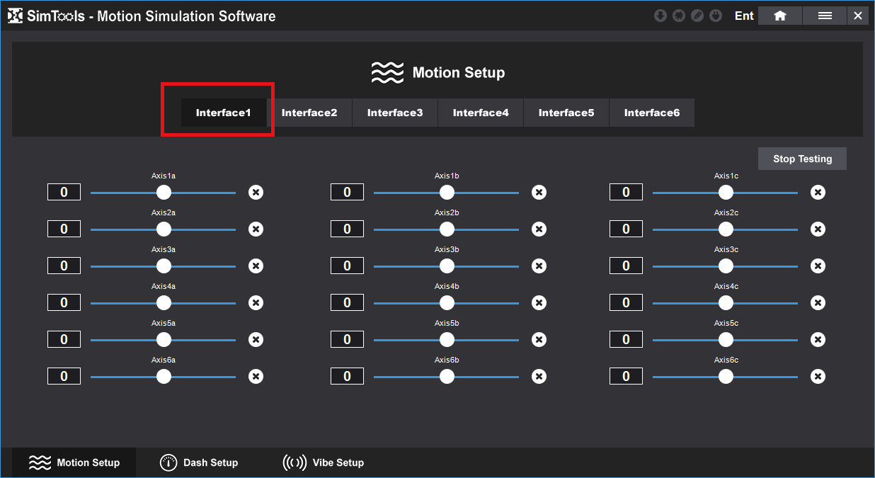

    Hi @yobuddy,
    I've just noticed the JRK interfaces won't remember the assigned axis when I close and reopen the software. it remembers the device numbers and output rates. This happens with the original axis names and the changed ones.
  2. yobuddy
    51,534Coins
    +5,204 / 19 / -0
    My instinct is to leave it as is, especially since a reinstall would be done with a setup file and a single click.
    And while there is some extra steps here, it is pretty strait forward.
    I'll keep thinking it over thou.
    The names have their own file and do not get connected to any particular profile.
    I'll take a look, all i can think is maybe I need a focus check to make sure the last typed name sticks.
    (the name sticks when the focus is removed)
    Nice catch, I'll get it fixed.
    The idea here is you can test to make sure each interface is working. My thought is if you setup interface 1 and interface 2, and then click test and something does not work, you have to wonder which one it is not working. Where this way the one not working is the interface selected.
    But it could have a page title for sure.
    Testing Interface #1 for example.
    Also, all of the interfaces startup and work together for Axis testing.
    So all we really need to know here is that we have each interface configured correctly.
    The triggers use the raw input from the game, and not a computed min max input set.
    This way it will work for any input independent of our min max settings.
    Thanks for the feedback, chat soon!

  3. yobuddy
    51,534Coins
    +5,204 / 19 / -0
    JRK Interface update pushed!
    Update the interface and then make sure your settings are correct.
    (Be sure to click save before using the interface.)
    Take care!

    I understand, I think! I'll try jump but unfortunately the JRK plugin update as well as not fixing the missing axis setting when Simtools is restarted, seems to have broken the actual output. I get no motion at all but the virtual output shows it should be working. Is it possible for you to PM me the previous JRK plugin to try again?
    When you posted the update in the repo, should it have updated my system automatically? anyway, I manually downloaded and dragged it into the home screen then I searched for the installation folder and the date stamps matched the update.
    Another thing I've noticed when going to axis settings, the Flt boxes are all red but some smoothing has been set. If I click on one and the filter screen opens it shows the settings are there. I close the screen and then any axis with a filter applied is shown as orange. Should they be orange to show that some axis have filters applied?
    Thanks.
  13. yobuddy
    51,534Coins
    +5,204 / 19 / -0
    @levers
    JRK interface updated
    I'm guessing you were using some custom axis naming?
    Forgot to update the plugin for custom names is all, I should probably check the other interface plugins for this problem also at some point.
    Yes, depending on your update settings.
    Yes, I have the plugin half re-done and got sidetracked with a custom gopro telemetry dumper test that I got working.
    Thanks for the testing buddy!
    Chat soon...
