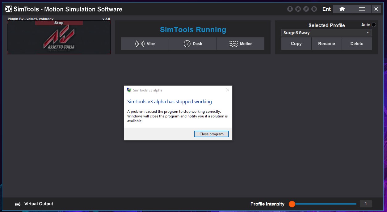

    Hi mate,
    So I've updated and simtools is crashing...
    Crashes when I click the play button before launching CM. Crashes when I click the play button while in-game...
    Happens with and without the shortcut to CM.

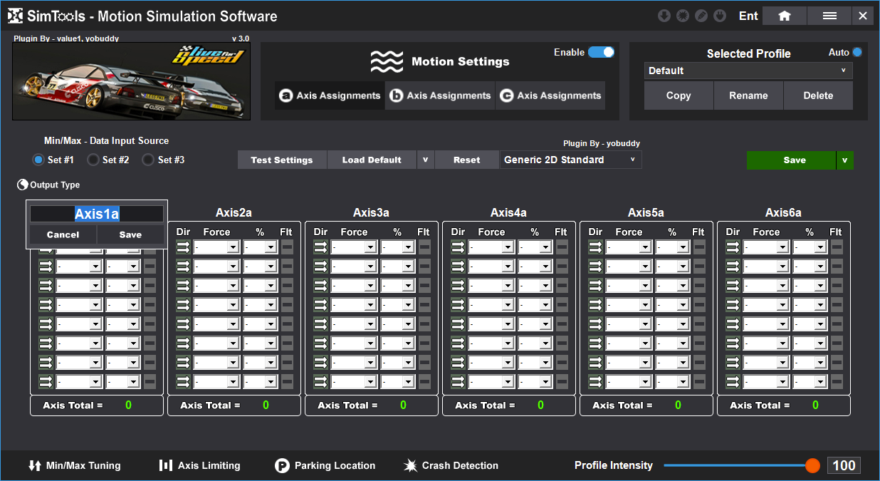

    @yobuddy
    been taking a look at profiles and there's something odd going on.
    I copied a profile and gave it a name (2DOF Surge & Sway). Simtools is making a duplicate of the profile (with spaces removed from the name) when I switch to another profile. Occured a second time when I tried with another profile (3 DOF Pitch, Roll & Heave).
  4. yobuddy
    51,704Coins
    +5,204 / 19 / -0
    Yes, illegal chars in the name, I will need to look for, and stop this.
    Could be the error for the launch also, as it may be trying to load a file with illegal chars in the name.
    I'll take a look, probably just need to remove the space when copying a profile.
    Probably an easy fix.
    I will take a look.
    Chat soon!

  5. early_m

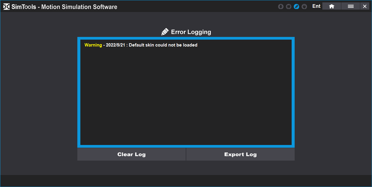

  12. sardiusxu
    sardiusxu New Member
    Jun 28, 2021
    23
    143Coins
    4DOF
    The update is successful. However, the default skin still could not be loaded.
    The game plugins of simtools v3 didnt support as many games as v2. Wish the other game plugins (such as RBR) could be released soon.
  13. yobuddy
    51,704Coins
    +5,204 / 19 / -0
    Your PC has a corrupt .net framework I'm afraid. It's why other .net apps also have problems or won't run, like SimTools v2.

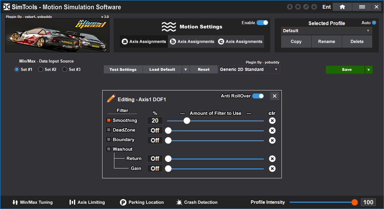

    I got notified of a new update to Simtools on launch so that works.
    I found the axis assignments show the filters as black squares now until I click on one of them then the turn red with the ones being used turning orange.

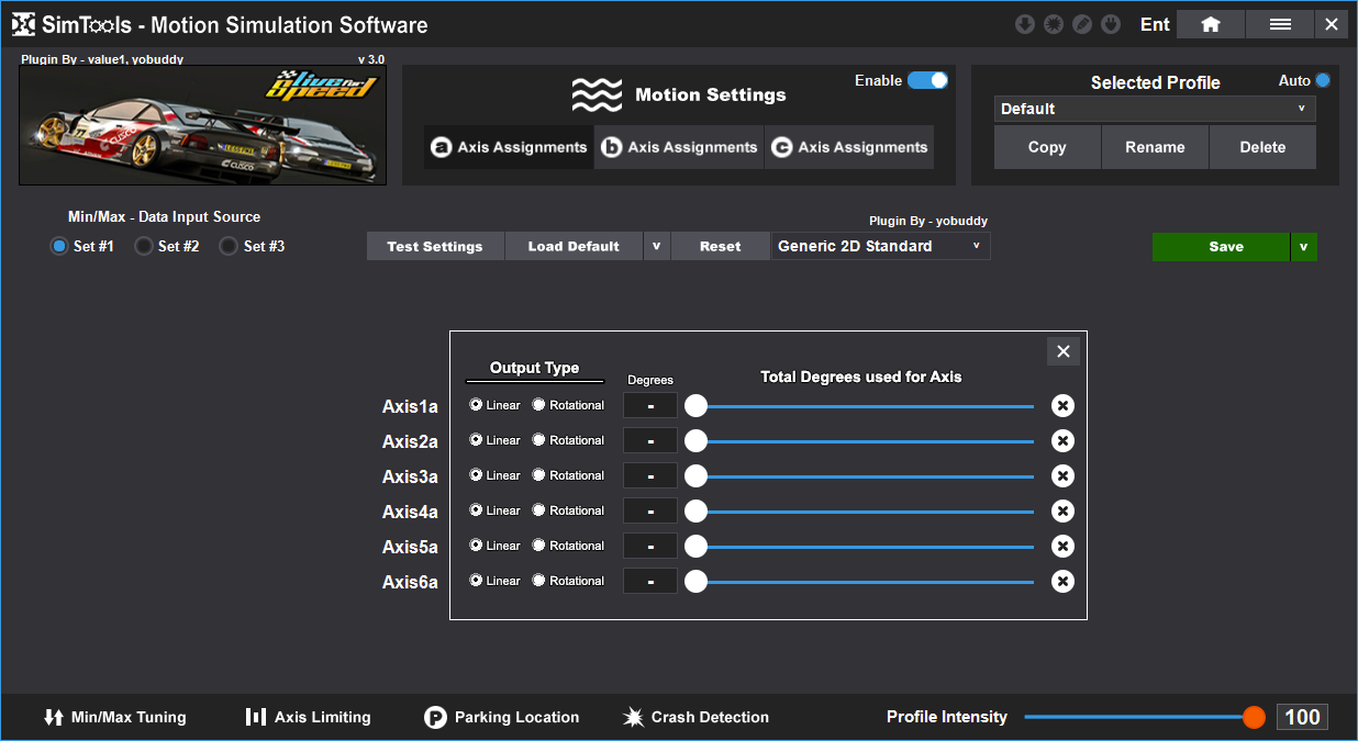

    The output testing still reverts back to 1a, 2a etc rather than the saved names.
    I've tried changing the surge min/max to 3 rather than 2 but the reduced filtering still makes it unpleasant to use.
