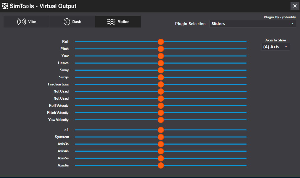

    When I open the sliders app I get this:

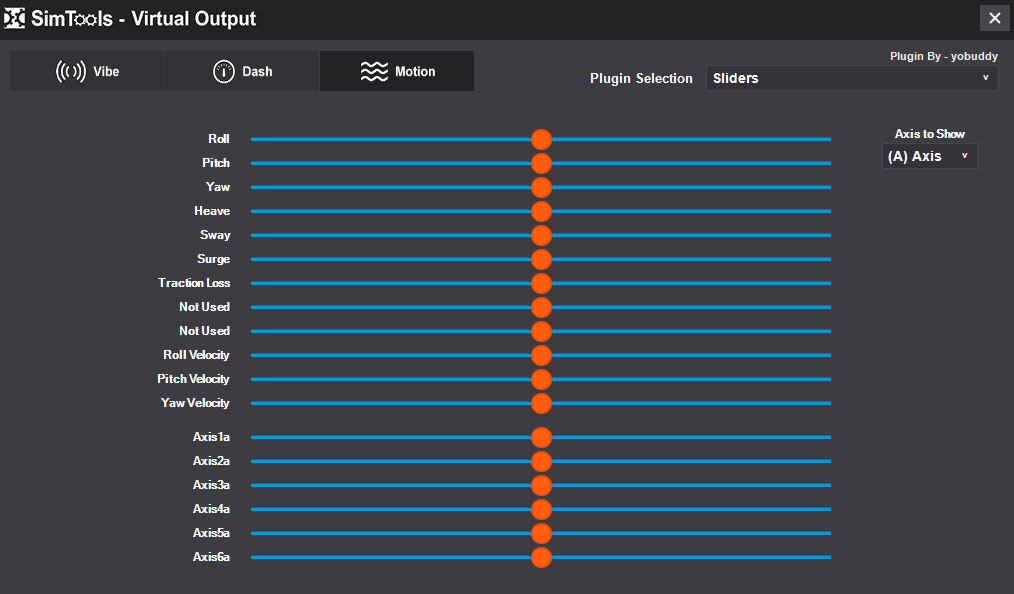

    As you can see Axis 1a and 2a are renamed to match my axis assignments. However, if I select to show (B) or (C) then go back to (A) then it reverts back to this:
  8. levers

  12. yobuddy
    51,367Coins
    +5,202 / 19 / -0
    Updated the Sliders virtual output plugin.
    Should fix the axis naming problem! :thumbs

    +42 / 1 / -0
    It's fixed. Makes it much easier to remember what's what :grin
