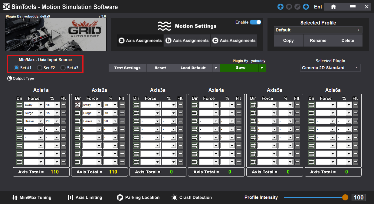

    Hi everyone,
    Forgive me if the question I am about to ask is not in the right place.
    I happen to be using several DOF (for now there are 7) and I want to use for example with different axis the same movements such as the surge, Is it possible to have several surges but that they can be configured independently?
    I hope I have explained myself correctly.
    By the way, congratulations to both the forum and the creators of Simtools, it is without a doubt a great piece of software/community forum.

    I am not sure of your physical setup or hardware but if there are separate hardware controllers then they can be setup to independently run an axis, such as surge.

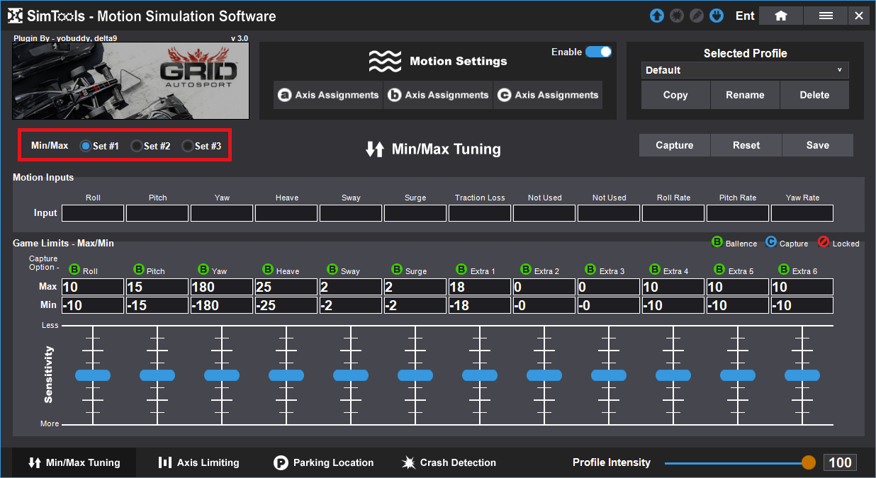

    Thank you very much for your answer, I didn't explain myself very well, sorry.
    For example, if I want to have different Max/Min surges, how can I do it? In principle, in the list there is only one surge, so the Max/Min that you put there, will be affected equally in all the surges that you have selected in the hardware without being able to modify them independently.
  5. yobuddy
    5,416
    50,830Coins
    +5,170 / 19 / -0
    You have 3 sets of max/min values, see here.
    And then in the axis assignments, you can tie to any one you want, see here.
    Hope that helps,

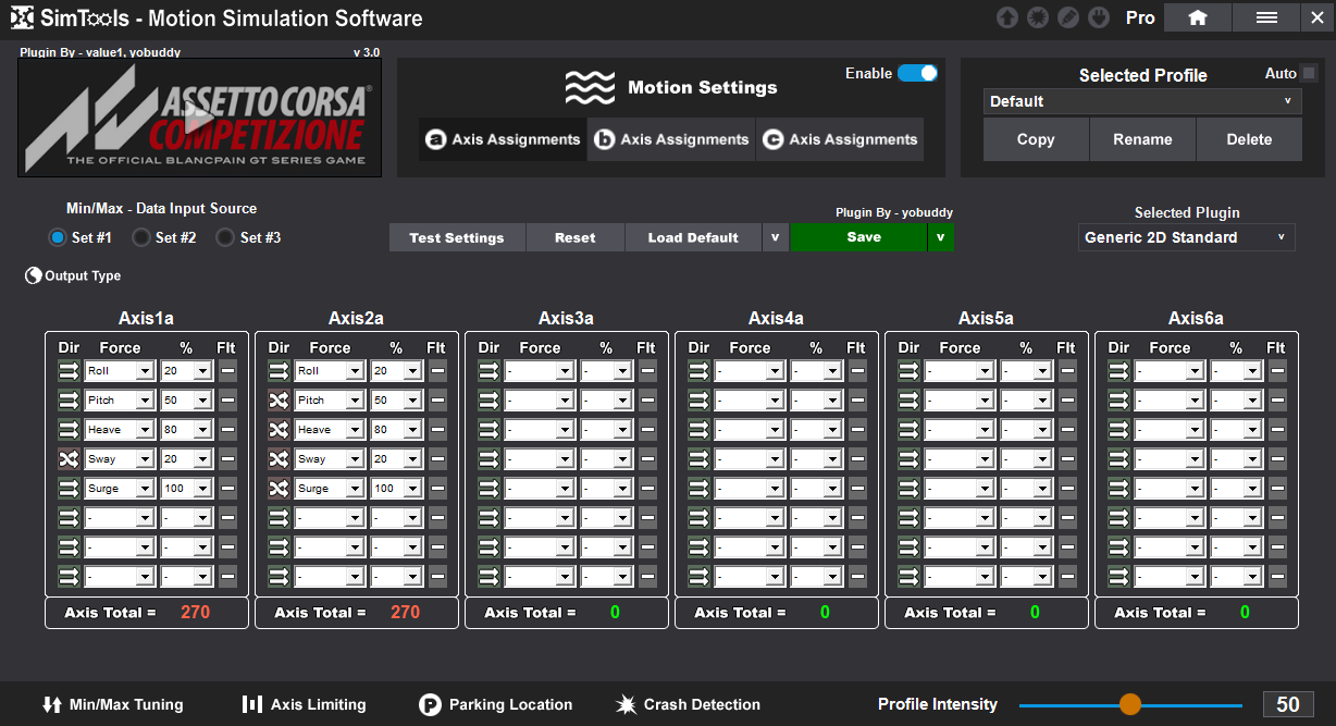

    Hello everyone,
    I have a few questions, I'm new to the whole topic and now use Simtools V3 with my 2 DOF motion rig. My problem, especially in ACC, is that when I go up a small incline, the seat always tilts forward a lot and when I only shift in 1st gear, it only goes backwards a little when I accelerate in the other gears I notice a jerk when shifting. I would be happy to attach a picture of my Axen configurations to you.
    Maybe someone can help me to solve this problems.

    first of all your axis total is 270, that's very high. Being per percentage of all the forces it should be 100 (but you can go a bit higher considering not all forces are at their maximum at the same time), let's say you can go up to 120 (but I keep it at 100)

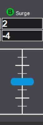

    what you're referring to (the change of gear) is normally tied to the Surge force, we normally have asymmetrical positive and negative values for Surge. You can set them under Min-Max Tuning.
    These are my values for Surge in ACC:
    EDIT: but I would first of all adjust the axis forces to go around 100 (try not to have too much pitch if you don't want to feel too much ups and downs)

    My problems are that when I press the accelerator, the seat doesn't move backwards every time I switch gears. You're supposed to be pushed into the seat like in a real car, and when I drive uphill the seat always moves forward a little. although he should actually go to the back. I now have Axis total = 100

    It sound like your Dir checkbox settings in Axis Assignments are not configured correctly, as they determine which way each axis move.

    To manual change values press Capture, edit the values, Save, then Stop
    But, as noorbeast said, you probably have to check the direction of each axis in Axis Assignments, that's the basic for having everything working correctly
