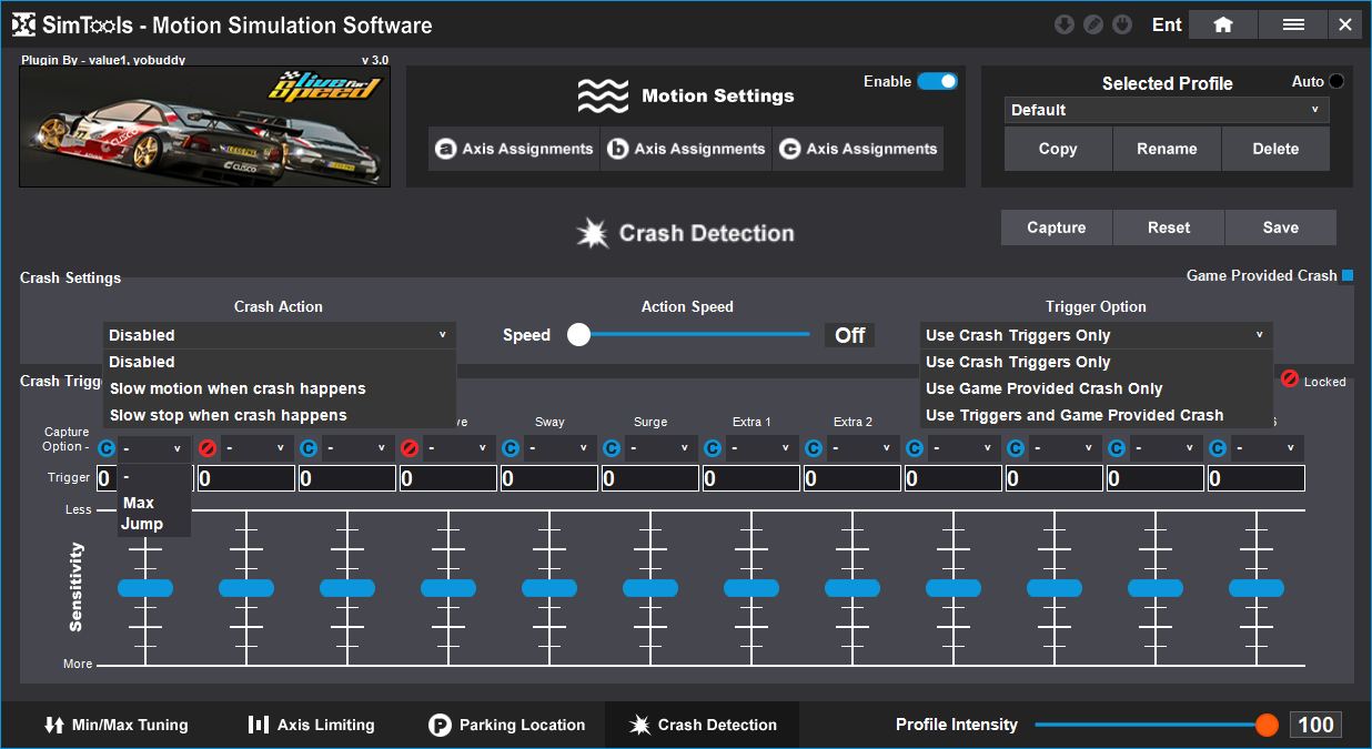

    Hi Guy's,
    Just checking in...
    I'm getting close to having the first version of crash detection up and running!
    (Just a bunch of testing and tweaking, and some final GUI changes I think.
    Once I get this running, I will alter the game plugin API and update the existing game plugins if needed.
    And then go back to working on some new plugins to add the list.
    Chat soon!

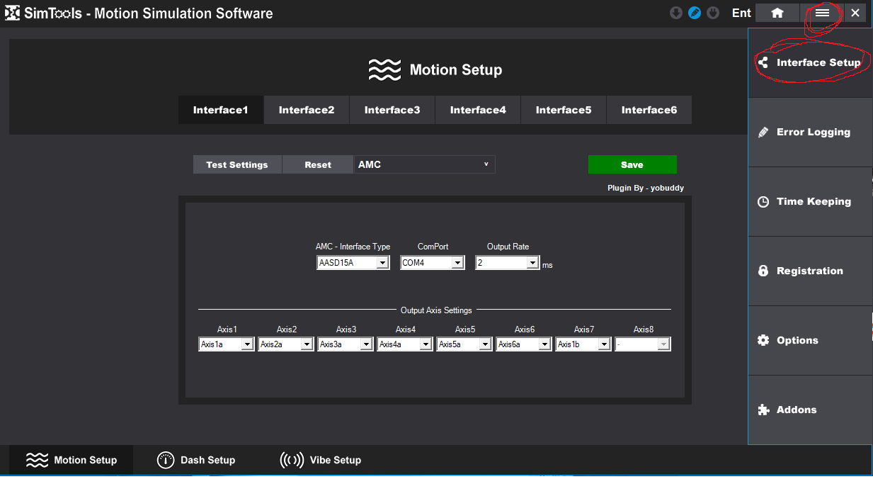

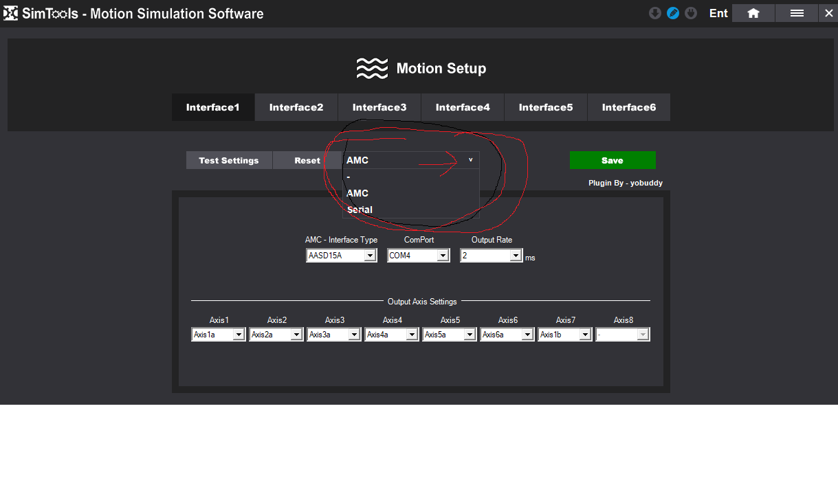

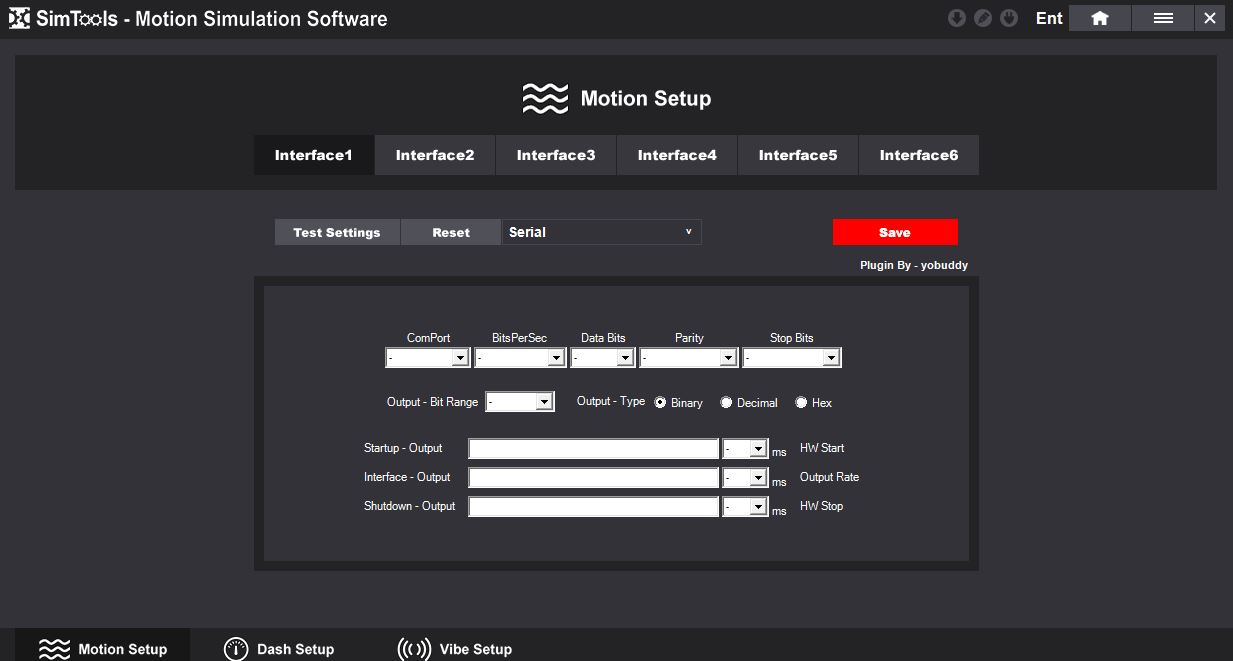

    I have installed Simtools 3
    how do i configure the smc3 interfaces / serial device ?
    is there a plugin yet for RF2 ?

    @Gadget999 im not using smc3 but my guess would be install the serial plugin and that will let you select a com port for motion, no RF2 plugin yet

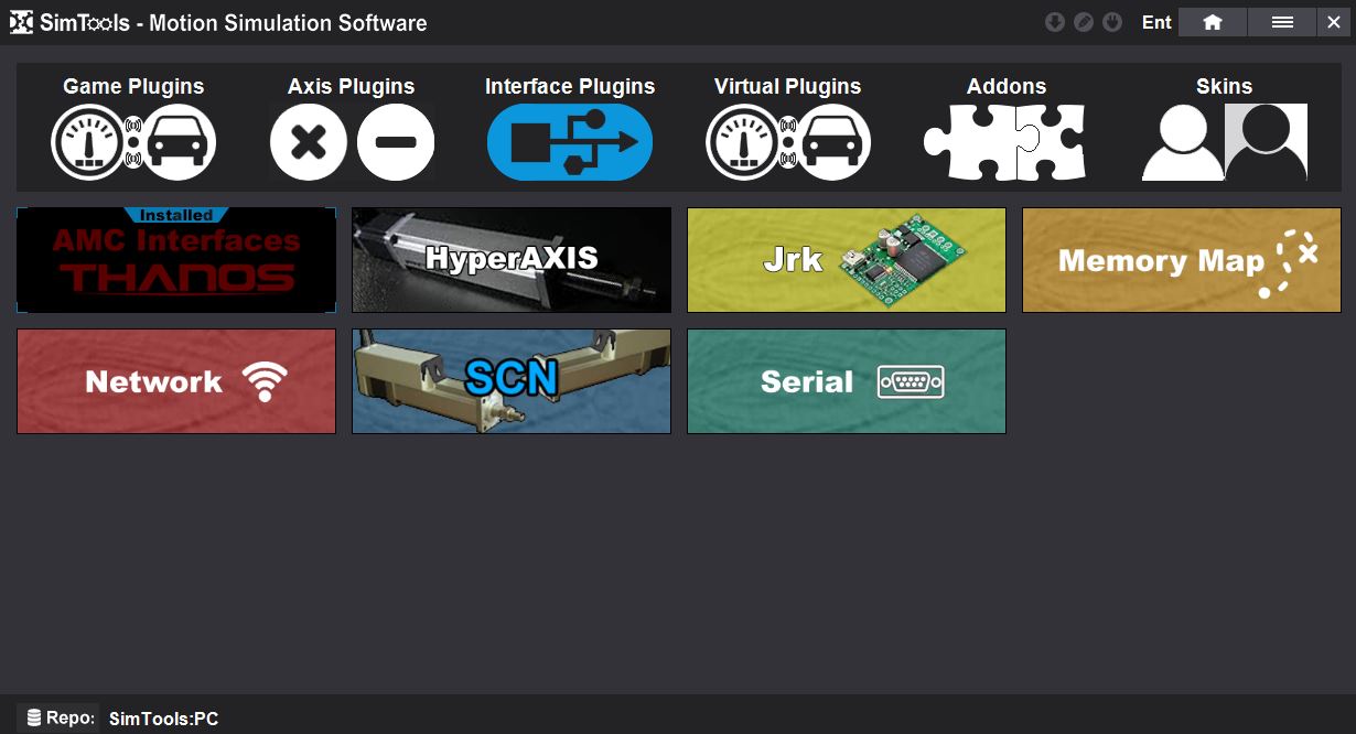

    I installed the plugin - but the screen you showed me is not installed.
    I will try again
    Is anyone building a RF2 plugin ? - I have some suggestions that could improve the experience

    @Gadget999 once the serial plugin is installed hit the hamburger menu button (3 lines) then click interface setup
    then the drop down box

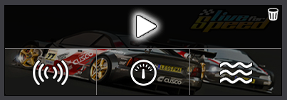

    Since we now double click to launch games from the Gui, I thought it would be nice to have some sort of clicked-once action. (which reverts to normal after ~350ms)
    This allows the user to know that they have clicked the play button once.

    Both SimTools and any game plugins installed need to be updated before a run.
    If your using the F1 2021 plugin, please remove it and reinstall.
    (Changed plugin naming a bit)

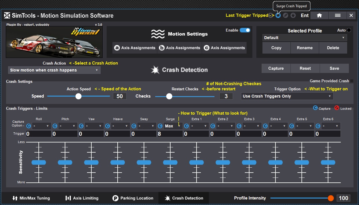

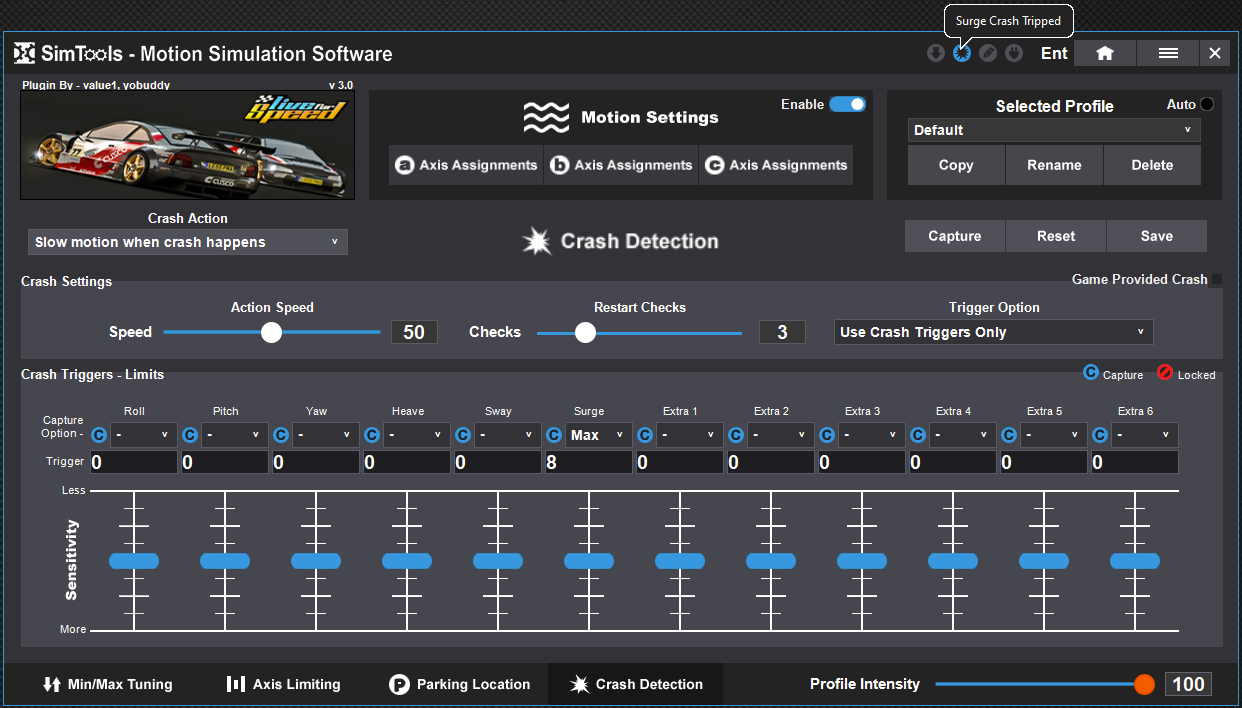

    Crash Detection now included. ;)
    New Crashed Status icon added. (Hover to show the last crash triggered event).
    Dash Edits control upgraded for future skinning (& Red removed).
    New Play button One-Click action added.
    A little bit of what means what...
    I have done allot of testing, but more is needed of course.
    When using the Slow-Motion setting, please let me know what you think of the rate at which it gets back up to game speed. Does it need adjusting?
    (Be sure to setup the default profile, so it can be inherited by new profiles.)
    Let me know if there is any questions. :cheers
    Chat soon!

    In v3 you would setup v3 on your pc, when you have it working, simply export a 'setup-plugin'.
    You can then load the setup-plugin to your repo and everyone else gets to setup with the press of a button. ;)
    And axis assignments now get packed into custom plugin exports, which can also be loaded to your repo so users can install then with a press of a button. Find an error, you can simply update a plugin and the update is offered too all users of the plugin.

    I've been looking at the crash detection but am I missing something? Which min/max set number does it relate to? if I put surge in set #1 as 4 and in set #2 as 2 which one is limited by the crash detection? Is there a settings page for each of the 3 sets?
    Thanks in advance for your help.
