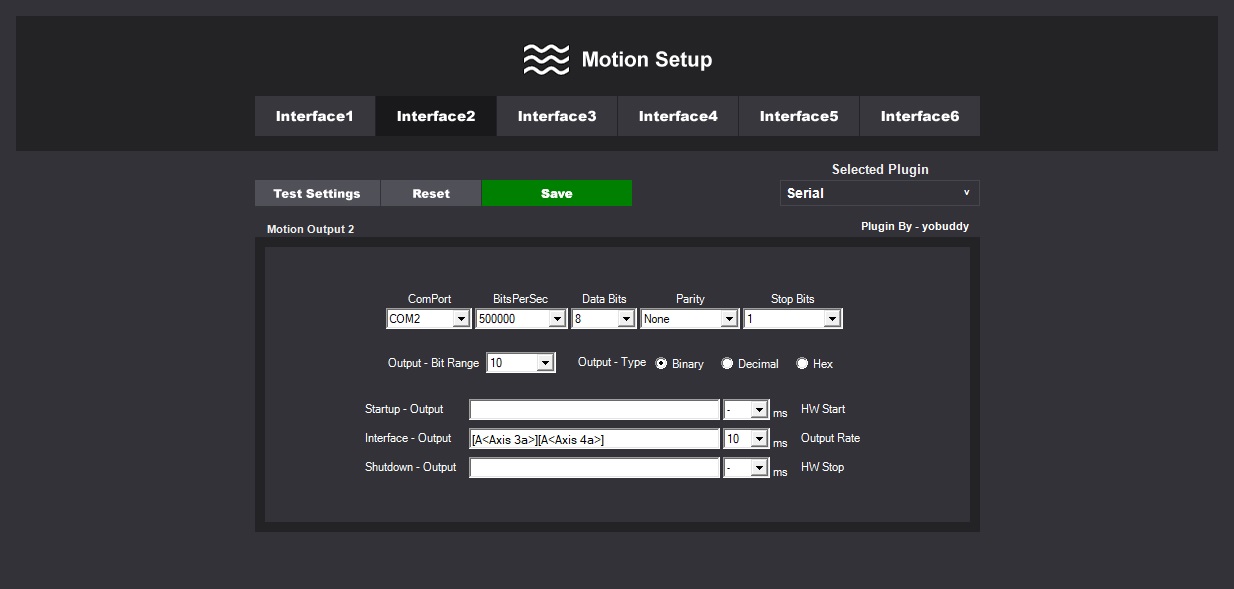

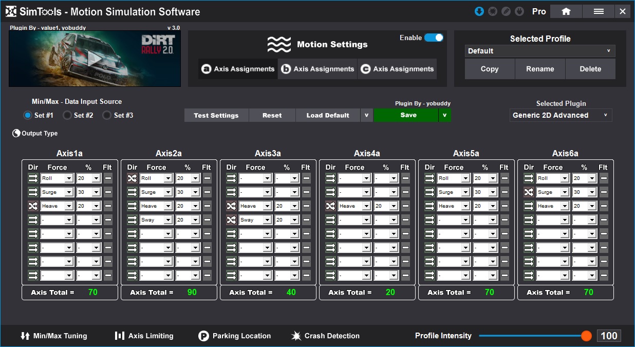

    Hi all, I have installed and registered the v3 configured the com interfaces and the axes with the settings of the v2 but I have no movement with the axis test and not even starting the game. Can you help me understand where I'm wrong, thanks.

    I inserted an image of the Motion setup but I also configured the other axes ...
    Logically with the v2 with the same settings everything works correctly.

    Ok solved, I deleted the space in the string on "Interface / Output" (Axis 1a in Axis1a) and the axes now move ....
    Only the movements don't match, now I'll waste some time.

    I can't get the six axes to work at the same time using the image setup I posted earlier, only one axis works .....
    :sos
  16. yobuddy
    51,737Coins
    +5,205 / 19 / -0
    Please remove the spaces buddy, Example... <Axis1a><Axis2a>
    Also, your sending both with an 'A', I'm not sure what hardware or sketch your using, but i bet one should be... B<Axis4a>
  17. noorbeast
    22,201
    154,669Coins
    +11,207 / 57 / -2
    From the rest of the settings it looks likely SMC3, so as you say it should be this format: [A<Axis1a>][B<Axis2a>][C<Axis3a>]

    Thanks for the help, indeed with v2 (SMC3) I have:
    [A<Axis3a>][B<Axis4a>]
    [A<Axis5a>][B<Axis6a>]
    in the rush to try v3 I made this mistake, also due to lack of experience......
    Thank you my friends, I'll try everything tomorrow and I'm sure I'll get there!!

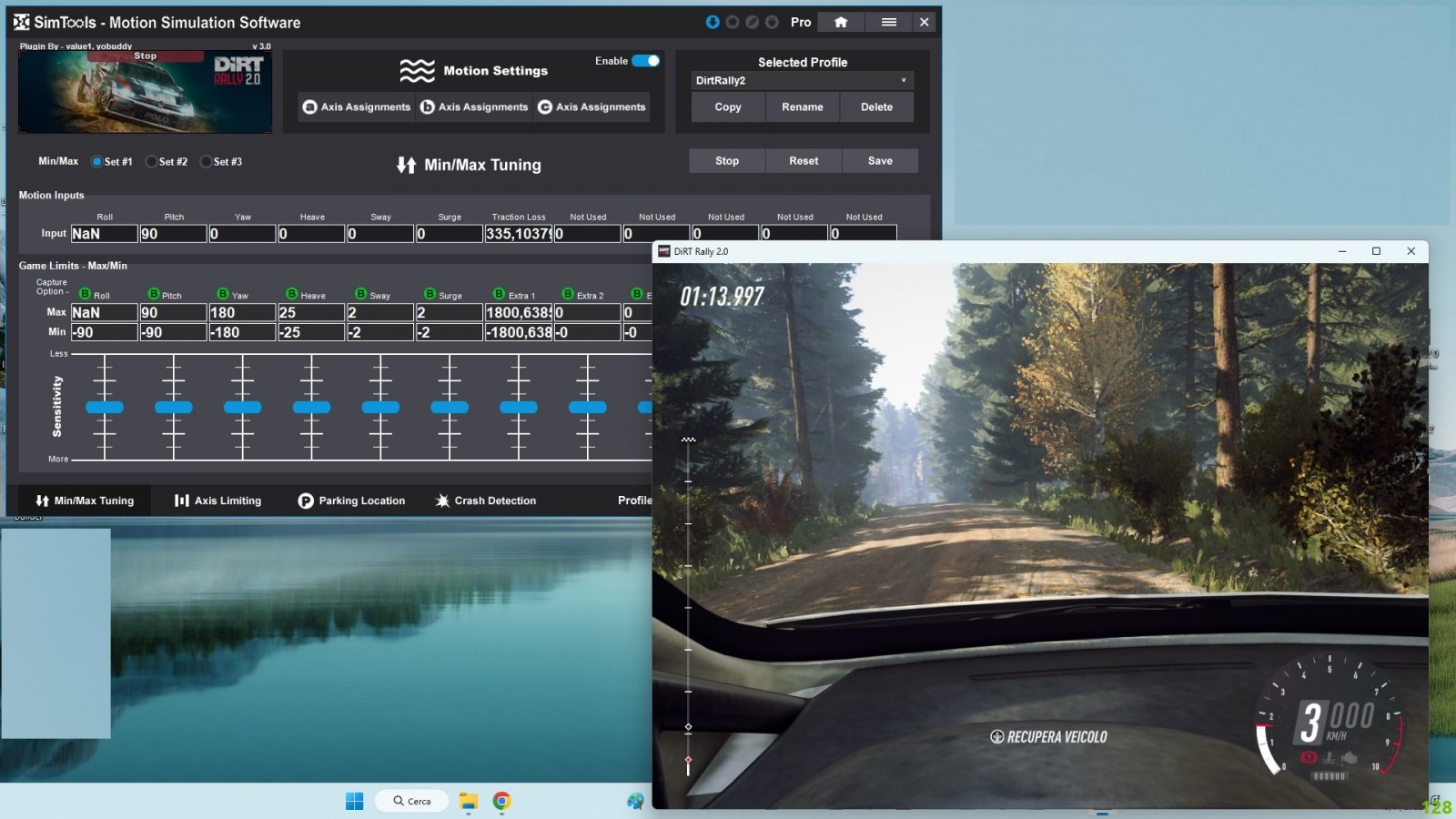

    In Capture Min\Max it seems that only Traction Loss is received and mom axes move while in test they work.....
