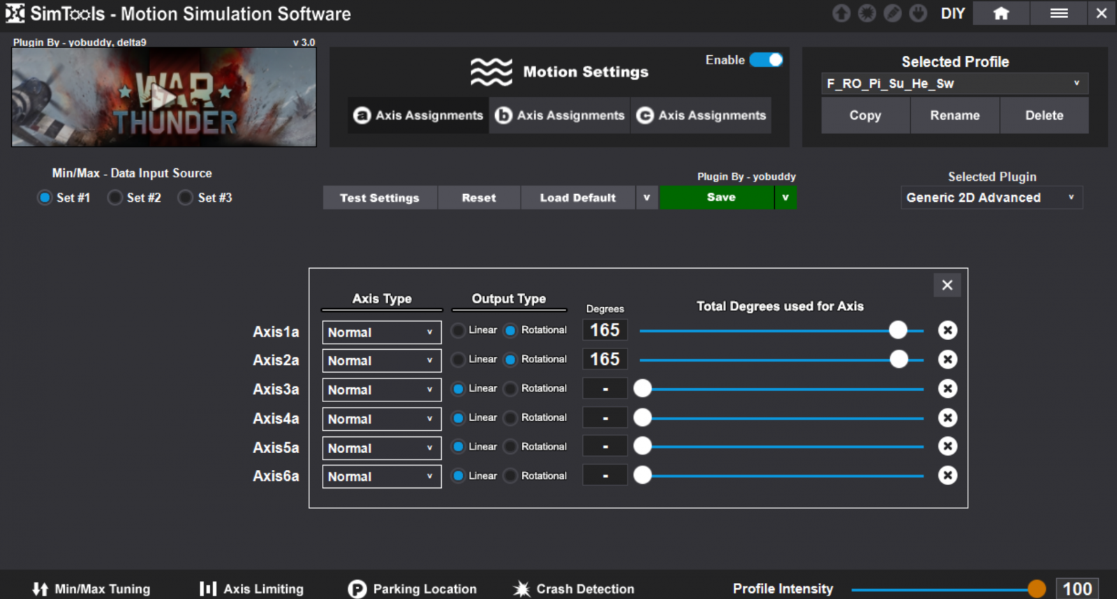

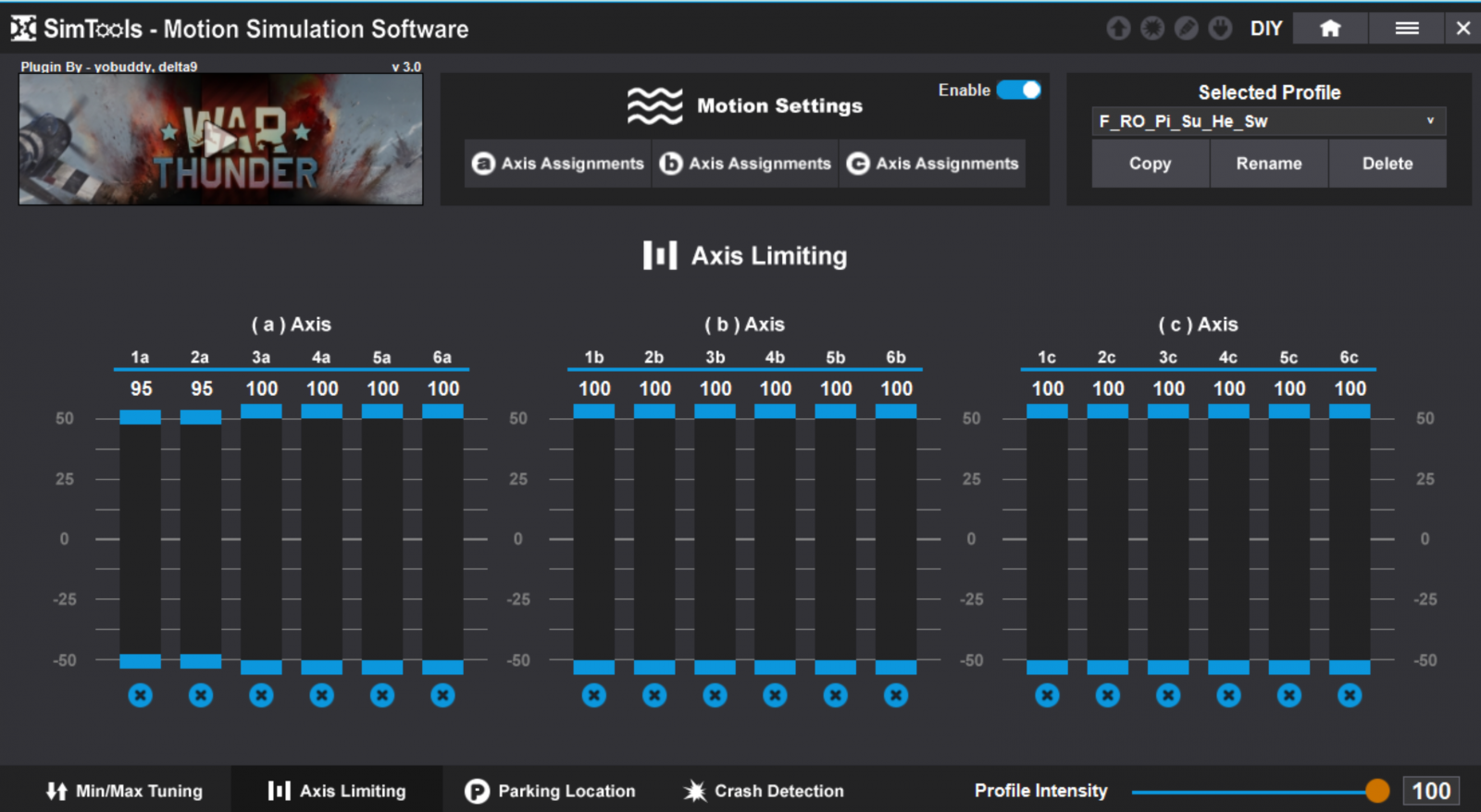

    Thanks, after following your advice combined with yobuddy's advice I've got it working with smoothing turned off, and the axis rotation set to 165 degrees with 100% profile intensity and 95 for each axis on limiting... I'm getting super close to my potentiometer axles now on "extreme" motions (Hammerhead for ground attacks, loops and control loss flat/rolling spins with recovery (sometimes)). So having super fun... although a lot harder to hit the enemy (although I'm not used to Il2 so I'm learning that along the way also) when you're also jerking around but much more realistic.

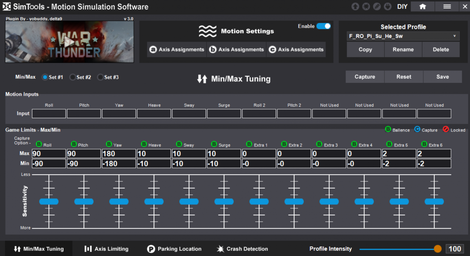

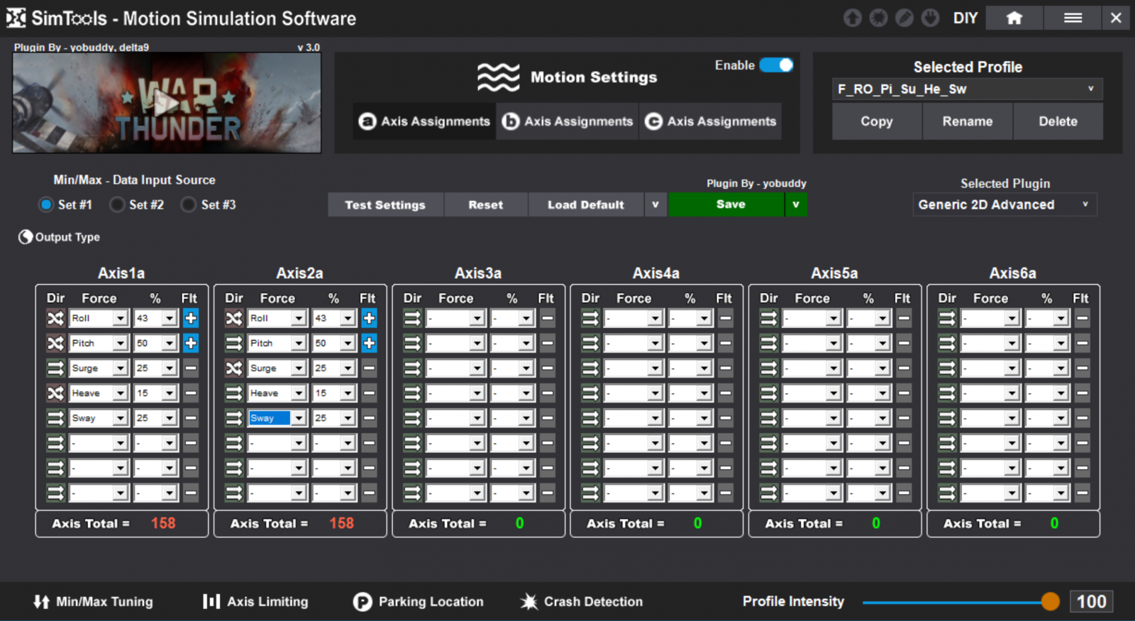

    Thanks for the quick turn around on the fixes. Looks like there may still be some testing or configuration tuning to do though. It is not playable in flight and is very jerky even for a level flight without movement. Here are the details of what I found.
    Notes:
    • Used WT Arcade mode - Test flights for all tests, plane was p-51D This way I could concentrate on just my plane and how it moves
    • EACH Force was tested on it's own with a final test with all enabled (to confirm it was unflyable)
    • I have the simulator working well with IL2 even for advanced maneuvers so I know the sim can take the input and work correctly.
    • Force One Roll: It is "rolling" during a maneuver that is only roll (no pitch or yaw) and it does turn the plane but the moment any pitch or yaw is added it jumps all over the place as if it is getting wild input for the roll value even though it really shouldn't have changed much at all.
      • Tried Roll2 force also but it doesn't seem to be getting any input.
      • WIERD: This may be my inexperience but I had to reverse the direction of my motors for roll (relative to Il2 Strom) I.e. in one flight sim IL2 the roll work great with my motors in => direction but for this plugin I needed to change both motors to "crossover" direction. Is this a game specific settings as I would think that the output for "roll right" should always have my motors direction in the same no matter which game I'm playing.
    • Force two Pitch: It is now giving input (again had to switch motor direction) it is very jerky when any pitch input is given (note: I used keyboard commands and a single "w" key input for "pitch up" to ensure no other directions yaw/roll were being used). Even in a slow steady increase to pitch it is jumping all over the place much like roll does when given any kind of input besides roll.
    • Force three "Surge" - It is now giving input (again had to switch motor direction) but it also gets "jerky" when not giving any flight commands. I.e. in straight level flight with no yaw, pitch or roll given it is jumping all over the place
    • Force four - Heave - Seems good
    • Force five - Sway - Seems good much smoother than roll no jerkiness. I mention this as this is usually an opposing force to roll.
    Question: would you be able to ask the developers what plane they use to test as I read on ST2 (SimTools2) profiles for WT that the inputs are "weird" and had to have a lot of tweaking and that certain planes don't get all the inputs. If I know what plane to test on it would help to ensure we're all on the same "test platform".
    Settings:
    *** The extra + settings for Roll and Pitch are just turning on anti-roll (no smoothing or any other settings)
    *** For Parking Location and Crash Detection I made no changes.

    Hi Guy's,
    The outputs from the v3 plugin for war thunder is just ordered differently from the v2 plugin. (thou it does look like we may need to take another peek at surge)
    Basically, what was pitch and roll in the v2 plugin, is now roll2 and pitch2 in the v3 plugin. (As we could not get any data from them with the vehicles we used) So in the v3 plugin, roll is extra3 from the v2 plugin, and pitch is extra2 from the v2 plugin. I will put them back into the v2 order in the next update of the plugin, as it only confused things.
    The problem with war thunder's output data is it's fairly limited. If you want to see what data is available from the game, then when the game is running, use one of the links below in a browser to display the values.
    http://127.0.0.1:8111/state or http://127.0.0.1:8111/indicators.
    Anyway, I will take another look at the plugin tomorrow.
