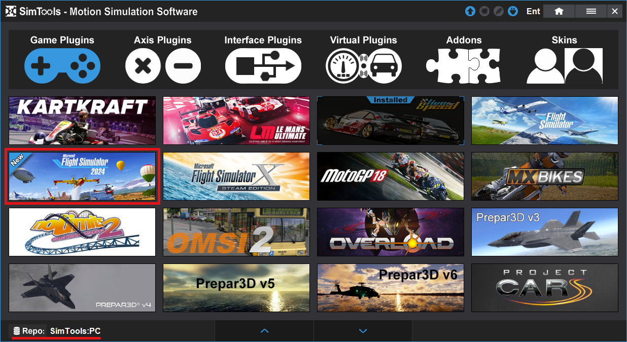

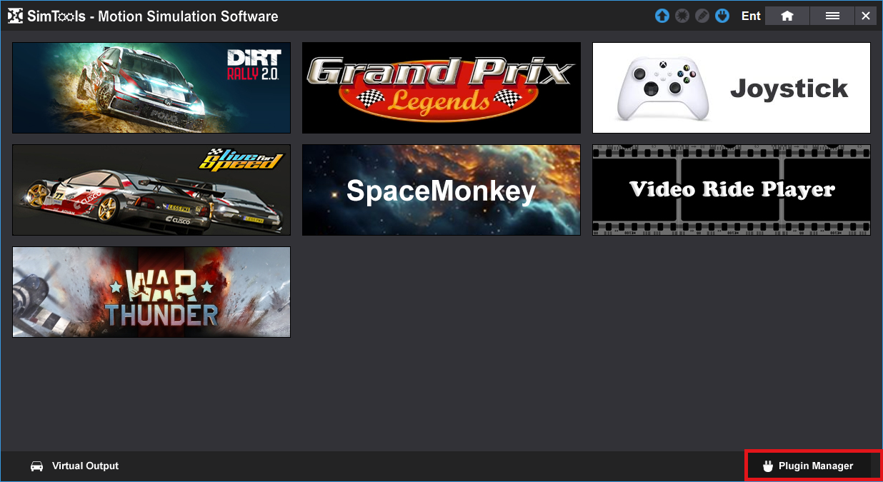

    You can click the 'Plugin Manager' button at the bottom right of the main screen.
    And the plugin can be found in the SimTools : PC repo (if your not already there)
    Take care,
