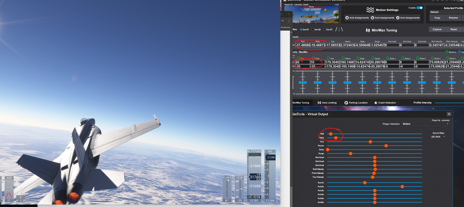

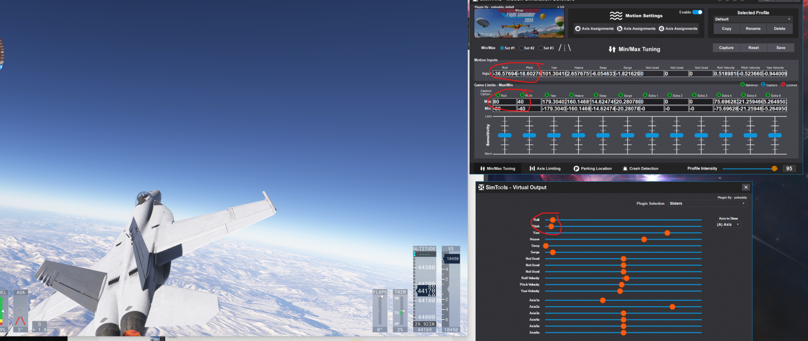

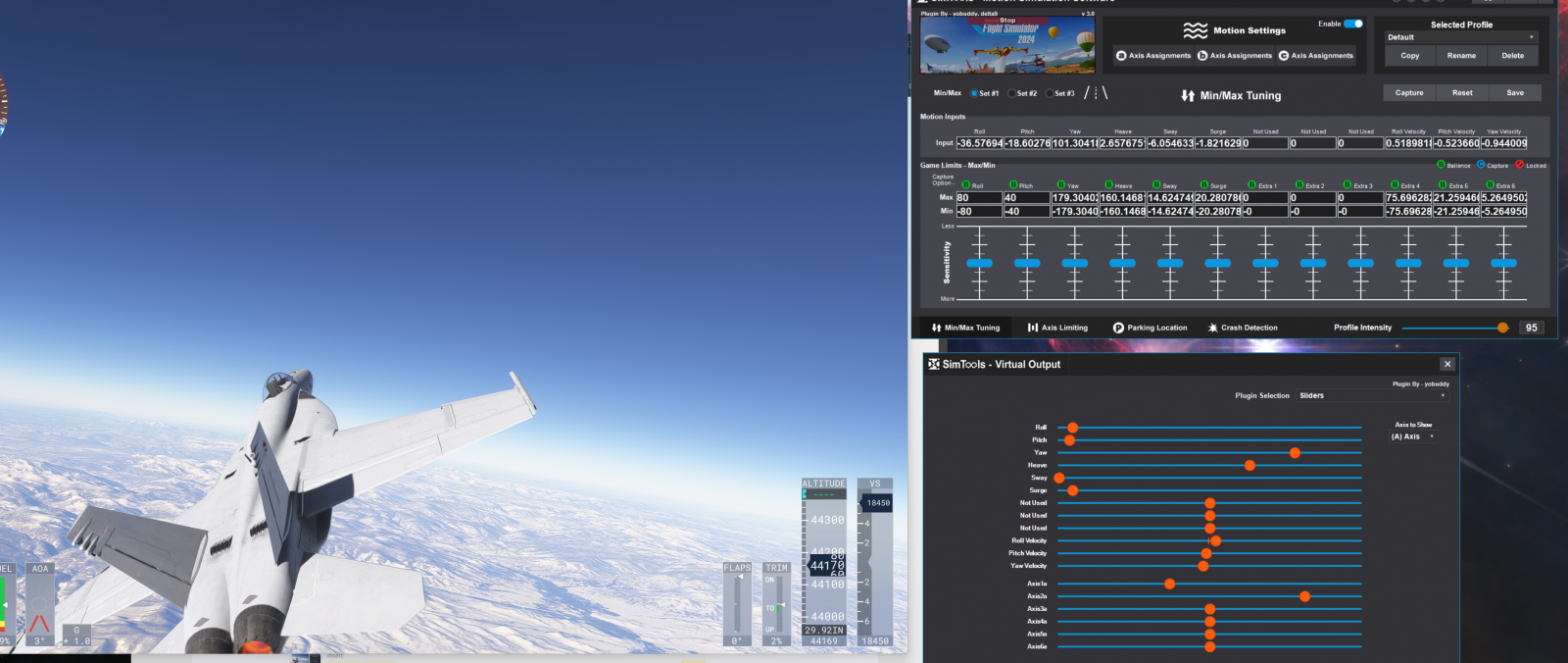

    Having an issue with MSFS 2024 Min/Max Tuning. Roll appears to be fixed at 40 degrees and pitch appears to be fixed at 20 degrees (interestingly these are the same values from @yobuddy 's post above).
    see below with min/max set at 20 for roll and 10 for pitch, but the output maxes out at 40 and 20
    then with min/max at 80 and 40 for roll and pitch, but output stays at 40 and 20.
    Seems like changing the min/max has no effect on the output

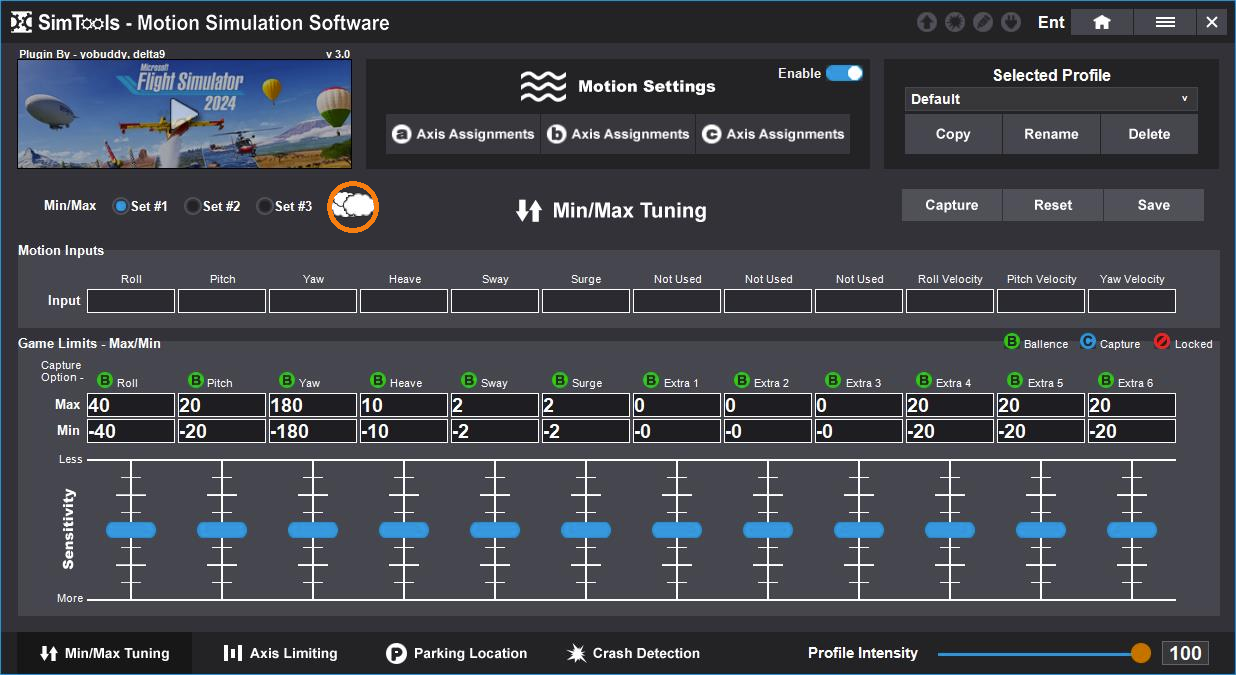

  5. Matthew Bangerter
    Matthew Bangerter Member Gold Contributor
    Jun 27, 2014
    39
    Mechanical Engineer
    Mesa, AZ
    72Coins
    +34 / 0 / -0
    Figured it out, looks like I had to click the runway/cloud button... I feel like this is not the most intuitive thing. wonder if it would be better to have the default set to clouds since most time is spent flying, not on the runway?
    Is there a way to have a descriptive label for that setting and then indicate both which one you are editing and which one is active in game?
    Just a thought. Overall V3 is looking great though!

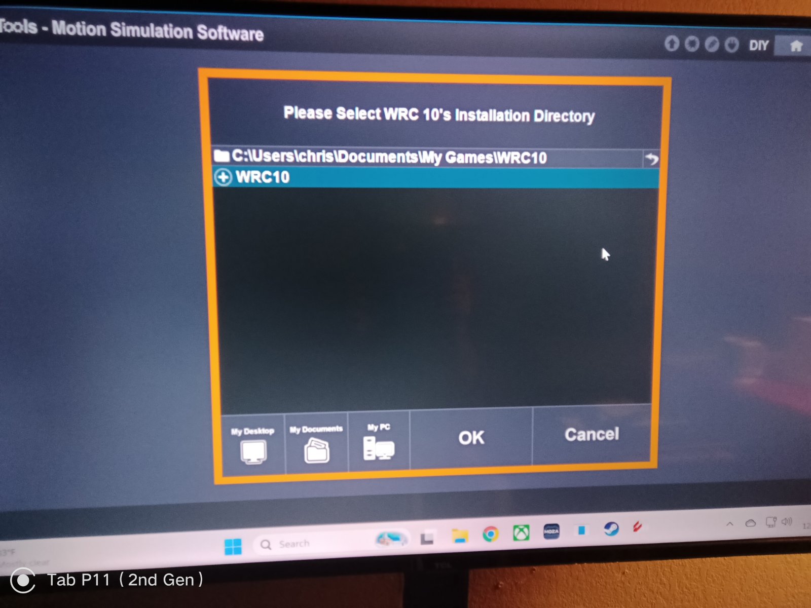

    I am trying to load the Simtools 3 plugin for WRC 10. I am asked to select the WRC10 installation directory. I think I have found the correct path but can't make it work. I'll post a picture of the screen. When I make this choice it says the chosen path it's not a valid for patching.
    I know my only problem is my extremely limited computer knowledge.
    Thanks Chris

    That's the save game location, not the install location for the game buddy. PM me if you continue to have problems.
    Take care!

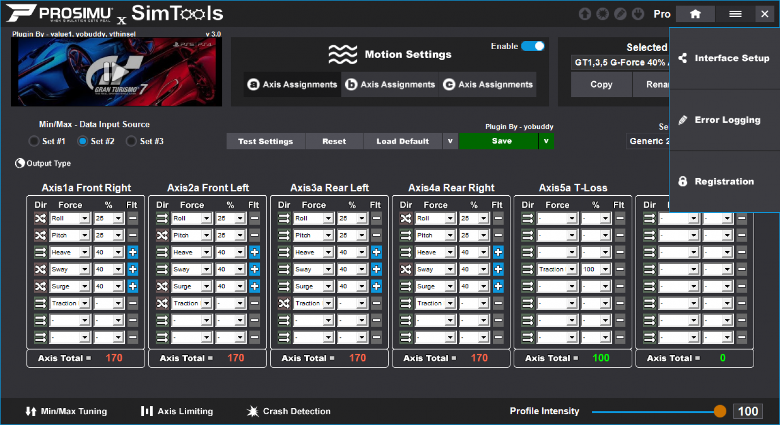

    I am running a rig with 2x thanos controllers for an SFX100 base and gSeat which was working great in V2. I am very much enjoying using the much easier interfacing and improved looks of V3. However the new default plugins cannot match my rig requirements. Is there any plans on releasing the source code for the plugins?

    Hi @BrassEm,
    Why can't you use extra4, roll rate? It's in degrees a second, as I believe you are looking for? It outputs the rate of degree change, and therefor returns to zero when nothing changes. Where Roll simply outputs the current degrees its tilting at. This is why Roll, Pitch and Yaw are classified as a Degree, and the rest are classified as accelerations on the data page shown in your pic.
    Feel free to Pm me if you have any questions buddy,
