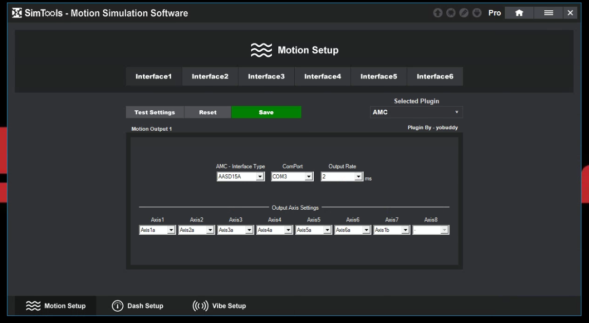

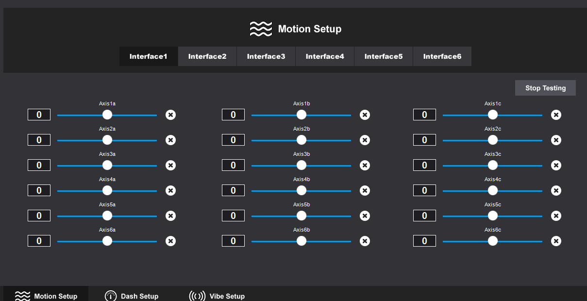

    After i created interface for my 2dof, when run 'test settings', Axis2a start at wrong position, by right it should at the middle, but it went up to 80%. For Axis1a no problems. Im using windows 11 in non English. Would like to ask, Simtools V3 still have this bug - 'SimTools Language setting bug - Change to English Local' ?
  6. yobuddy
    51,772Coins
    +5,206 / 19 / -0
    What do your parking location settings look like buddy?
    This problem has be resolved, with the last of the fixes (including the serial interface plugin) being pushed out this week.

    I not yet reach the game motion setting or parking location. I test Axis motion in interface.
    * in SMC3 utilities it works fine.
  8. yobuddy
    51,772Coins
    +5,206 / 19 / -0
    I just pushed the update for the serial interface, give it 5mins or so, and then restart SimTools and you should receive the updated serial interface.
    Also, be sure the SMC3 utilities app is closed before running SimTools.

    Hi, Thanks. Will reinstall serial interface tmr, and update status here.
  10. mhchong
    mhchong EK99
    Feb 28, 2021
    17
    freelancer
    malaysia
    - 120Coins
    Tested. It works fine now. Thank you.

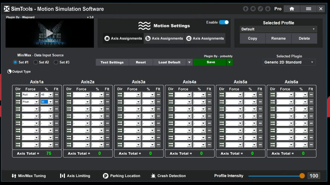

    Simtools 3 has been working great with my rig and Thanos AMC controller. I'm moving over to a new more powerful computer and it's not responding now.
    I know I've set it up correctly mechanically because sim racing studio works as expected but when I hit test on simtools I get no response at all.
    I try not to jump to a forum first thing, but with "nothing" as a starting point I'm not sure what I'm even troubleshooting so I'm hoping you guys can point me in the correct direction.
  12. noorbeast
    22,227
    154,831Coins
    +11,227 / 57 / -2
    Can you please post pictures of all settings, so we have some idea of you may have done or not done.
    If changing computers I presume you re-registered SimTools, but want to ensure that is the case.

    Yes, I am registered once again.
    I've uninstalled and reinstalled a few times so currently I don't have most settings. I figured I'd work until I got one motor to respond before I put it all back in.
    Here's the settings as they currently are
    Here's the settings from the still working older computer.
    I apricate you taking the time to look at it. I don't think it's an issue here though because my system has an "active" state it will switch to when I press "test settings" and currently nothing happens on the new computer. as a reminder it does work with another sim program and works in simtools on the old machine.
  14. peter stolmeier
    peter stolmeier Active Member
    Sep 29, 2020
    100
    588Coins
    +58 / 0 / -0
    found it.
    after re-reading what you said I searched for what more settings you may want to see. I had not set up this one.

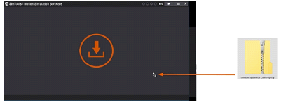

    I was hoping to import my settings. I see the export wizard but it's a little unclear how the import works.
  17. peter stolmeier
    Sep 29, 2020
    100
    588Coins
    +58 / 0 / -0
    Simtools 2 and 3 are similar enough in most cases to use one guide for the other but that's not the case with loading a backup. When I do a search about it I get instructions for the plugin updater for 2 but I don't know what the equivalent for 3 is so I'm still looking for guidance.
    I actually suggest adding an "import wizard" next to the export one for clarity to new comers.
  18. yobuddy
    51,772Coins
    +5,206 / 19 / -0
    Hi Peter,
    I will make this more clear in the next update to the manual, thanks for the feedback.
    Launch SimTools v3, and then drag-drop the file onto the gui to install.
