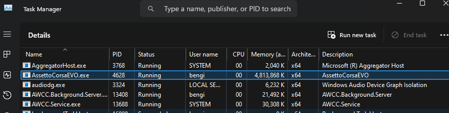

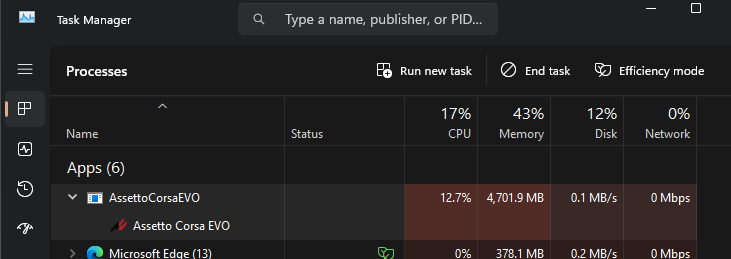

    Could either of you give me the exe name, and the running process name for AC Evo (usually the same). Then I can put together a test plugin for the game.

    Hello @yobuddy
    As requested.
    Path => C:\Program Files (x86)\Steam\steamapps\common\Assetto Corsa EVO\AssettoCorsaEVO.exe
    Task Manager Process

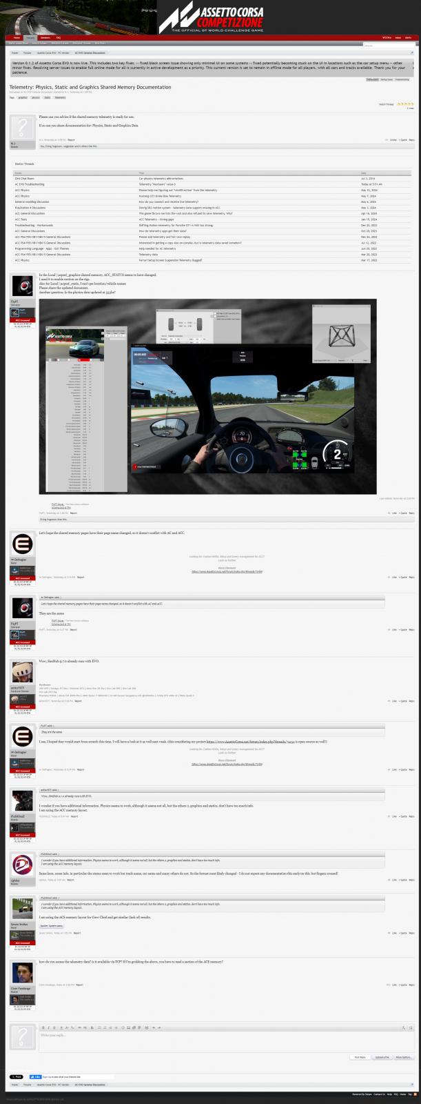

    Here's something that might be helpful in creating a motion plugin based on telemetry. Simhub already did tap into it.

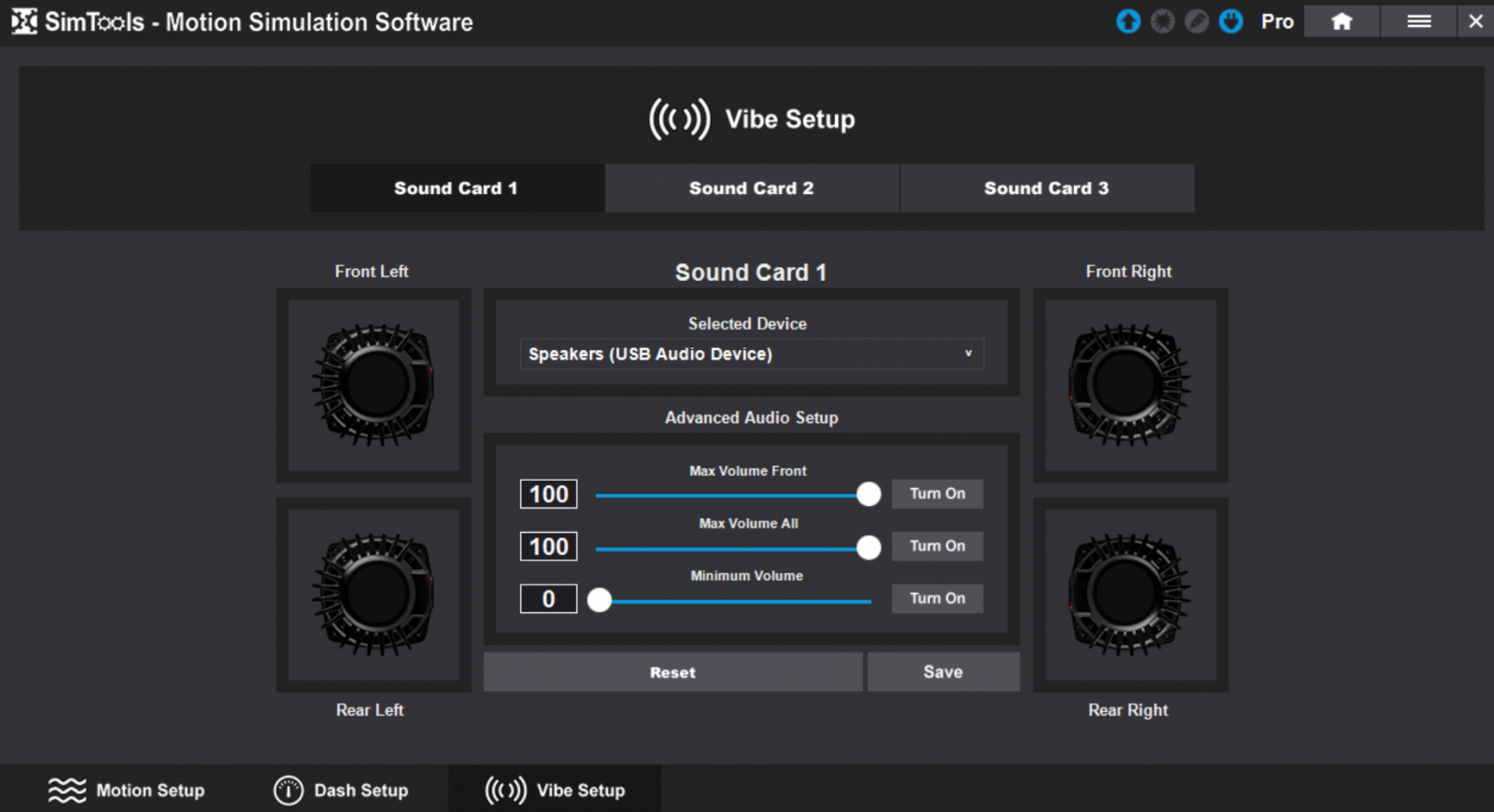

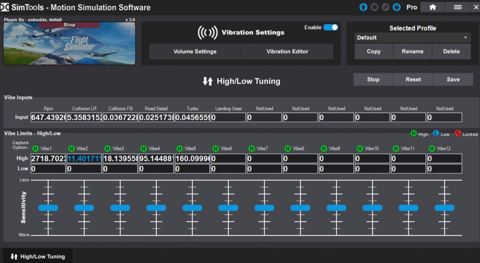

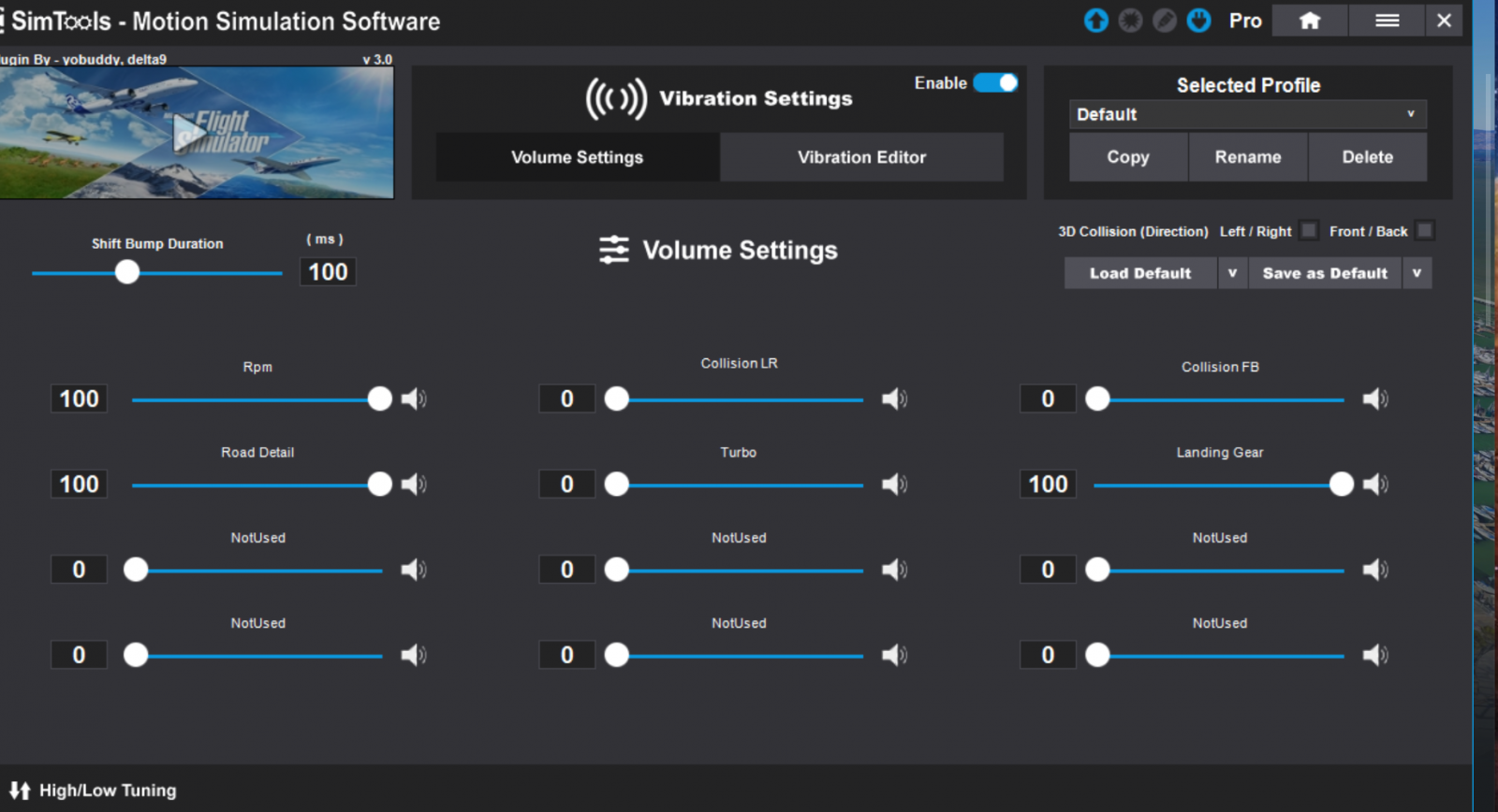

    Just started using SimVibe. My rig is setup for Flight Simulator but I cannot get anything working.
    I bought a USB sound card (so cheap). For a test I set it to be the main sound card and I get vibration in the Buttkicker as expected.
    Next i moved on tho the vibe setup. Here is what I did to set it up (this is the first thing I have attempted with Vibe).
    1) Setup the interface
    2) Setup the volumes for MSFS
    3) Setup high low range
    I get nothing. What did I miss?

    Do you get output when you test in the interface settings? Make sure the master volume for you is sound card is set to 100 (volume icon in system tray)
    FYI I have been using vibe for a while and can confirm it works.

    I verified that with my stereo USB sound card it does work in test mode. I just loaded MSFS 2024 so I will see if I can get that to work. Didn’t realize I could test there even though I looked for a test button vs Turn On.
