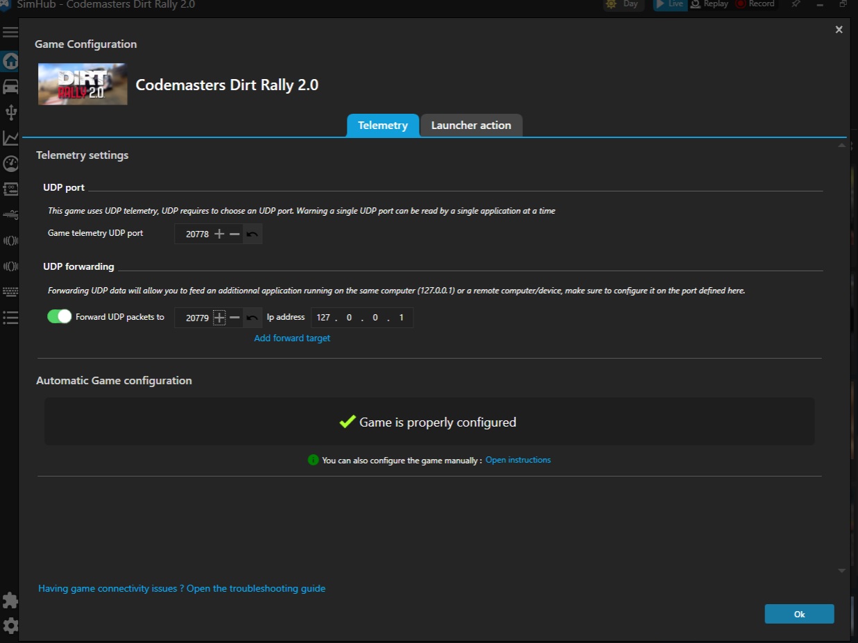

    thanks a lot for the help, but i try port forwarding the
    udp 20777 - 127.0.0.1 to
    forwarding ,on, udp 20778 127.0.0.1
    not work for me, i dont know if i made something wrong, i keep trying.
    for the moment I configure simhub, simtools stops working :sos

    Perhaps post pictures of all of the settings, so members who use both can comment.
    Basically 2 different apps can't access the same UDP at the same time, but can pass them on, so something sounds like it is amiss.

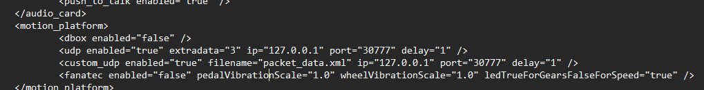

    well I share one of the configurations that I try, anyway I try 4 possible configurations including doing it manually in the xml files, but without results, when I get simhub to work, simtools stops working, if anyone has a clue to follow it would be of great help. i will keep trying

    another config

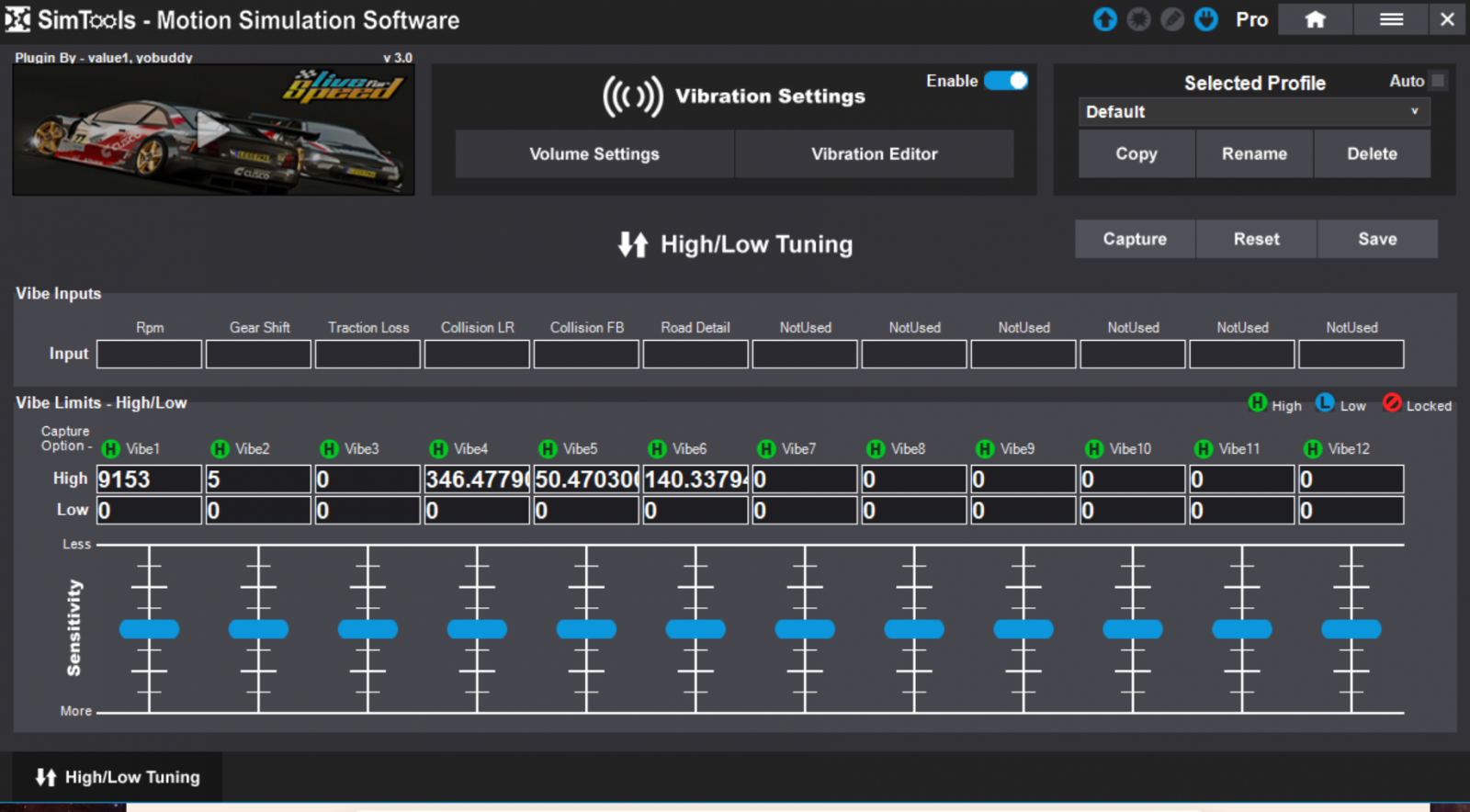

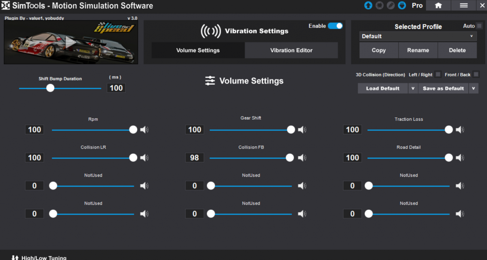

    Following up on SimVibe. I verified that the Buttkicker executes in test mode. I setup Live for Speed. Unfortunately, in game I have nothing at all. The test screen is extremely loud . I assume I just missed a button somewhere.
    NOTE: Motion is working just fine so its hooked up to the game.
    I have a video of setting up AC I could post but I am still hoping its a simple issue.
    Here are the screens from LFS:

    Have you set up the sounds for rpm, gear change, etc in vibration editor?

    The what now? No I assumed there were default values. I knew there was something missing. Thanks for the help. Works now.

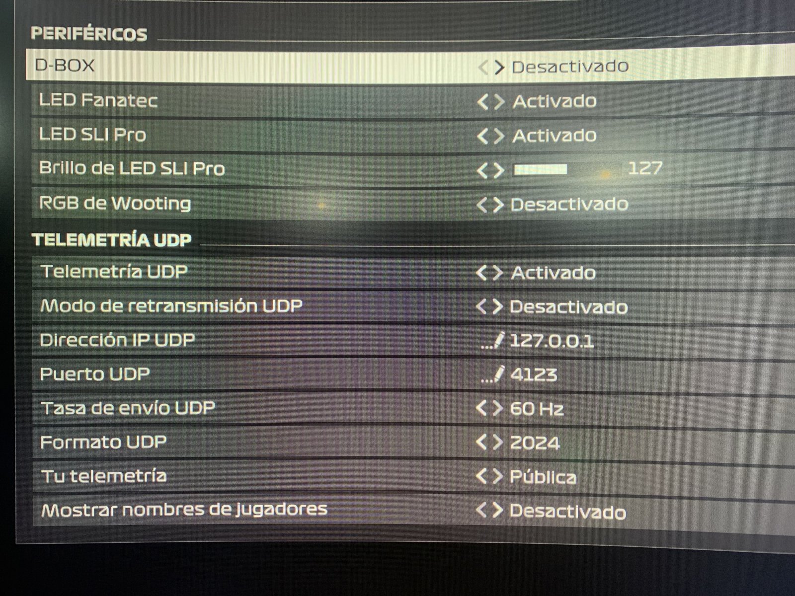

    Hello Guys, I just installed F1 2024, I can`t make it work with simtools V3, I completed a race, the telemetry is set , udp port configured 4123, ip 127.0.0.1 but it still not activate the simtools when the game starts on steam, I even tried writing the settings in the launch options on steam -telemetry network -port 4121 -ip 127.0.0.1 any advice!¿?

    You need to start from simtools. For vr specify -vr -openxr in the startup switches in steam.

    thanks for the reply, but even if I drag the shortcut to the simtools it doesnt start from there, anyways I didn't had to do it in F1 2022 or any of the other games, this is the only one that isn't working, F1 22 is running with no issues

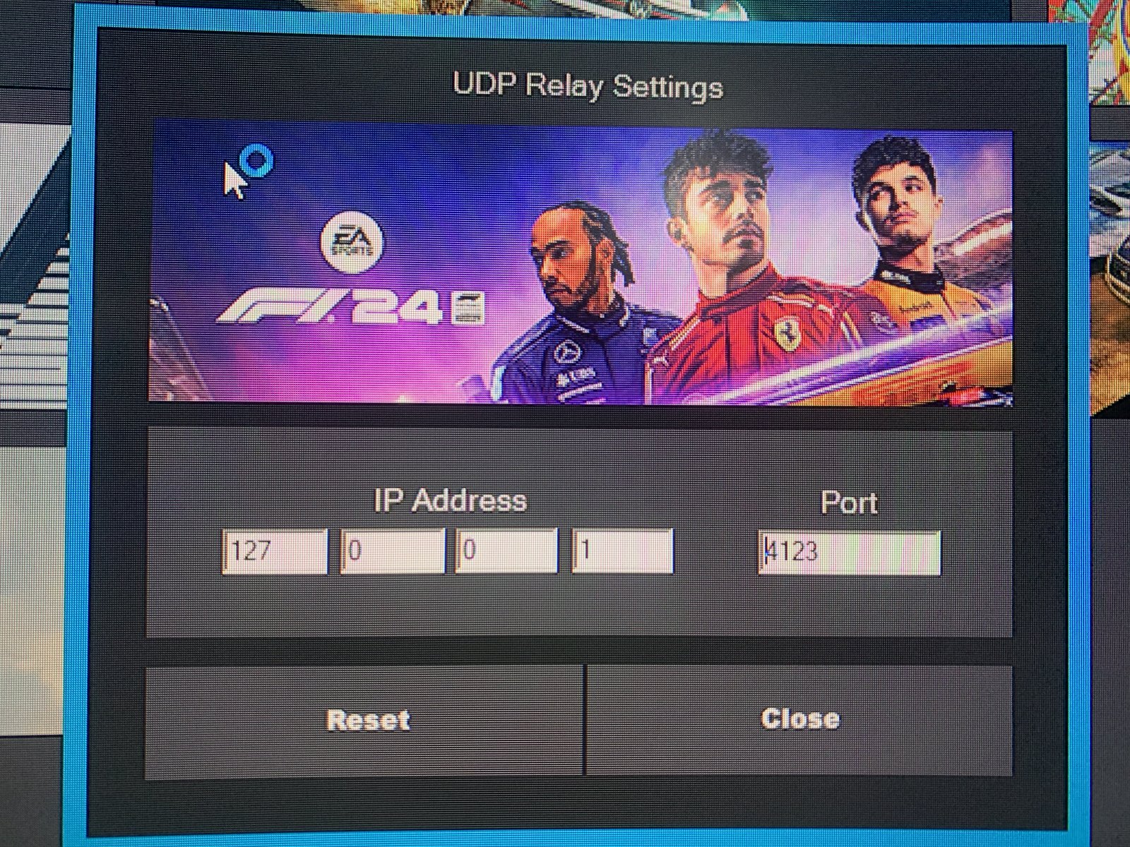

    I installed on steam, I drag the shortcut to the simtools but it won’t start when I hit the Play Button!

    Please remove the UDP relay, as your rerouting all game packets back to itself. (The UDP relay is so you can send a second copy of the data to another application)

    Hi yobuddy! Thanks for hit me back, the process name is F1_24.exe if that what you mean… can you give me more details about the UDP relay you are telling me to remove please? My rig started to move twice already randomly when I started the game, but only twice of maybe 30 times I have tried with different settings, for now I keep the UDP addres IP 127.0.0.1 and port 4123

    You have the UDP relay sending all game packets back to itself in a endless loop. The game packets are already aimed at 127.0.0.1 /4123, so there is no need to loop all packets back to 127.0.0.1 /4123. Or you just get every packet ever sent from the game looping endlessly.
