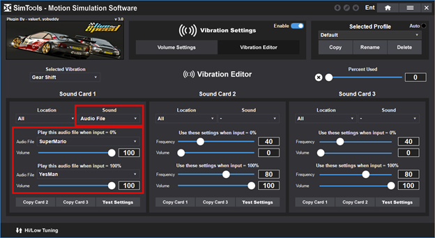

  15. Roland Munz
    Roland Munz New Member Gold Contributor
    May 23, 2018
    9
    - 114Coins
    unfortunately Gamevibe doesn‘t work anymore in the Games. When I press the Test button in the Game, Simtools crashes immediately (see below).
    But the whole equipment (Soundcard, Buttkickers, Amp) works definitively and everything was fine over months but now I have this problem.
    Do you have an idea?
  16. yobuddy
    51,771Coins
    +5,206 / 19 / -0
    Please go to your sound card settings and un-select the sound card for SoundCard #1. Restart SimTools and then re-select the sound card for SoundCard #1 and hit save. Then please give it another shot and let me know how it goes buddy.
  17. Roland Munz
    May 23, 2018
    9
    - 114Coins
    Yes, that‘s it!!!
    Many thanks to you yobuddy
