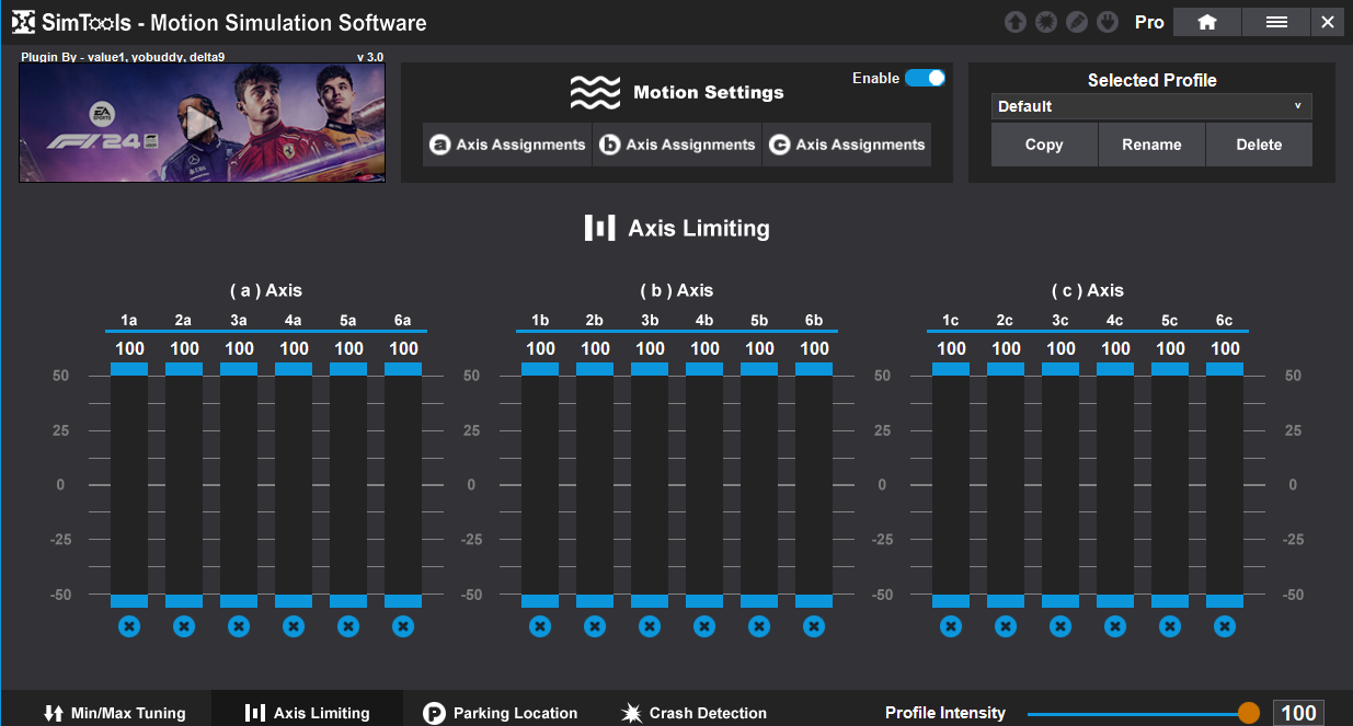

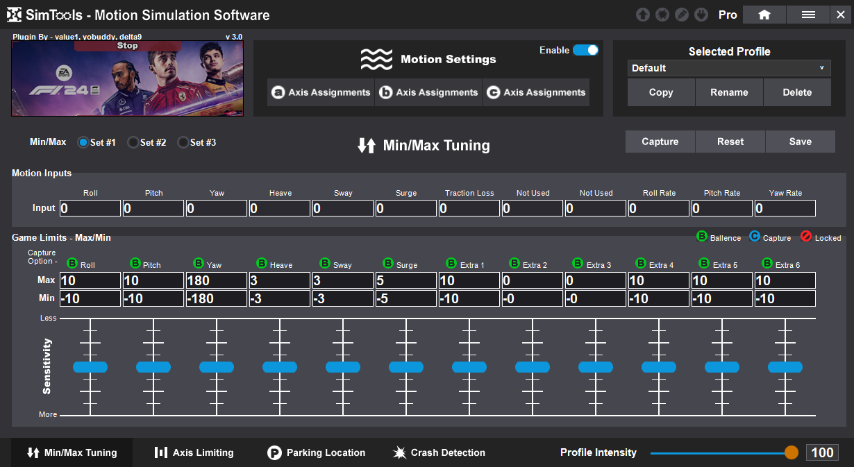

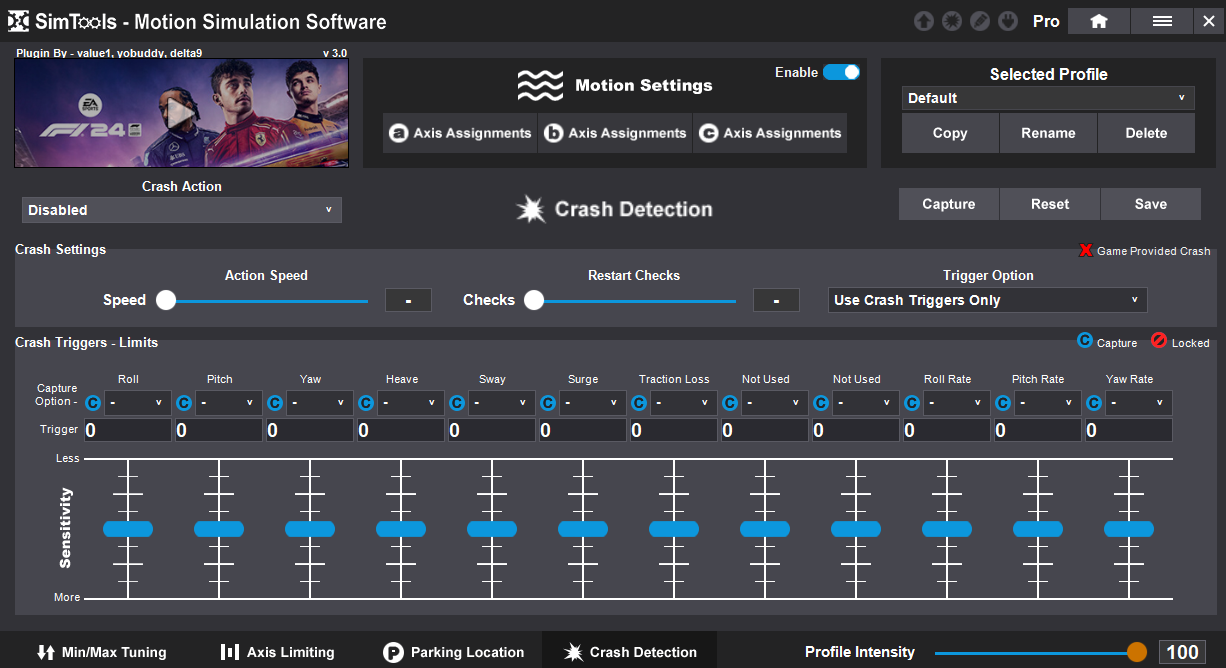

    I'm having trouble getting telemetry from F1 24 to SimTools for my 6DOF setup. I've configured all axes (Heave, Sway, etc.), and the visualization moves when testing manually. However, no data is being received from F1 24 during gameplay.
    I've completed a full race and even reinstalled the plugin, but there's still no telemetry. The .exe file is mapped in SimTools, and I'm launching the game via the play button.
    I've read that the relay function in SimTools isn't the correct method for reading data. Is there any way to confirm if SimTools is detecting that the game is running? Any guidance would be greatly appreciated.

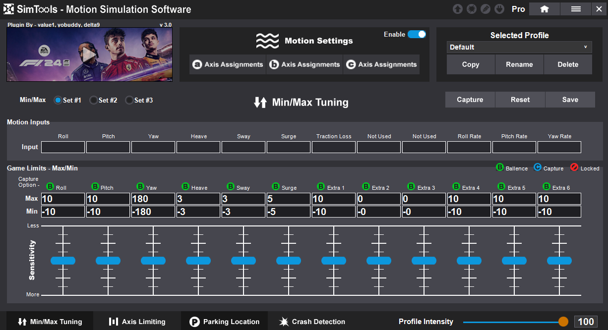

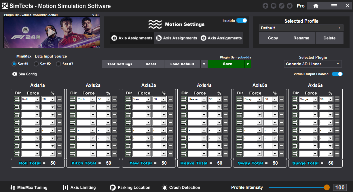

    SimTools doesn’t seem to behave any differently whether the game is running or not. However, as requested, here are some screenshots of SimTools with the game running.

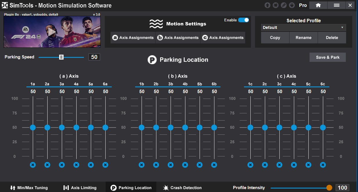

    I’ve set all axes to 50% (no particular reason) and have Virtual Output enabled. When using "Test Settings," I can see it affecting the Virtual Axis. This leads me to believe the issue isn’t with the calculation settings but rather a lack of input from the game.
    When it comes to the other screens for Min/Max Tuning, Axis Limiting, Parking Location, and Crash Detection, I haven’t changed much—if anything at all. However, here is the screens. I have also not added any filtering to the input signals as seen on the screen above.

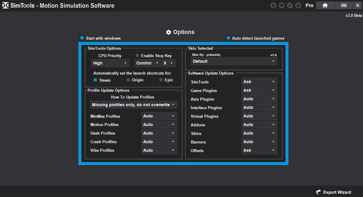

    For the SimTools settings, this is the only screen I see as relevant.

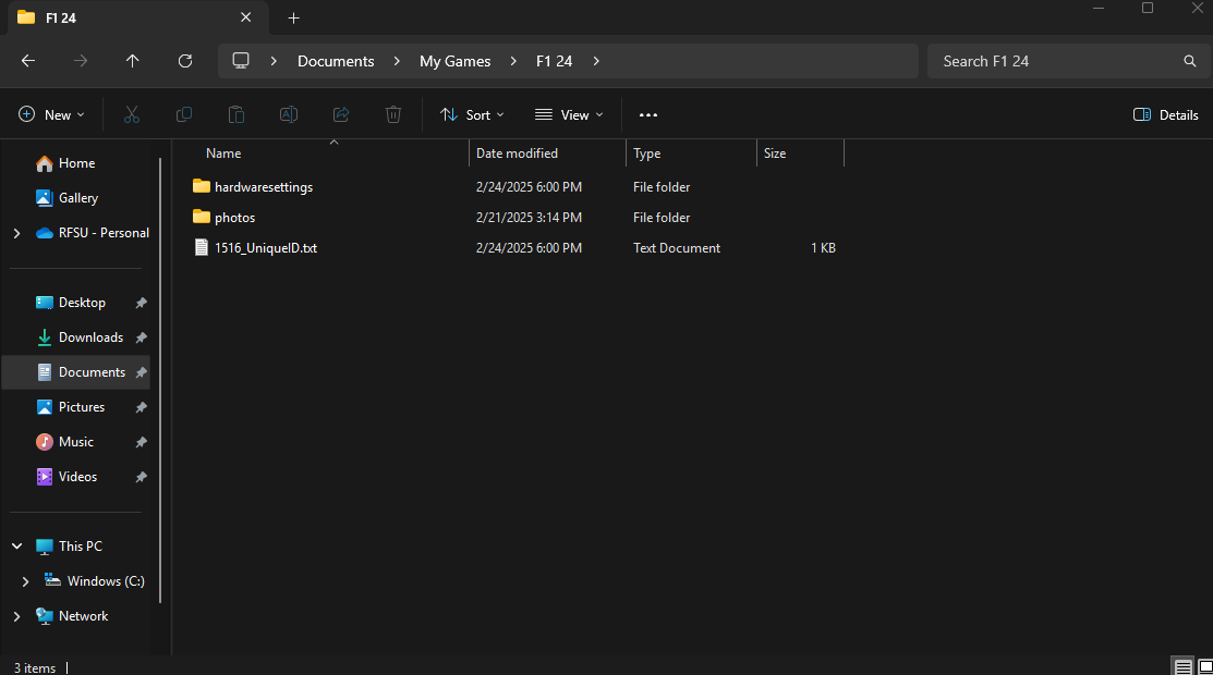

    When I installed the plugin and was prompted to reference the save folder for F1 24, I pointed it to this folder. My question is whether I might be missing something, as I don’t see any connection to the two career modes I’ve started.
    I will also try to get the same data from Assetto Corsa Competizione and EA SPORTS™ WRC, but I wanted to focus on one game at a time to troubleshoot properly. There’s still more work to do on other aspects of the project as well.
    Once again, I appreciate the quick support and look forward to hearing your thoughts!

    The game plugin is not running in the pics above. Note that you have to double-click the play button to launch a game. You will see data coming in on the Min/Max tuning page when its working. So that is a good place to check for activity.

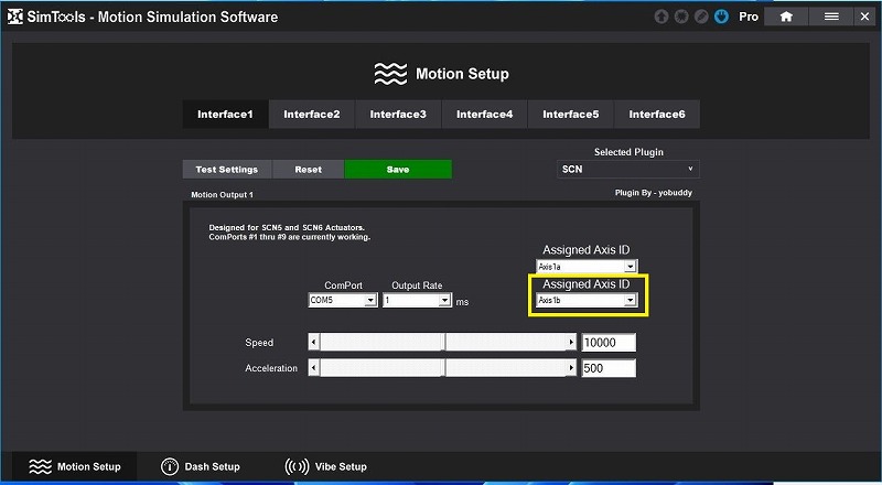

    Does this Input Field work for B-Axis Assignment?

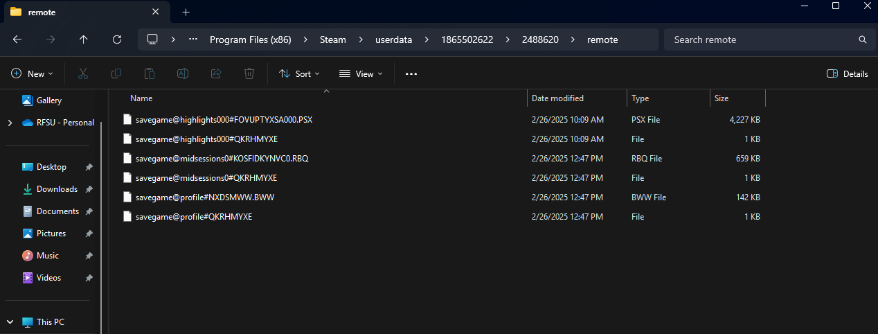

    Regarding the save location I linked during plugin installation, I noticed that the "savegame" folder is missing because my files are stored under the "remote" tab in Steam. Could this be the reason the plugin isn’t working properly? I’ve attached a screenshot of the folder for reference.

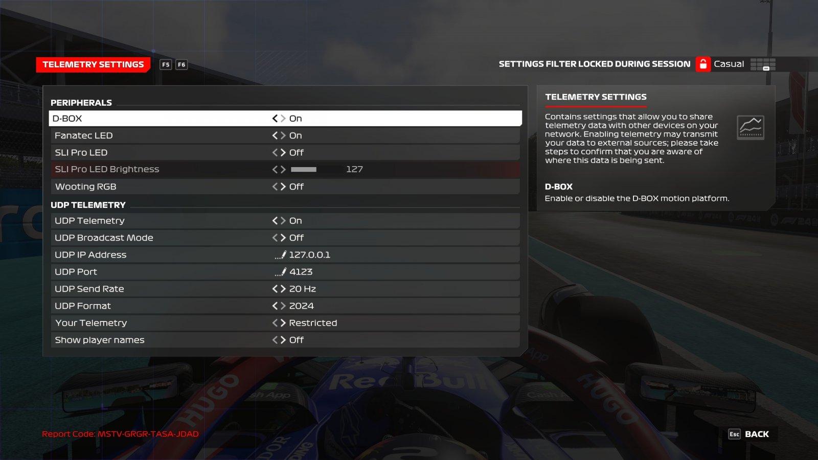

    That said, I finally got the telemetry data from F1 24 to display in SimTools, making the virtual axis respond correctly to the game. The fix came from a post by @yobuddy regarding the basic settings for where the game sends UDP packets: UDP port 4123. For some reason, this wasn’t the default value when I installed and launched the game.
    After changing the UDP port to the correct value, the motion input activated, and everything started working as expected. I'm attaching the telemetry settings from the game so others can see the fix as well.

    I confirmed that it works with SimTools 2, but it does not work with SimTools 3.
    A and B move when I start SimTools 3, but they do not work with the game.
    I hope to have an Assetto Corsa EVO plugin for SimTools 2. :sos

    Have you configured the B Axis Assignments to use Min/Max Set #2? Next make sure the game your trying to play has Min/Max settings for Set #2, or you will get no output. (None of the game plugins come with Min/Max settings for Set 2 or 3.)

    YES, It works !!! after Captured Set #1 and Set #2 Thank you for your support. :cheers
    We still want to set ID 0 and ID1 Speed and Acceleration separately on same COM because completely different actuator we use.:)

    Or We would like to have a function where COM ports such as 7, 8, and 9, which are not used in (A) Axis Assignments, can be assigned to (B) Axis Assignments. This would make it a perfect motion software. Thank you.

    I'm not sure I understand, as we can already do this by setting up another interface to use the unused comport. (as we have 6 interfaces we can use in v3)
