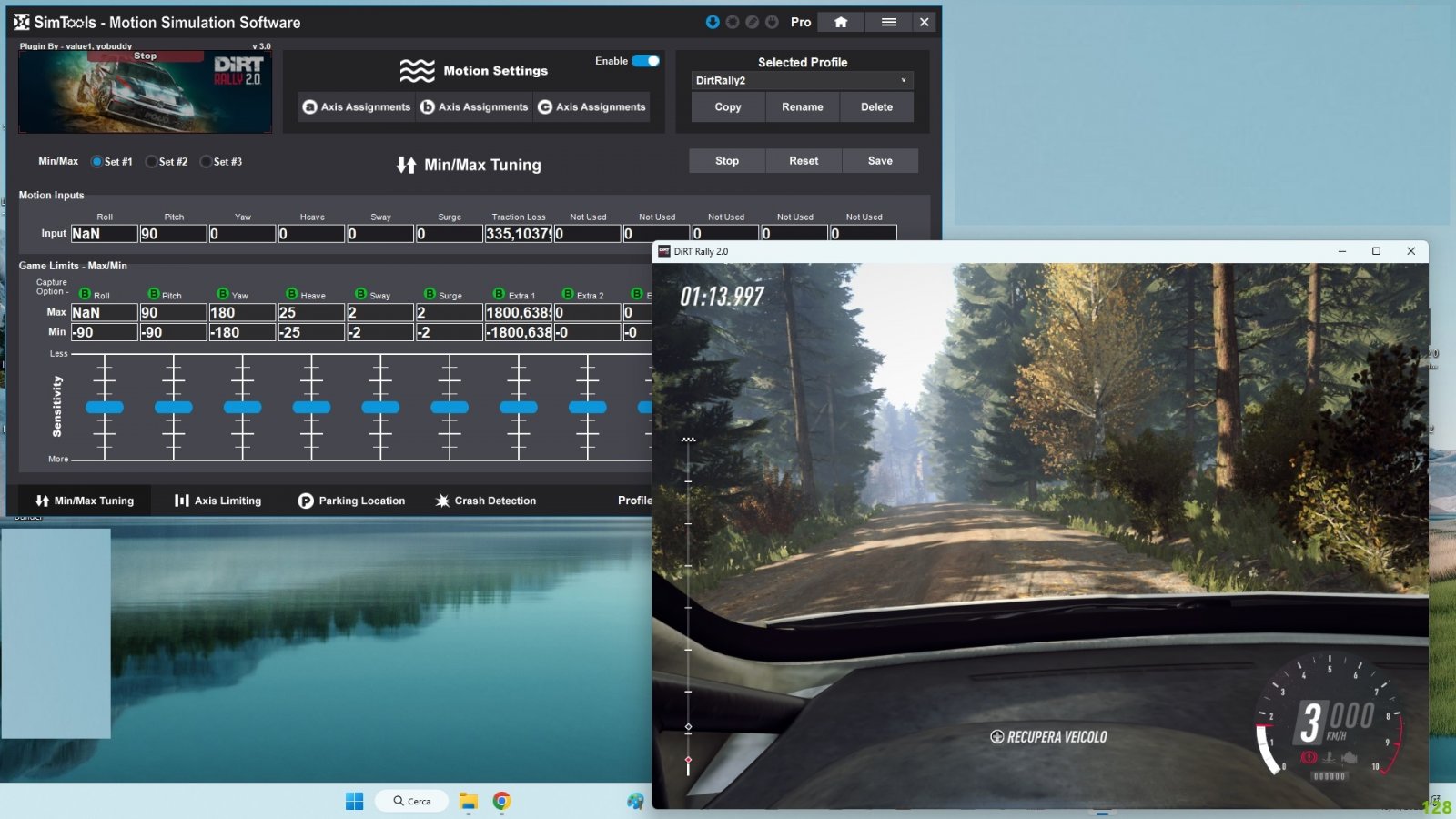

    Why does Roll Max have a non numerical setting?

    I try in testing and everything works but if I play nothing moves and in capture I find what you see in the picture and only the Traction Loss value moves.

    If I launch LFS instead everything works....

    I uninstalled v3 and reinstalled everything and now everything seems ok....

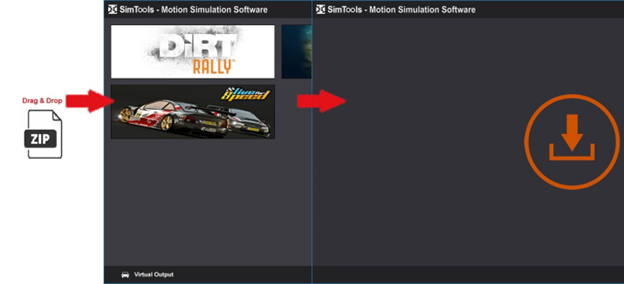

    You can't use v2 plugin in v3 unfortunately.
    And the v3 interface api is not out yet, but will be soon.
    But to answer your question, you can just drag and drop plugins into the main v3 gui.
