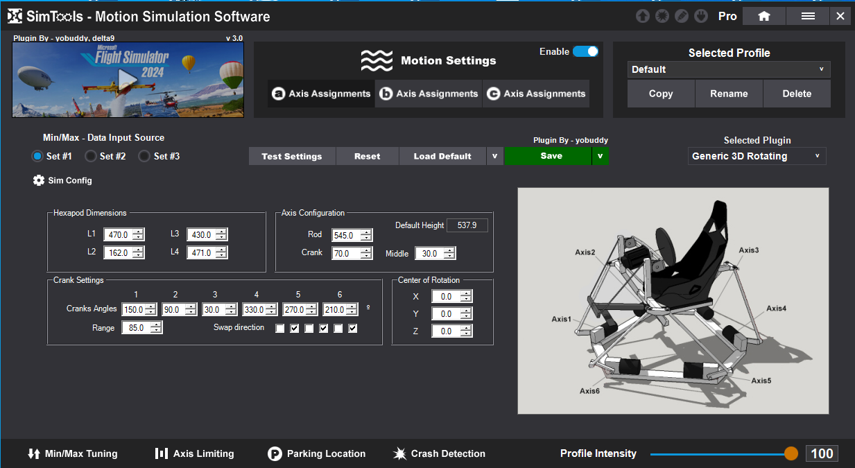

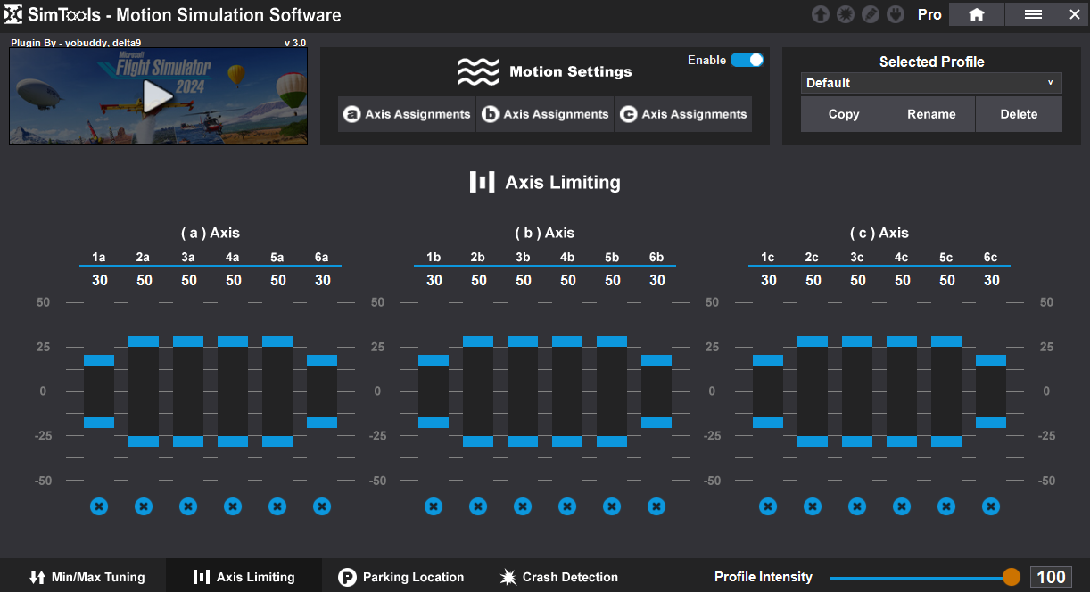

    Dear Flight SimTools V3 Users, asking for your expertise. SimTools V3, 6DOF Hexapod, FlightSimulator 40th anyversity (2022). 2x Arduino Uno R3, SMC Utils V1.0 Rotary actuators
    Testing within SimTools V3 (Virtual) all looks al right, when controlled by Flightsim 2024 movements are not okay. E.g. Pitch is just the otherway around (Also the Virtual picture is showing pitch just the wrong way around). I was expecting when all tests within SimTools 2024 (including the Virtual presentation) is okay then the controlling by Flightsim2024 must be also okay? I add couple of screen shots, for information. Also "Crank Angles" is me not clear what to enter there (left all default).
    Thanks for suggestions! Kind regards, Piet

    Hi @Pietbrok85,
    Crank angles are the direction the motors are pointing on the base frame. By default they all sit 60 deg from each other like in the pic below.
    I can help you with these settings, if you can show me a pic of your simulators base?
    If your motors are pointing in a triangle, then you probably want settings like this.

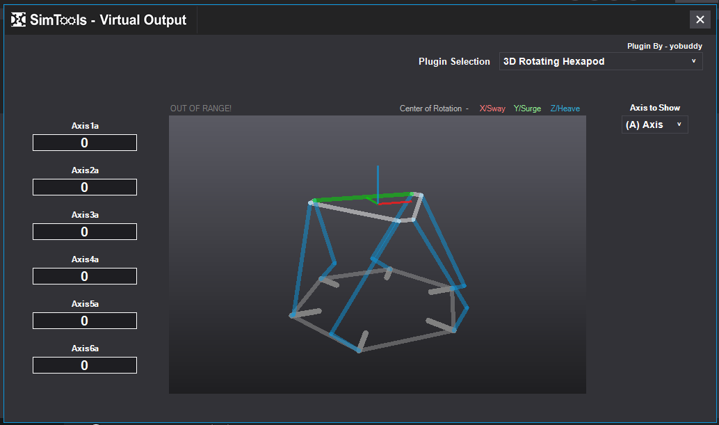

    (BTW - By looking at the virtual output, you can see the crank angles change position when adjusting the crank angle values.)
    Next, please adjust your Axis Limiting so all axis are using the same length. (as the math expects all axis to be the same length) I suggest setting them all to 90% if you need to use axis limiting (and you will have a 5% buffer on each end)
    There may be a couple of other things to look at, but lets fix these settings and we can work from there buddy.
    Chat soon!

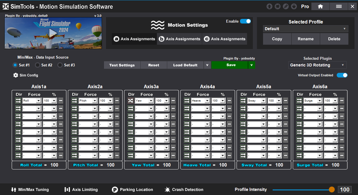

  9. yobuddy
    51,770Coins
    +5,206 / 19 / -0
    Be sure to update your number again, as they are still not quite right (try these)
    (Thou your motors point to the inside of the sim not out, so you may want to add 180 to all of the numbers.)
    Either way, you should only have 3 different numbers here total. (as you have your motors laid out in a triangle in the pic above)

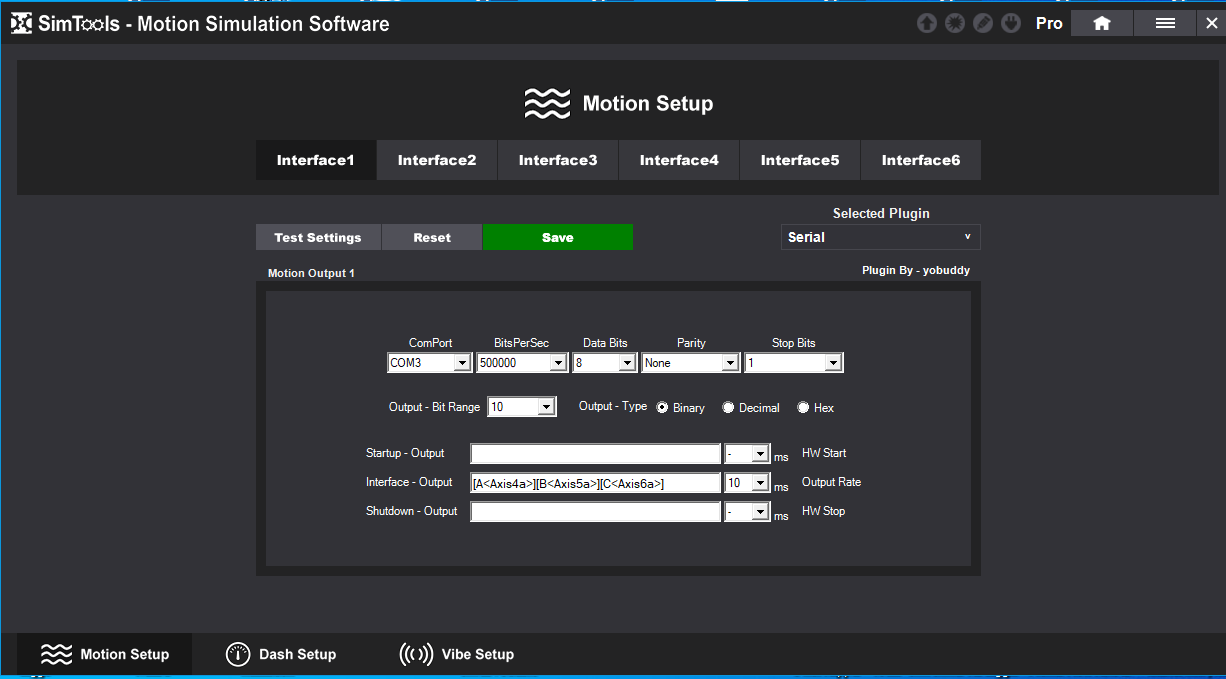

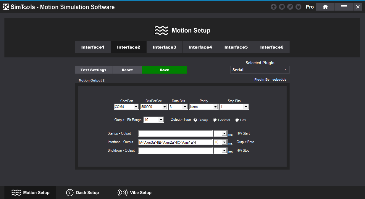

    You could always use 3 Arduino's and only use 2 channels on each Arduino.
    Make a shortcut for the game on your desktop, and then drag drop it onto the game plugins banner in SimTools v3. This will update the launch path for the game, maybe you installed a different version of the game, and its still trying to launch the old one?
    Lastly, have you gone into interface setup and verified that the output axis order is correct?
    Where axis1 is the front right and it goes clockwise from there. With axis2 being on the right the right, and axis3 is the back right and so on...
    Please let me know how it goes.

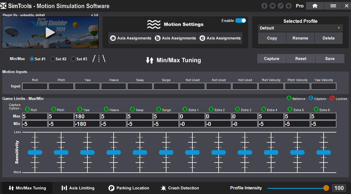

  10. Pietbrok85
    Pietbrok85 New Member
    Jan 16, 2025
    15
    Venlo
    53Coins
    Hello @yobuddy,
    Thanks for your help! For me all looks all right now (not yet perfect but workable).
    1) By dragging the shortcut into the banner it worked, flightsimulator programm is starting now.
    2) I have entered your advised values for crank angles, now my original problem (pitching down stead pitching up and visa versa seems to be solved with this action). Didn,t try the 180 degrees extra because it seems all right now.

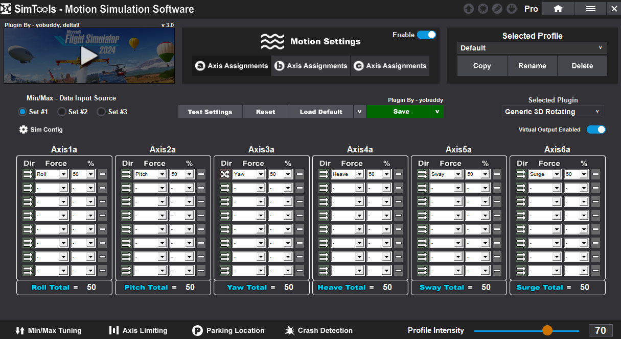

    Question for now is, how to give the good assignment for all axis (right now i have them all on 50% and that seems to work, screenshot see below) but maybe i have to put something in vertically. System what to enter there is not clear to me. Thx for any advice on this.

  13. yobuddy
    51,770Coins
    +5,206 / 19 / -0
    You can adjust the settings to your liking, but you need to use the Virtual plugin so you can see when the sim is out of range. You want settings that are impossible for the sim to go out of range. To much yaw can cause the sim to go out or range easier that other dof's. so I would lower yaw a bit, and increase surge and sway for a racing games anyway.
    If you do not go out of range with the settings you have now. I would give them a go first to see what you may want to change.
