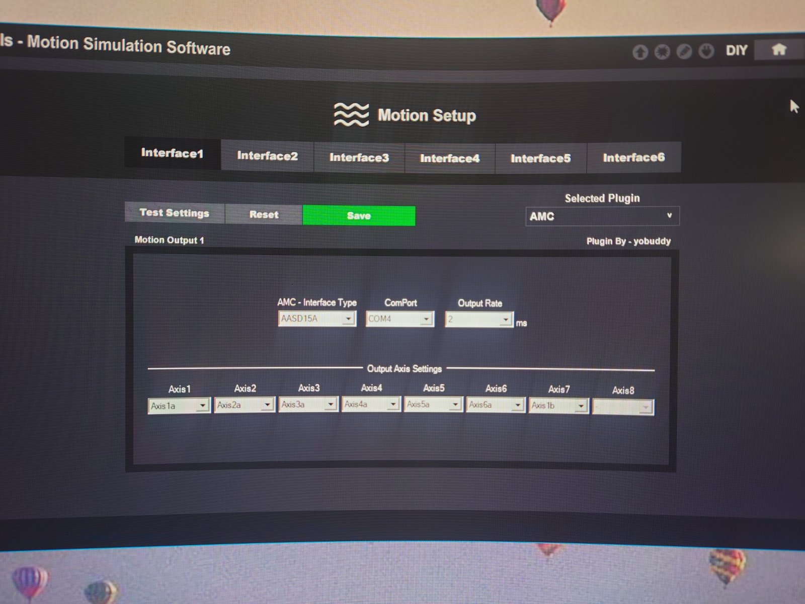

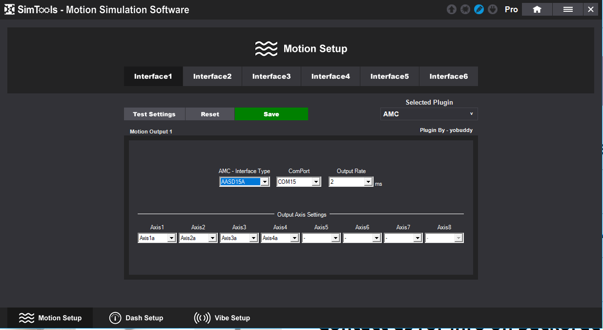

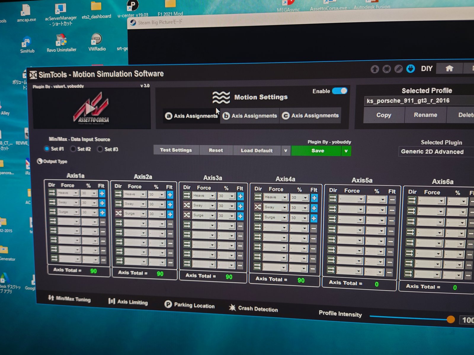

    2DOF, SCN6
    Hello. I was enjoying the simulator with simtools3 and Thanos. I changed my computer and now the simulator doesn't work with simtools. The simulator works with simhub. I have uninstalled SIMtools3 several times but it still didn't work.I have uninstalled SIMtools3 several times but it still didn't work.The OS is Windows 11 24h2, the CPU is u7 265k and the motherboard is Intel Z 890.It didn't work with SIM Tools 2.5 either.There doesn't seem to be any communication between the Thanos controller and the SIM Tools.
    22,224
    154,813Coins
    +11,226 / 57 / -2
    First principles, if you have changed computers have your re-registered SimTools and reconfigured all settings, as the port allocation is likely different?

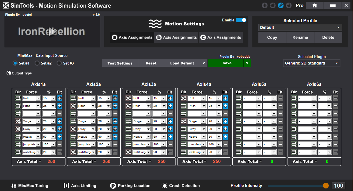

    Hey I'm new to SimTools and been trying to find an answer to this for the past couple days with no success, so hopefully someone here can help (and hopefully this is the correct place to ask).
    I'm working with a small dev team to add motion telemetry to their game, and while the telemetry outputs seem to be good, my motion rig is not moving at nearly the correct speed, it feels as if the profile intensity is turned way down even though it's at 100%. Is there a setting I'm missing that controls overall motion speed? My rig can definitely move significantly faster when I use SimHub, but that software has no 3rd party/modded plugin support.
    The input ranges are all set correctly compared to the telemetry output I believe, and even with smoothing at 0 it's still moving at like a 3rd of the speed it should be, making snappy motions super delayed and weak feeling.
    Any help would be greatly appreciated, maybe I'm just not seeing an obvious setting or something.

    There seem to me to be 2 issues here.
    The first is what a dev team needs to know to to add motion telemetry to their game, which I am sure @yobuddy would be happy to assist with when he has a spare moment, if more specific details could be provided, for now please see the FAQs: https://www.xsimulator.net/communit...ry-output-into-a-game-unity-and-ue4-code.287/
    The second is your own configuration issues. For that I suggest you post pictures of all of your settings, and also consult the v3 information in the FAQs: https://www.xsimulator.net/community/faq/simtools-v3.401/

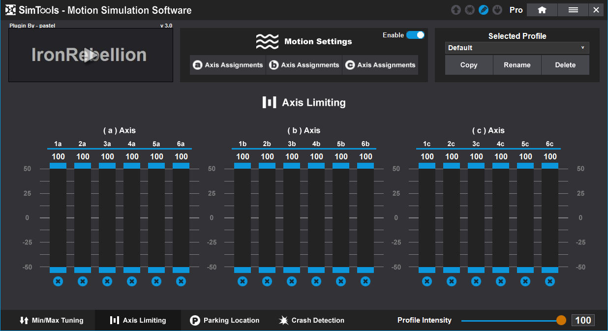

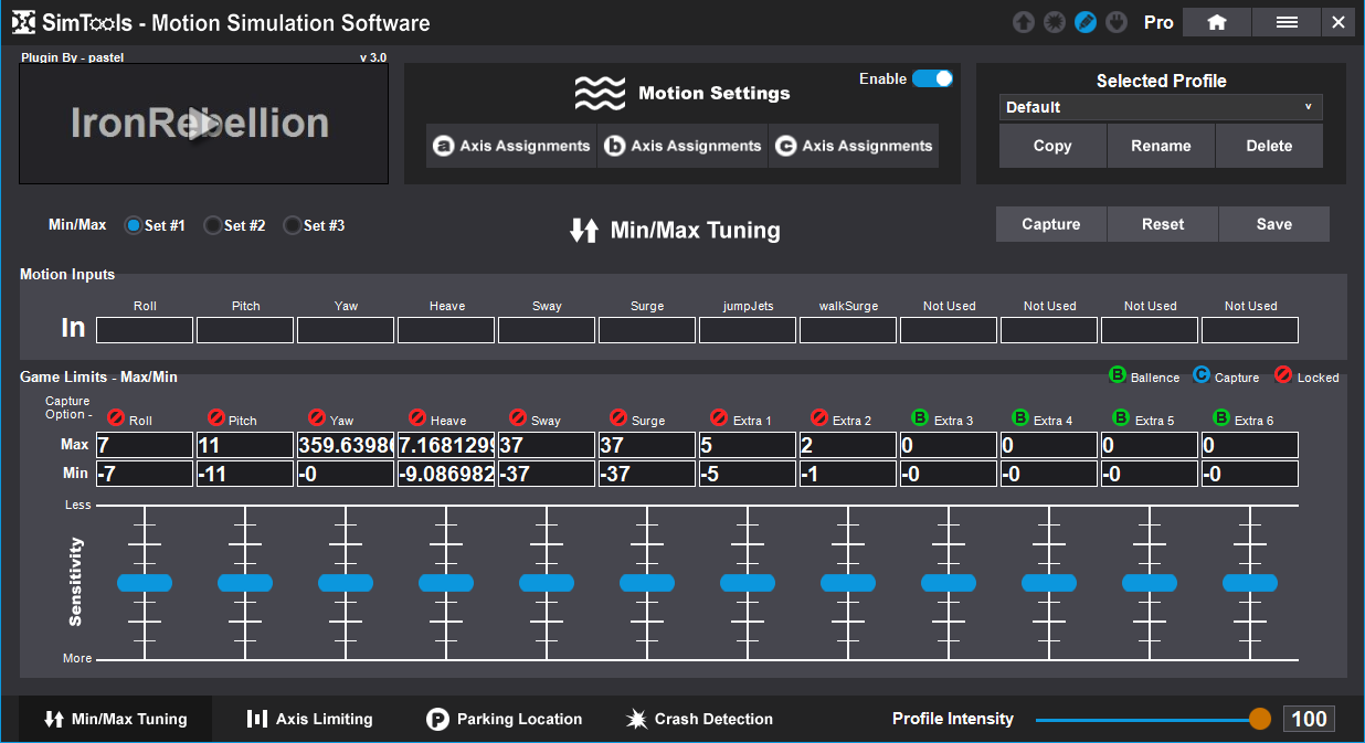

    Axis total is high as was testing some of the more conditional effects, no matter the number it is very slow though, looking at the telemetry output through the axis limiter shows the game is outputting at the full expected speed, the rig just isn't moving as fast as it should, like its got a ton of smoothing (max I'm using for normal effects is like 5% and deadzone of .2 to remove jitter)

    @ Im_awesome04,
    Are you using UDP relay? (Sometimes people accidentally return all packets to the plugins port itself and this can cause problems)
    It looks like your yaw input is going from 0 to 360. Please subtract 180 in the plugin for yaw, so the output for yaw goes from -180 to 180 from the plugin. This will allow yaw to work correctly.
    I have no idea what filters your using in your axis assignments, can you turn off all the filters?
    Feel free to PM me for more help.
    Chat soon :thumbs

  15. saiRyu

    271Coins
    2DOF, SCN6

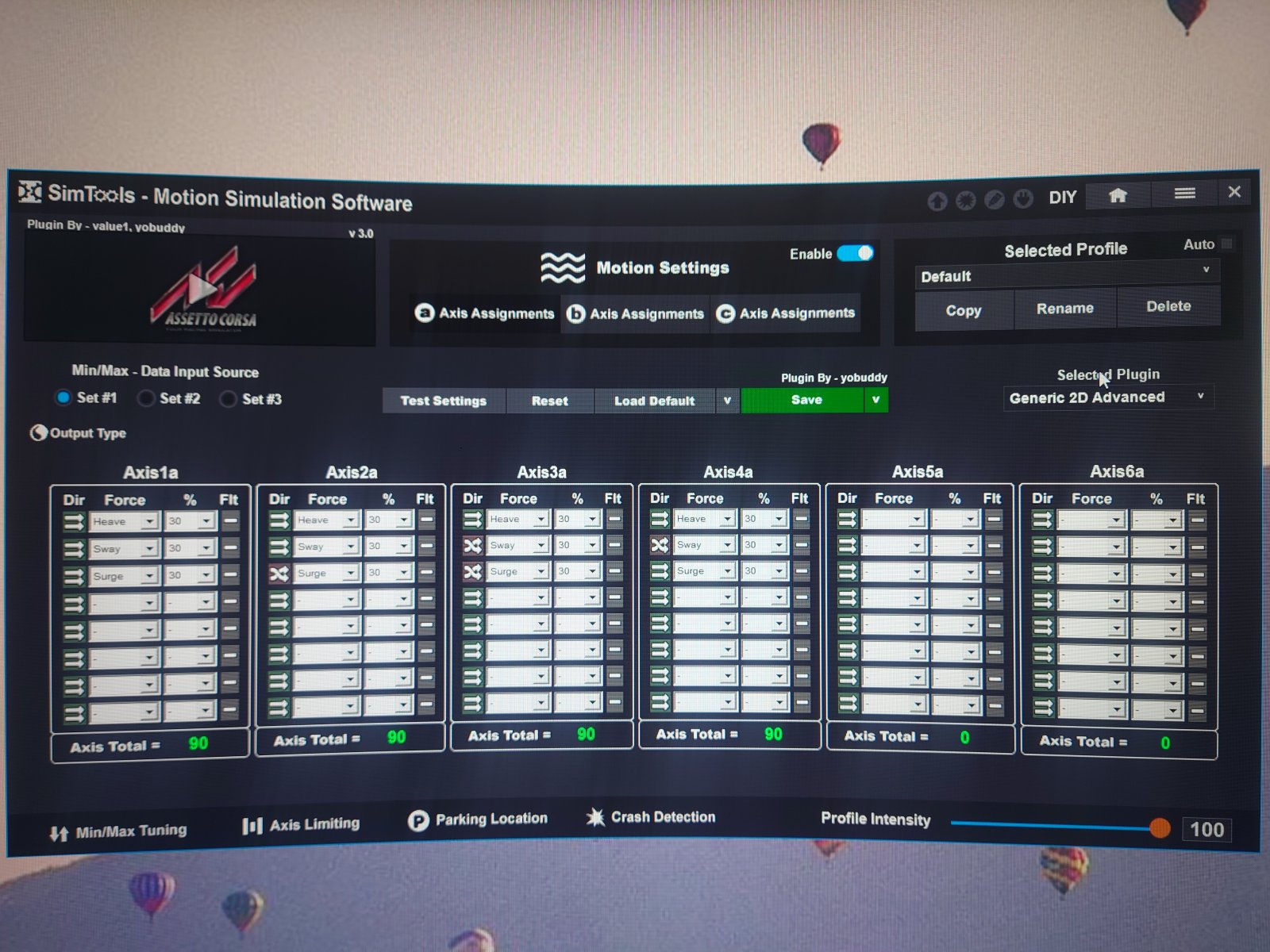

    I reinstalled and reconfigured simtools but it still doesn't work. When I click on test settings, Thanos connects but the actuator doesn't work.I am using a DIY license.

  16. yobuddy
    51,769Coins
    +5,206 / 19 / -0
    We don't have enough info to help you buddy. Can you show me a pic of the settings that do work? Are you testing the settings from the interface setup page?
  17. saiRyu
    saiRyu Member
    Jul 1, 2017
    32
    japan
    271Coins
    2DOF, SCN6
    The simtools and Thanos seem to be connected, but the actuators don't work.
    I am still using the license from my previous PC.

  18. yobuddy
    51,769Coins
    +5,206 / 19 / -0
    Can you show me a pic of the settings that work from thew old PC?
  19. saiRyu
    saiRyu Member
    Jul 1, 2017
    32
    japan
    271Coins
    2DOF, SCN6
    The PC I'm using now has a different motherboard, CPU, and storage, so I can't see the simtools set on the old PC. However, the simtools set on the new PC is the same.
  20. saiRyu
    saiRyu Member
    Jul 1, 2017
    32
    japan
    271Coins
    2DOF, SCN6
    I assembled an old PC. Simtools3 was able to move Thanos and the actuator on the old PC.
