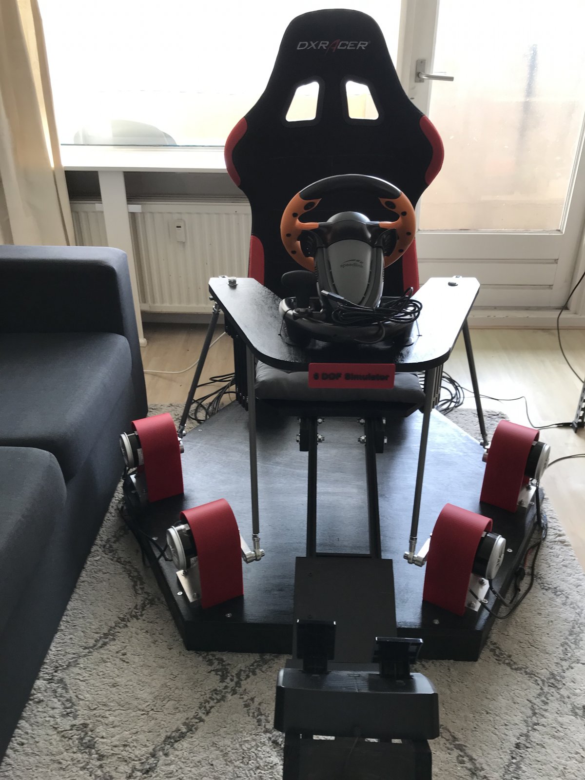

  2. Pietbrok85
    Pietbrok85 New Member
    Jan 16, 2025
    15
    Venlo
    53Coins
    Thanks a lot Yobuddy! I think i keep the centre of gravity in the centre, sitting a little behind the centre but the feet rest (peddals) are compensating for it. I have added a photo now. Kind regards, Piet (Netherlands) vooraanzicht met race stoel leuning.JPG

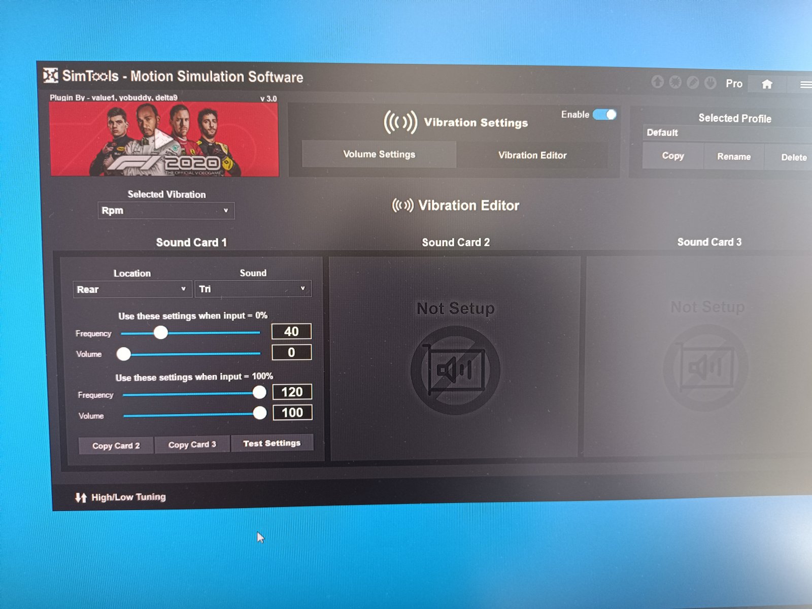

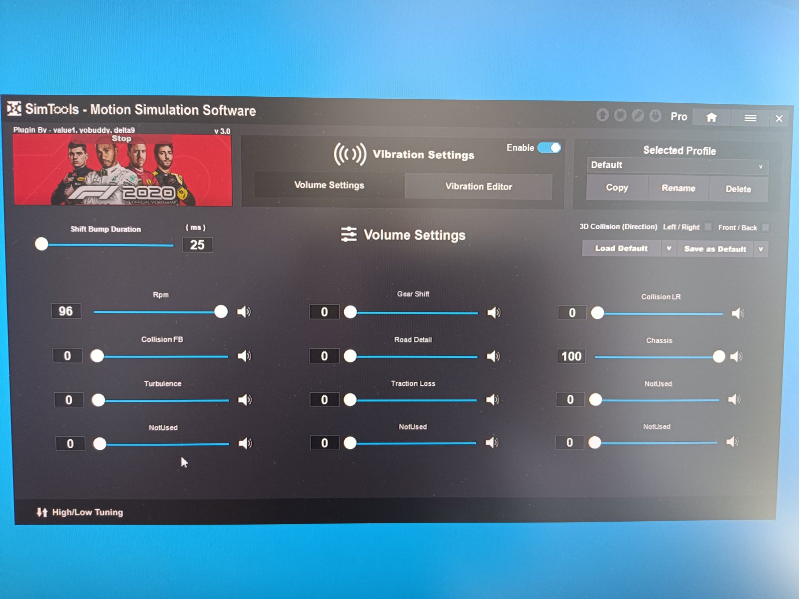

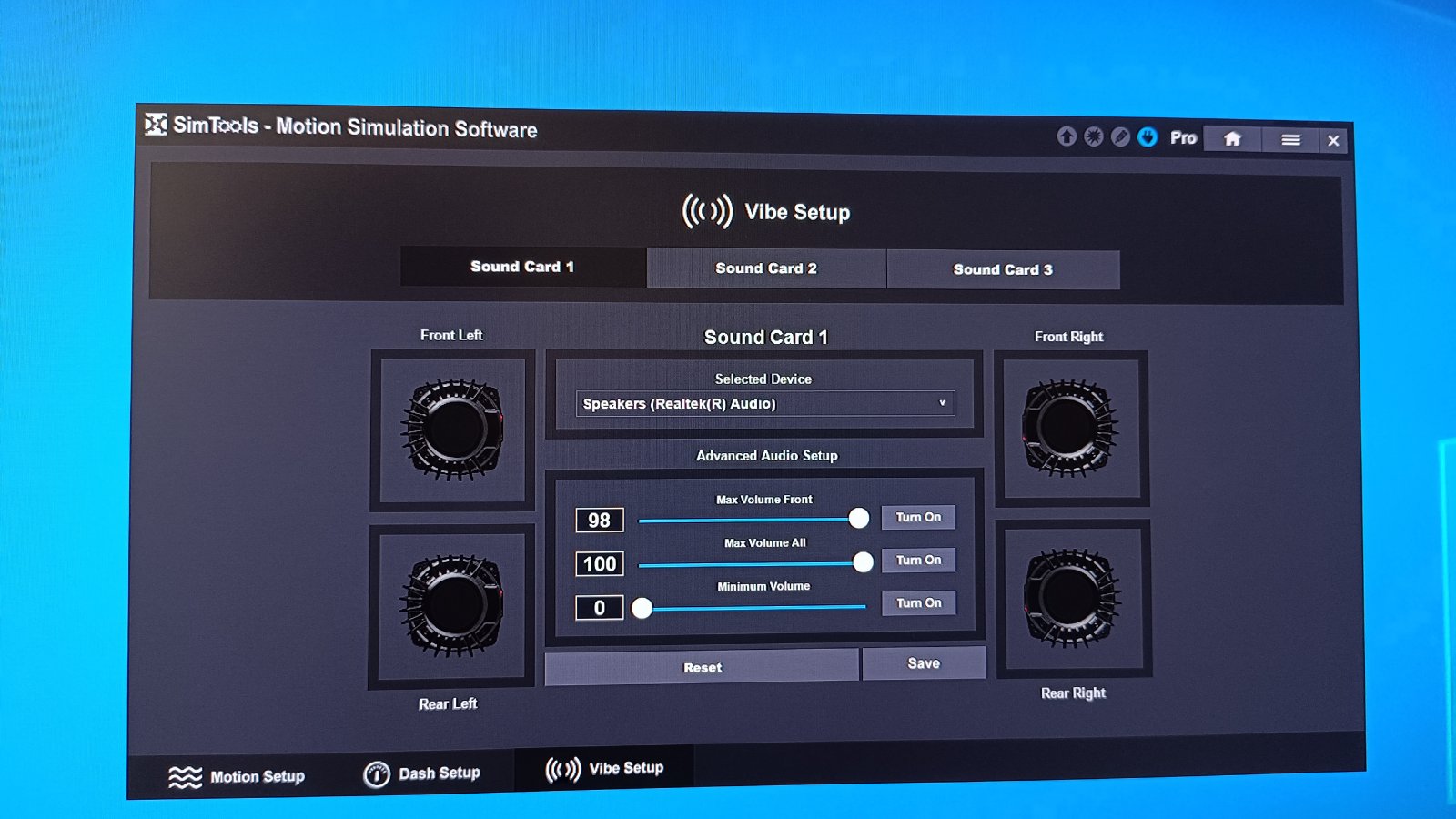

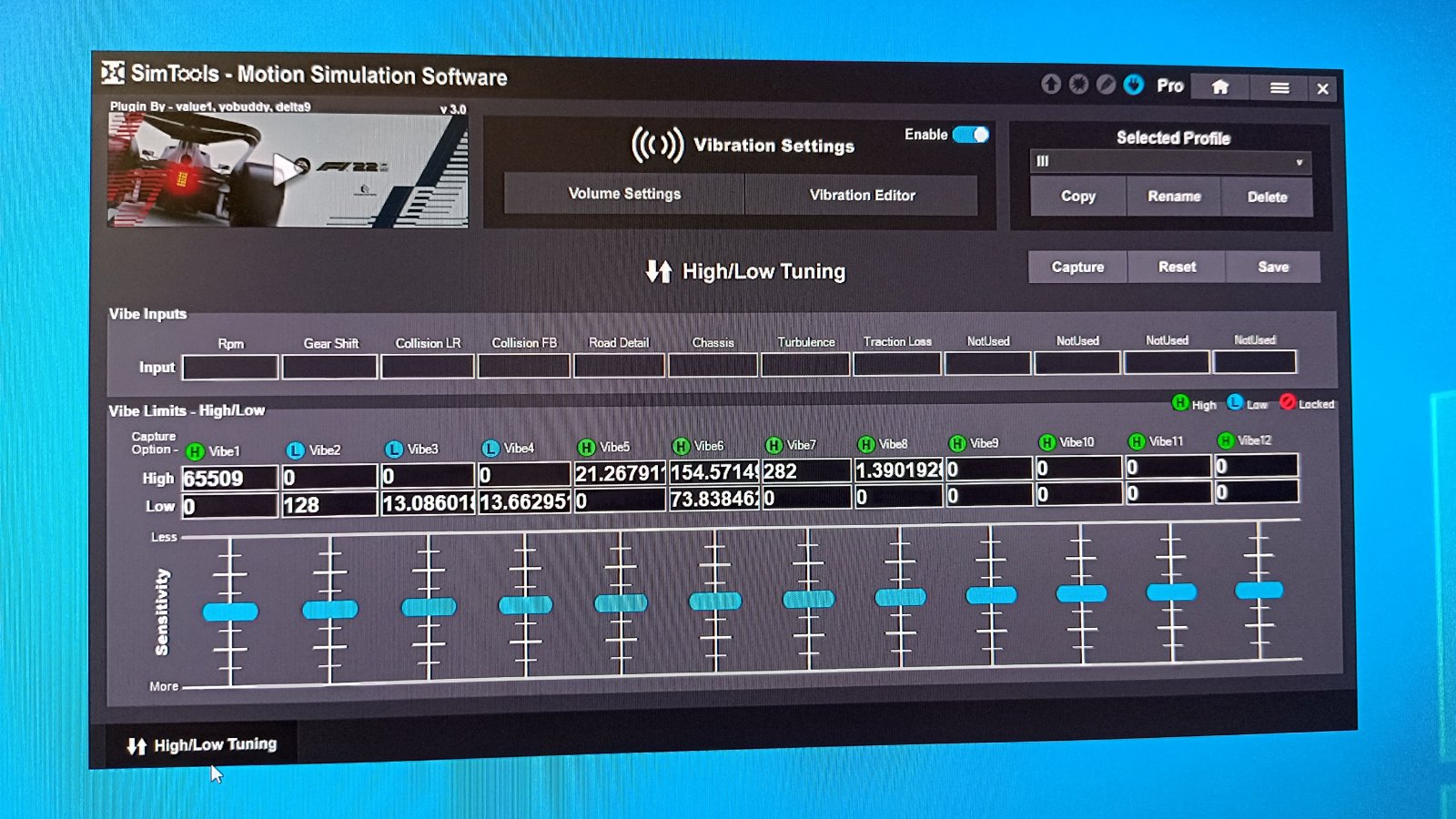

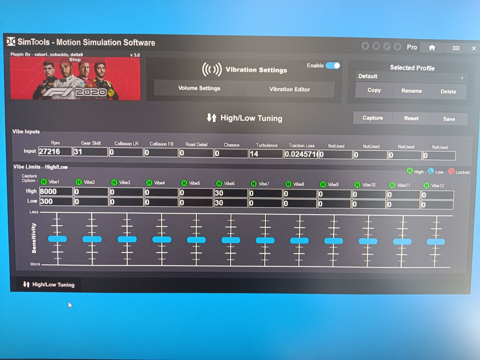

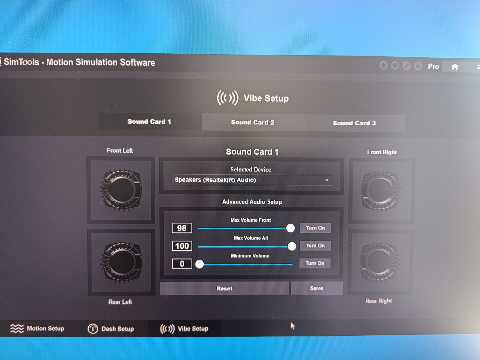

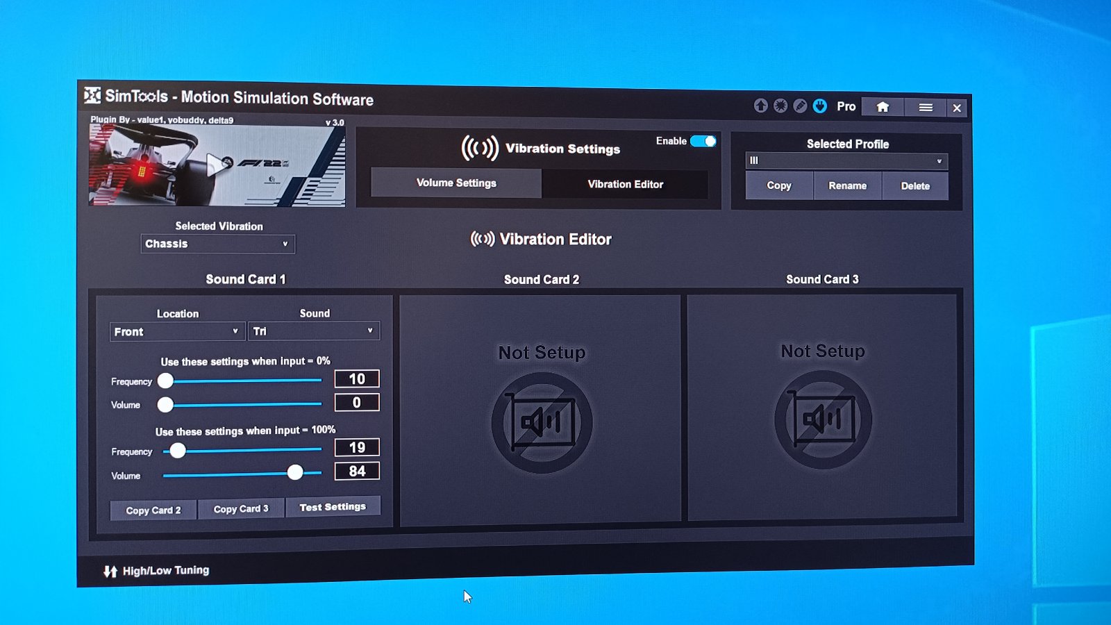

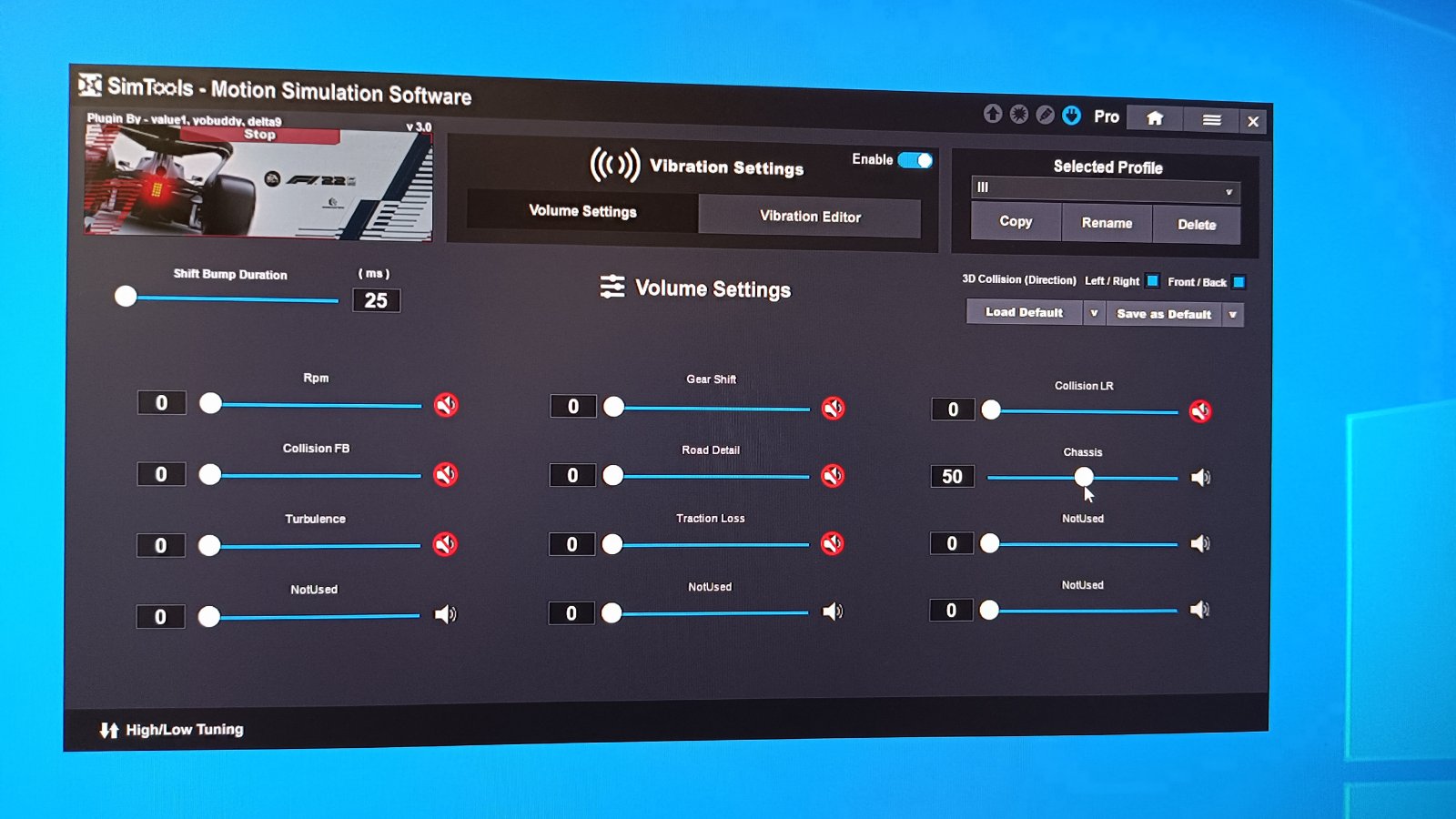

    Hello, I purchased vibe and set it up according to the examples, I attached an amplifier and a subwoofer (just for testing), but I can't get it to work properly, I'm also attaching screenshots, pls help,Where am I wrong?
  16. yobuddy
    51,769Coins
    +5,206 / 19 / -0
    Hi @FLORIN ROMANIA,
    The chassis vibe was created for 3d (4 speaker) feedback. So it could be that since you have it only playing on the front speakers could be the cause (Should the speaker you have setup be considered a back one). But most likely it's that the max/min values are to high. Maybe give a Max/Min of 30/-30 a try. Did you tested the output settings in the Vibration Editor section? (The Test Settings button)
    I would suggest starting with a easier vibe to setup thou, like RPM. For RPM, set min value of 300 or so, and a high value of 8000 or so. And then test the output settings in the Vibration Editor section and see if it works well while moving the slider back and forth.
    Chat soon!

    Ok I also tried the rpm with the given values, I hear a continuous sound, not the rpm sound at all, the sound only changes when I turn the steering wheel

  20. yobuddy
    51,769Coins
    +5,206 / 19 / -0
    Are you using a second sound card, not that same one used for the game audio?
    (As I have no idea how a steering wheel could override the rpm output from a game is all)
    Just a tip, you will probably find that the sin or saw wave will give a better rpm vibration.
    Anyway, please turn the volume for chassis off so we can isolate just RPM, and get it working before moving on to another vibe.
    I will take a look at this plugin on Monday, and make sure the data coming in for vibe is correct. As it looks like the rpm incoming number is way to high.
