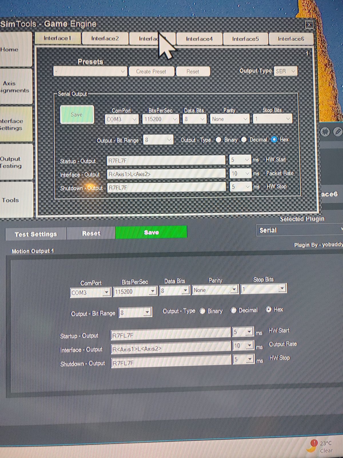

    So I've been using v1.2 for a long time. But wanted to upgrade to v3. However after downloading the demo of both v3 and live4speed to test with, as well as all required plugins. I have run into an issue.
    I use the server interface and copied the setup from my v1.2
    Then set up just a pitch dof with only 25 % force and 25 boundary to play it safe.
    With the power off I downloaded the slider plugin to check the virtual axis. When it looked good I powered on the seat. Once I hit the test button my seat goes all the way forward and tries to pass my physical safety stops.
    I exited v3 and tried the seat again using v1.2 to rule a seat problem out however it operates as it should so that leads me to believe I am doing something wrong or the program has a fundental difference in the interface setting.
    What might it be?

    Please post pictures of your Interface Settings, as the format has changed long ago.

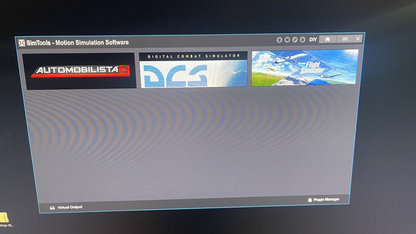

    Appolgies for sounding a bit dense
    Cannot get this to work
    Simtools v3. New install new PC etc
    All ok at Simtools v3 startup scn6 actuators move etc & now fine under testing
    Simtools v3 downloaded the msfs2020 within Simtools v3 plugins selection
    The mafs2029 plug in clicked twice does start mafs2020 but zero motion
    I’ve assigned basic axis pitch roll now turned up but zero movement
    msfs2020 does run motion when I try using sim commander software so it does output but sim commander not great for flight sims
    any ideas of how to get it to work ?

    Has anyone got msfs2020 to work with Simtools 3 ????
  11. yobuddy
    51,770Coins
    +5,206 / 19 / -0
    We have collected all the parts we need for the project, and have tested a few things too. We hope to get a working version out this fall.
    This usually comes down to the version of Sim-connect your using. My guess is Sim Commander uses a different version is all. Please check your add/remove files in windows to see how many versions you have installed.

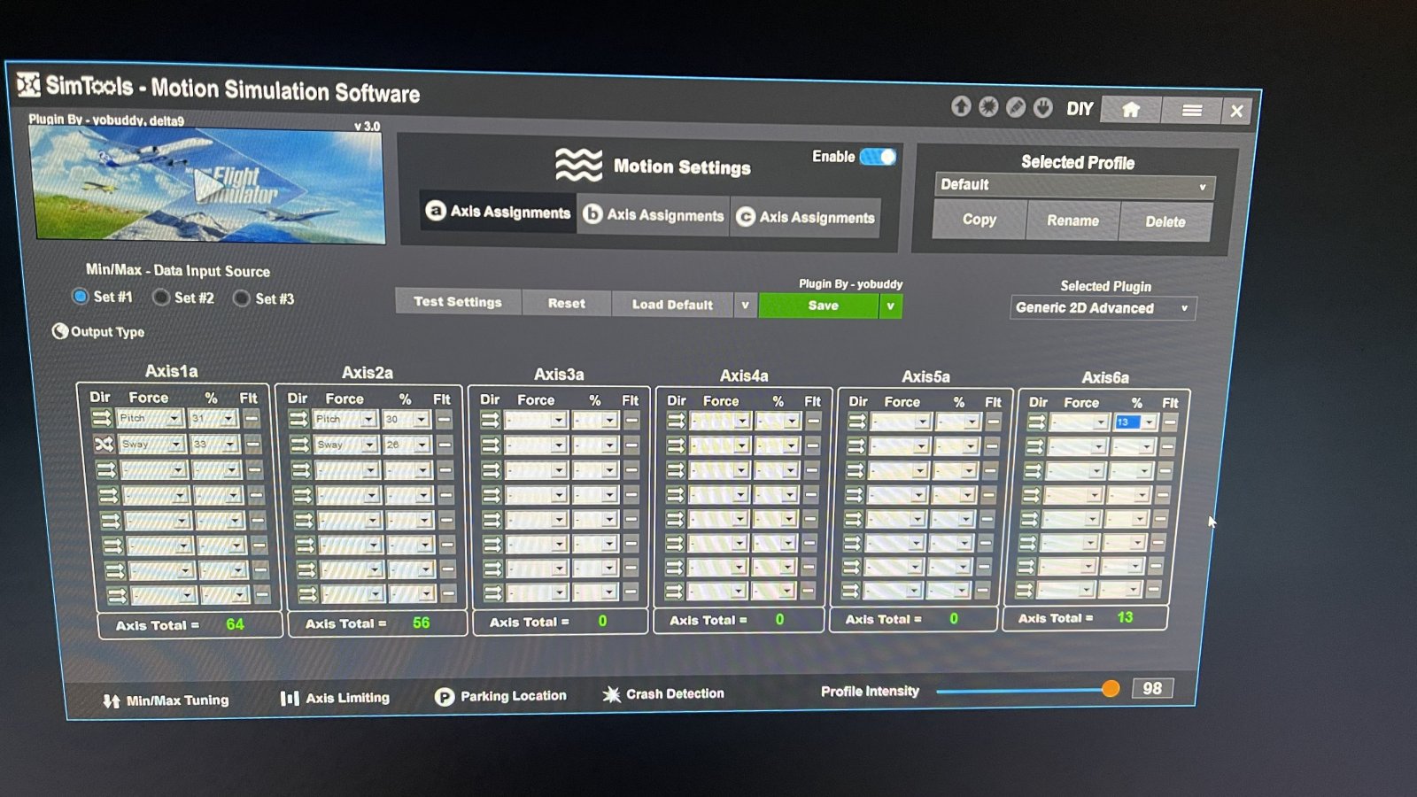

    just tried it with ams2 , simtools not receiving input from the games
    all the motion works when i test actutors and adjust park postions etc
    yes i put in some pitch roll etc into the first 2 axis, the ones that are working and simetools 3 activate at start up
    simetools 3 successfully starts the game from pressing the plugin twice etc
    is there something I've missed out???????????????????????????????????????????????????????????????????

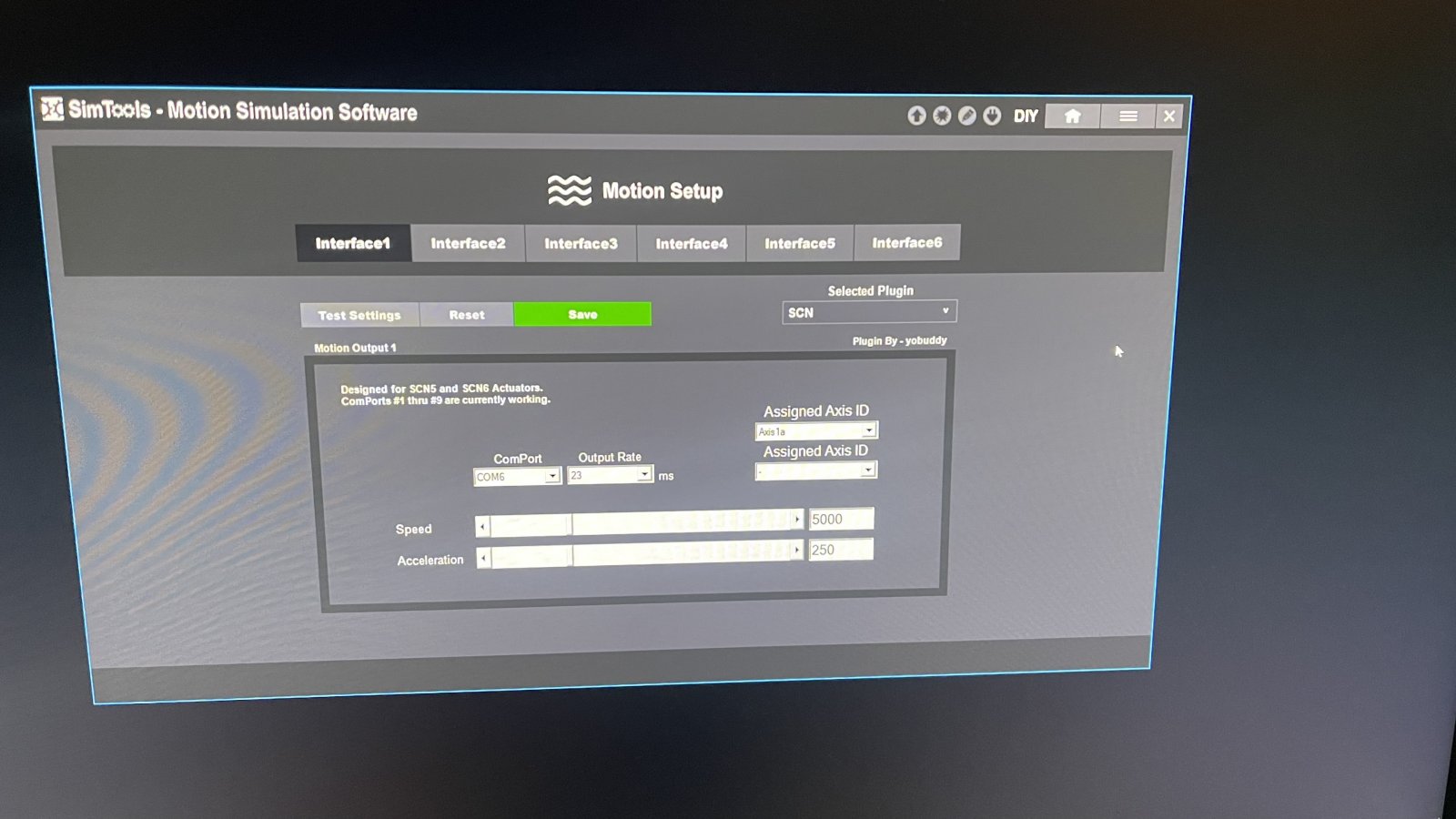

    Here
    massive thanks for reply
    interface one ( com 6 ) axis 1a
    Interface two (com 5 ) axis 2a
    bott work nicely at startup
    +on the test mode they move no probs
    zero movement in game
    Simtools 3 boots up/starts the game no problem , tested with msfs2020 & ams2
    Both completely dead motion
    frustrating
    Any suggestions appreciated

    I suggest turning the speed and acceleration on the interface config all the way up while your setting up the rig, and setting the output rate to 1. The last thing to check for is what the min/max settings look like for ams2. (If for any reason the min/max values got zeroed out for the plugin, then there will be no motion)

    nope none of things worked
    I tried output of 1 on each axis then 2 , 3 , 4 , 10
    the min max I fiddled and put different figures in
    nothing shows in those “input” boxes above isn’t that a life feed from the sim ?
    I pressed capture too but nothing showed in those boxes , all whilst msfs2020 was running with a plane flying
    zero movement
    there’s nothing coming from each sim
    I know my setup works with everything including ams2 & mafs2020 using sim commander software so I know not a hardware or connection to pc issue
    Is my somehow blocking the feed from sim to Simtools 3 ?

    AMS2 now working
    my problem is msfs2020 specific
    Zero feed to motion )-:
