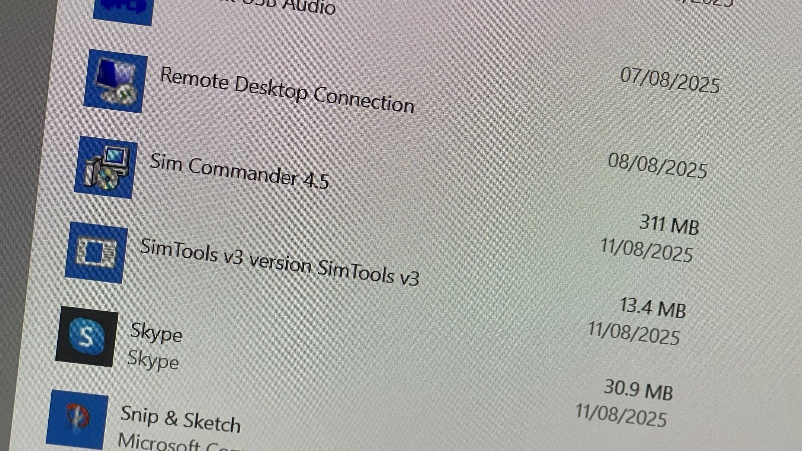

    i gave up on MSFS2020 with Simtools 3
    Purchased msfs2024 & downloaded that plugin ( through Simtools 3 interface)
    no motion from that either , as with 2020 it launches msfs2024 fine & switches it’s self off when i shut down the sim
    ( i make sure basic movements in my working axis were saved )
    “sim-connect “ did a search of folders / apps & couldn’t find anything called sim-connect
    Is it something i must install ?
    Pic included of what motion software installed

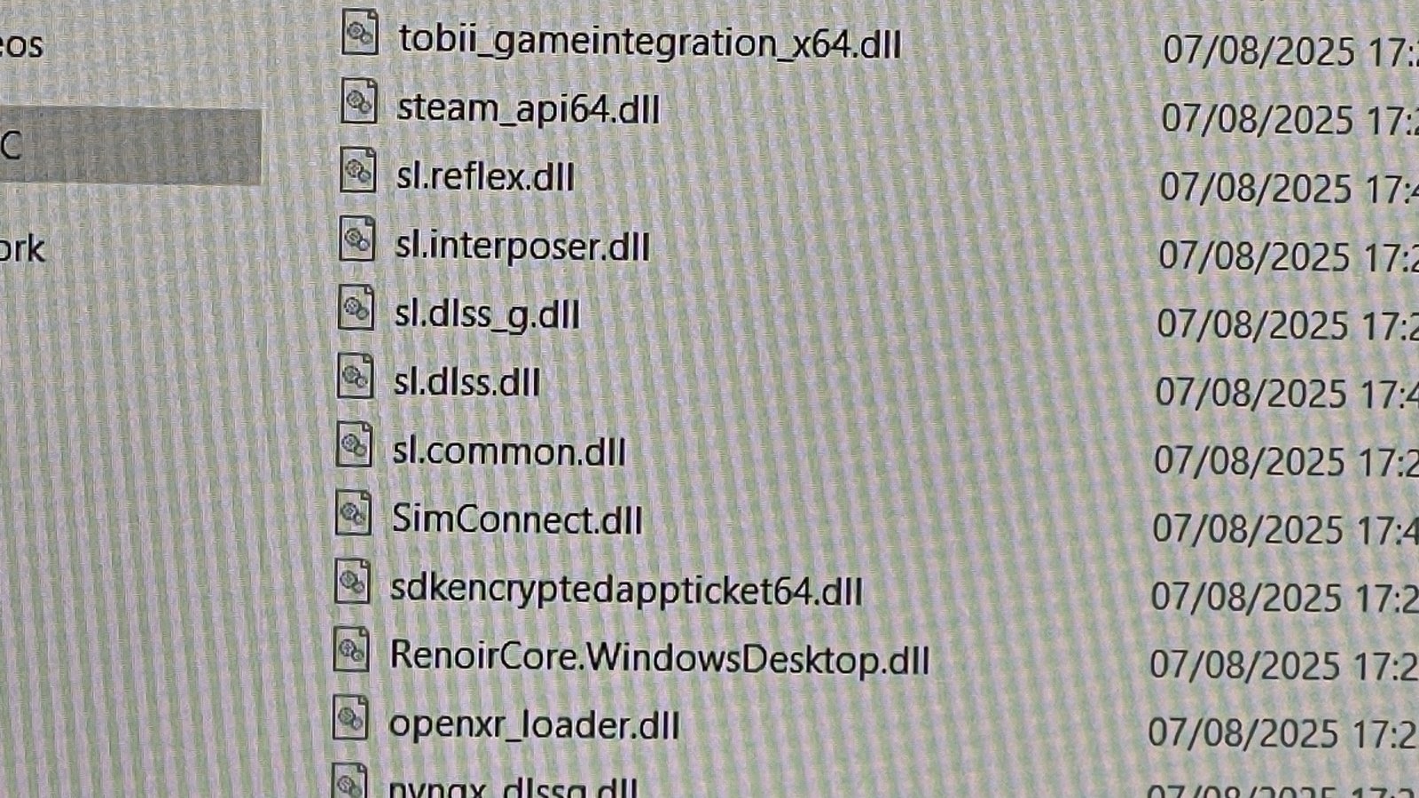

    found this file , only one
    In MSFS2024 folder
    A simconnect file is in there
  4. yobuddy
    51,770Coins
    +5,206 / 19 / -0
    Install this file and you should be good to go.

    GOSH !!!!!that did the trick!
    its like a magical miracle
    massive thanks for the support yobuddy

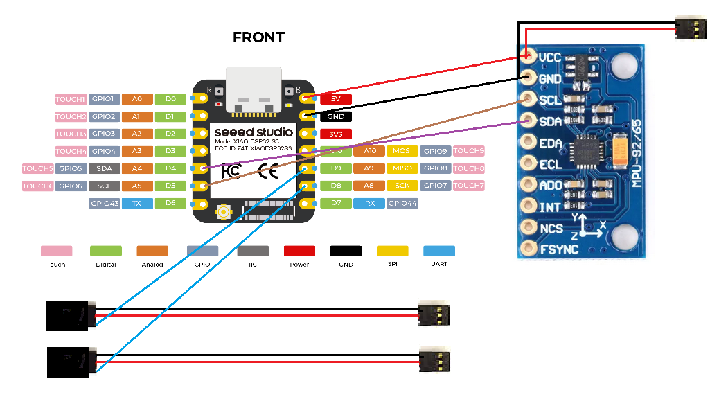

    Really keen on doing something like this on my drone, jut mounting an imu to base with ardunio rc transmitter to pc arduino but dont know where the data goes just wondering if there is a game patch or anything for it? maybe a tutorial? still a bit of a novice with this side of things
  9. yobuddy
    51,770Coins
    +5,206 / 19 / -0
    Eventually I will write a small app the brings the telemetry to the PC (from the Arduino), and then write a game plugin around this small app to deliver the data to SimTools.
