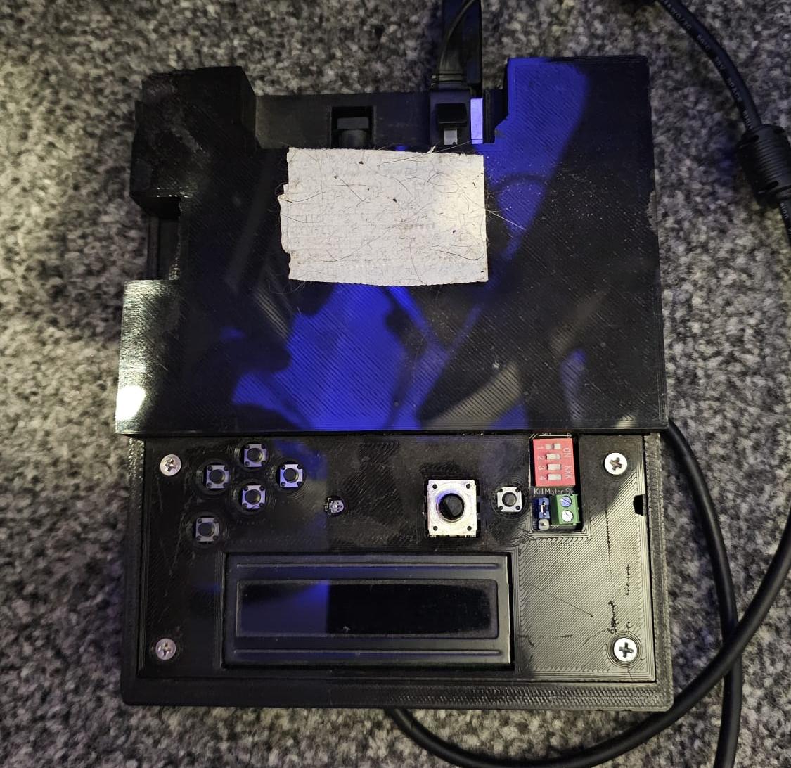

    Here is a picture of the one I have. I do not know the exact marking.

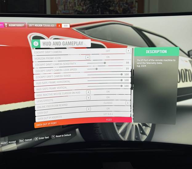

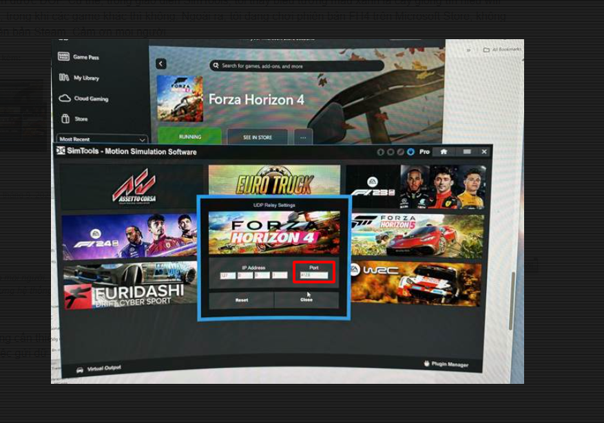

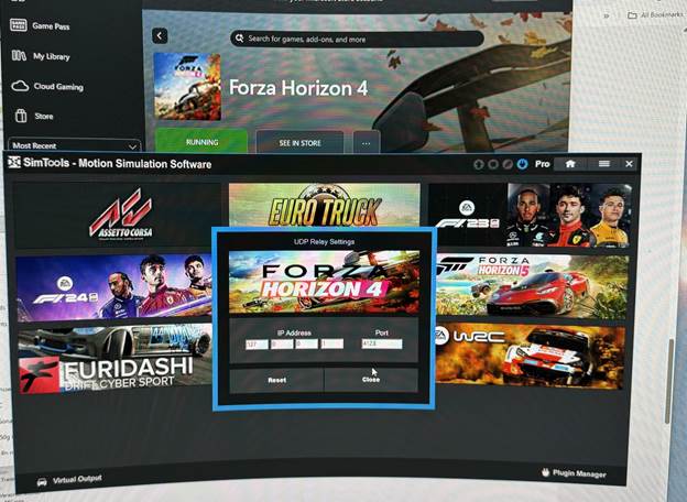

    Hello everyone, I'm having a problem connecting SimTool v3 to the game Forza Horizon 4. I've already set up the port, but my simulator rig is not working. Other games work and function normally. Please help me
    NOTE: Currently, all the other games I have installed are working normally, except for Forza Horizon 4 which isn't recognizing DOF. Specifically, in the SimTools interface, I see a green wifi-signal-like icon for FH4, which is not the case for other games. Additionally, I am playing the Microsoft Store version of FH4, not the Steam version. Thanks, everyone

    You don't need the UDP Relay set up at all, unless you need to send a copy of the games data to other software. Know that sending the data back to 4123 will create a endless loop. Please remove the UDP relay and give it a go.

    Hello, should I delete the current plugin and reinstall it? After installation, should I test it in the game right away without needing to add any information in the port section on SimTool?
  16. yobuddy
    51,767Coins
    +5,206 / 19 / -0
    You will not want to use the port relay settings for the game, please click reset and close the UDP relaying form.
    Take a look at the data page for the plugin, as it shows some in game settings that need to be done.
    https://simtools.us/plugin/?varname=388&color=0e97dd
    Please let me know how it goes!

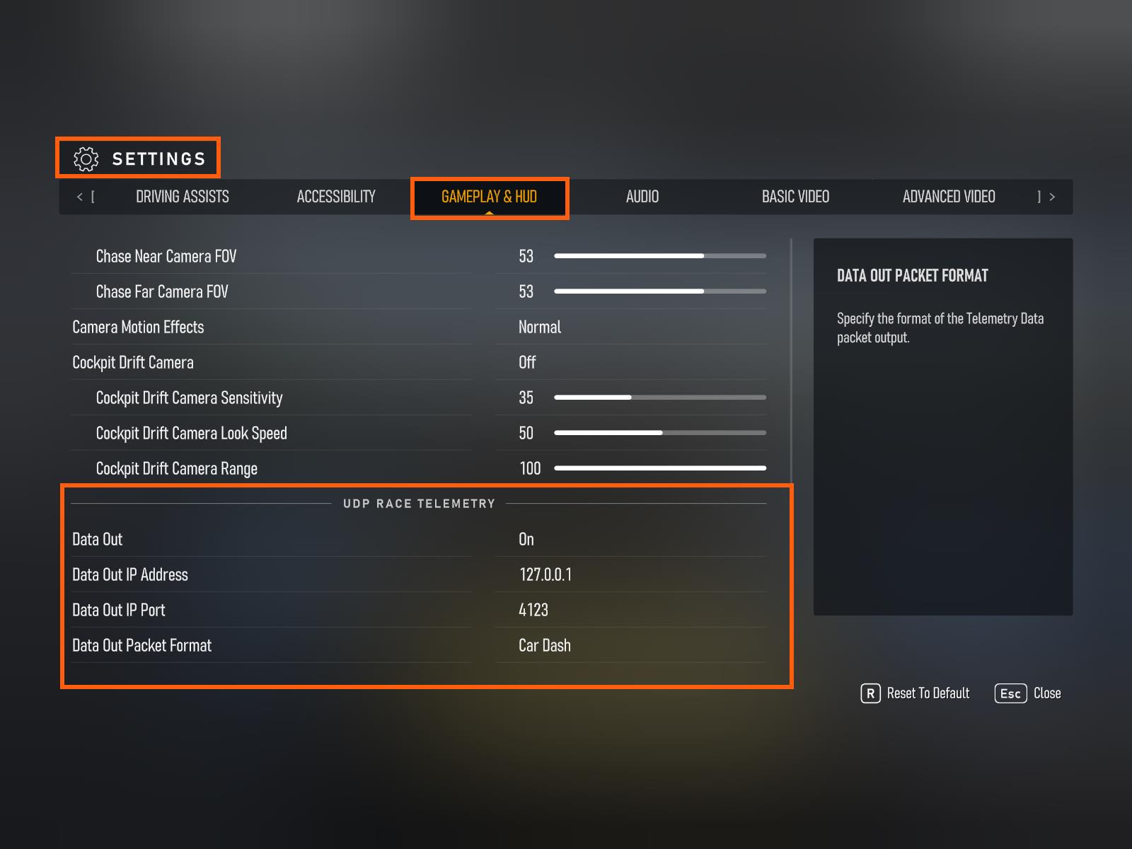

    Hi, I wanted to ask. I currently have Forza Motorsport, and the 2DOF simulator movements don't match the car... it jerks around for no reason. However, I have the same settings in F1 2024 and Aseto Corsa, and they work fine.
    I have the settings in SimTools v3, where I move the axes, and they work fine, but they don't work in the game. Has something similar happened to you?
    thanks
  20. noorbeast
    22,219
    154,783Coins
    +11,217 / 57 / -2
    Has the required in-game settings been made:
