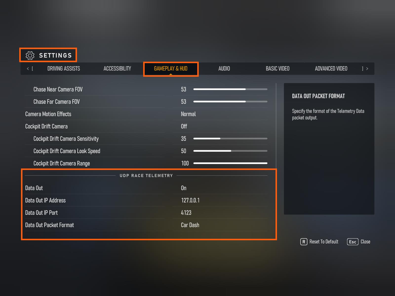

    Hi, yes, I do have it in the settings. It turns out that it moves, but poorly, and the movements don't match the car's movement.
    However, in F1 and Aseto, it works fine.

    Please post pictures of all of your settings, including the tuning center while the game is running.

    Hello, in v3 the plugins are free. You install them directly from the repository. Remember to do a race and finish it before installing the plugin on the F1s.
    Yes, enter the port and IP address too.
