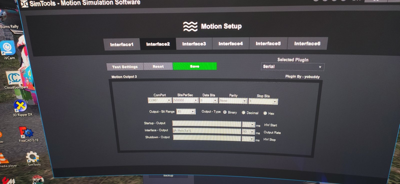

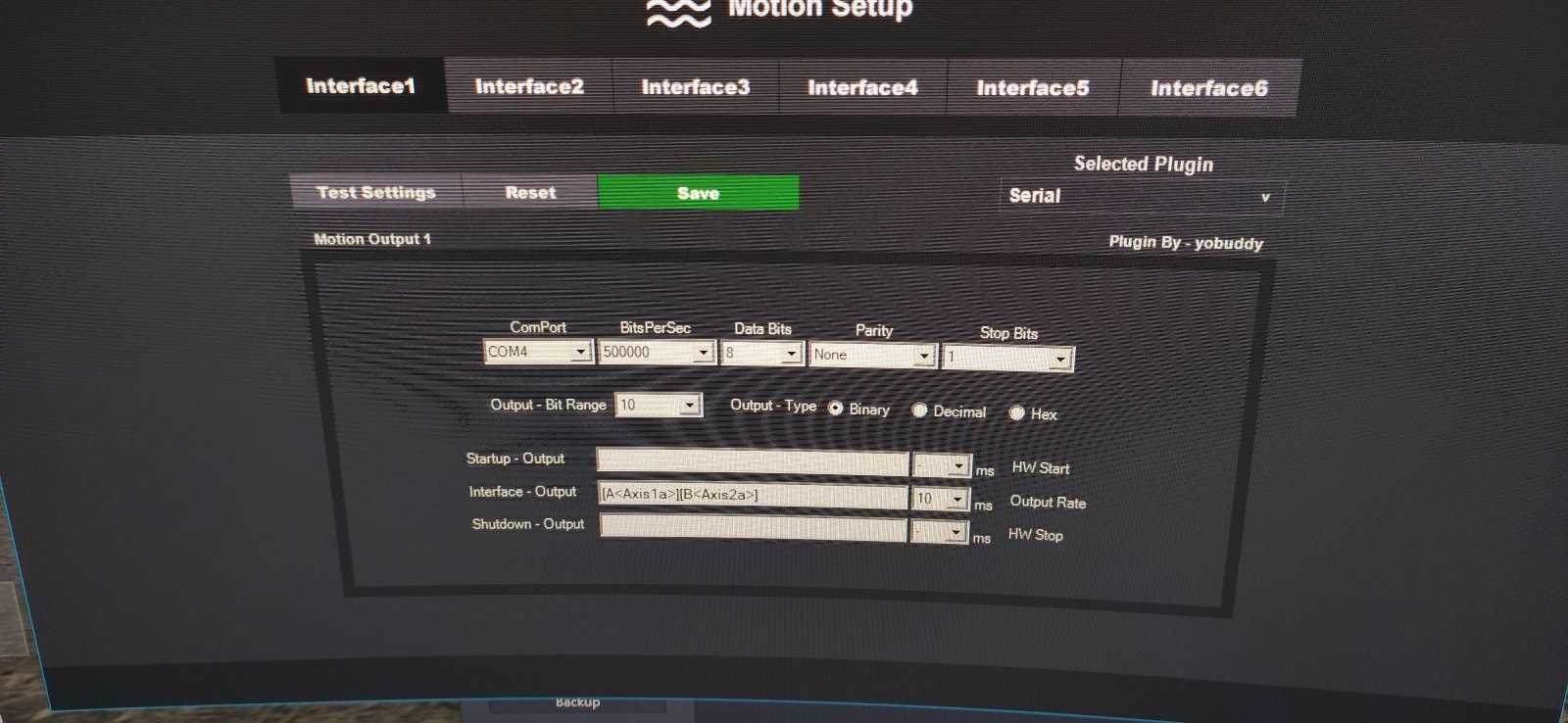

    I post a new video in wich you can see that I turn on test only one 1x and simtools crash
  7. yobuddy
    51,780Coins
    +5,206 / 19 / -0
    @gigi,
    May I see your interface settings for vibe, your sound card setup.
    Just trying to figure out where to look is all.

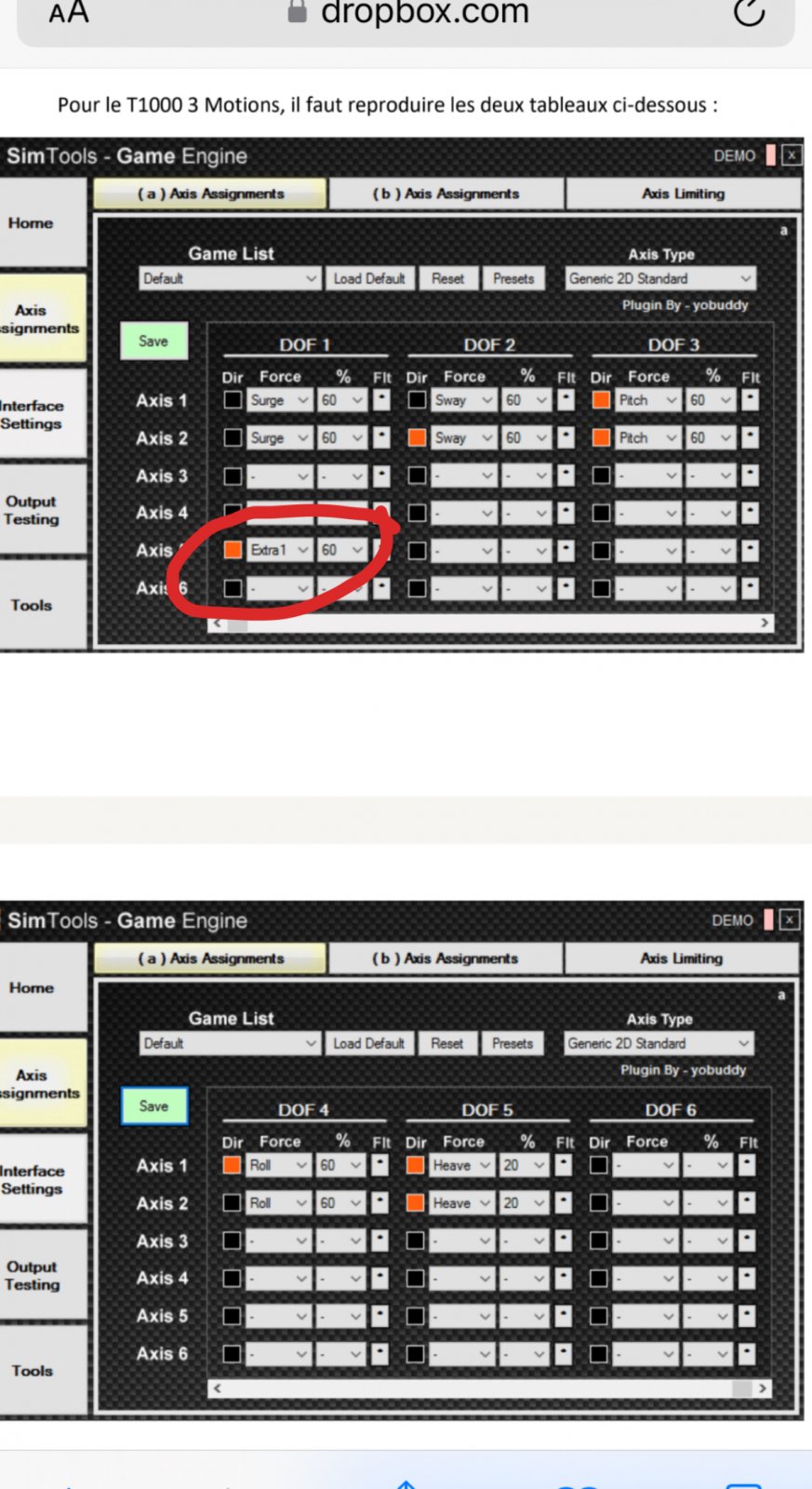

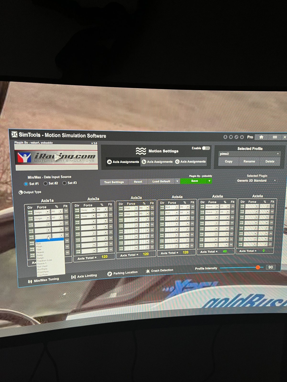

    hello i have a problem with the v3 version, i have a prosimu t1000 3m, with the old simtools v2 version i had to set the 3rd jack to extra1 but i can't find it in the v3 version? moreover the cylinders do not work correctly in the game
    barely moves 5% to 10% of the stroke?
  19. yobuddy
    51,780Coins
    +5,206 / 19 / -0
    Traction Loss is Extra1 in v2 and v3 for iRacing.
    Have you tuned in the max/min settings for the game?
    Take care,

    +74 / 0 / -0
    Hi. I found a time to complete the belt tensiiner and I continue to have a problem with sim tools 3 turning off ,when I have 2 interfaces. It shuts down despite whether one is unplugged or both are plugged in. It shuts down in every game. But when I give the interface test it works. When I give a test in a game plugin it shuts down. In sim tools 2 work normally side by side. I do not enable Smc3Utils. Any ideas what to check? I was also disappointed that only in rbr again os surge works weird. In Dirt rally or assetto all is smooth and once set it works great and in rbr it works as if the signal is truncated. I only have the smooth filter at 15 percent. When I fight capture max min it works great. When I save the parameters it works as if the parameter is too high, making the motion too weak. When I lower the parameter manually it is still not the same when I turn on capture
