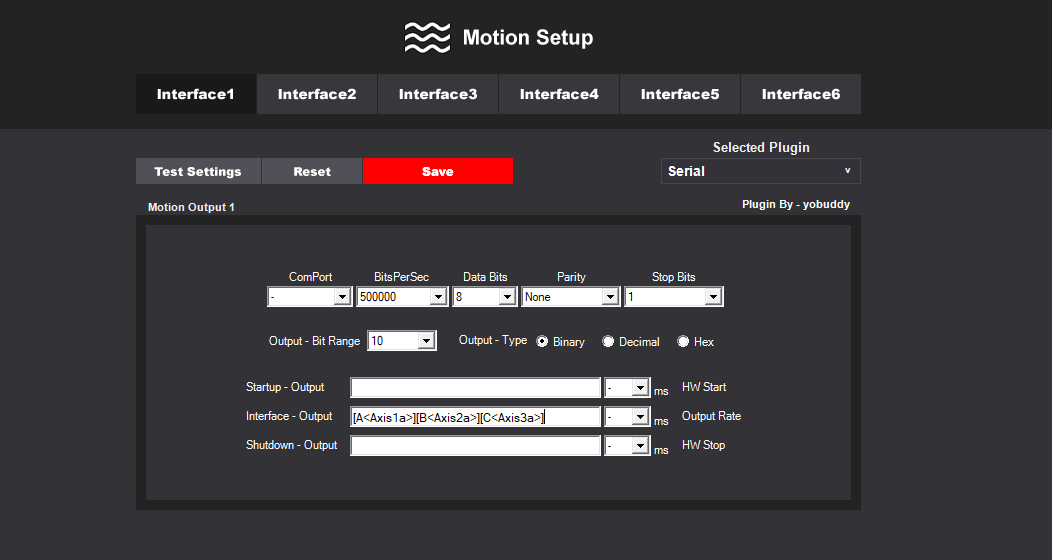

    Hello, I'm new to using SimTools period. I installed V3 after confirming my arduino based motor control works using SMC3utils. When I go to the interface setting on V3, I'm having difficultly getting the test setting tab move the motors. Is there something in particular I should be writing in the "Interface - output" fill in box?
    a screen shot of a working arduino based interface settings would be very helpful.
    Any advice would be greatly appreciated.

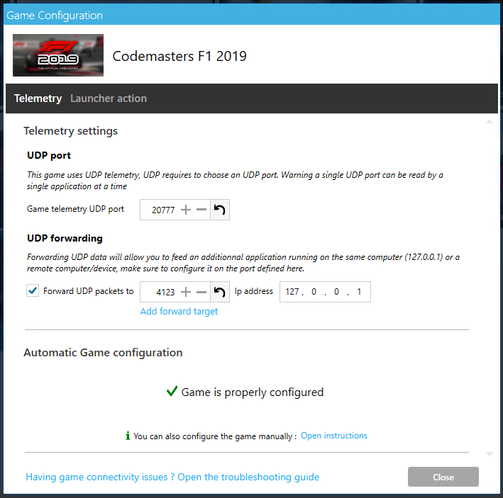

    Did someone suceed to using it with simhub to forward udp telemtry data? I have tried with f1 2018 and could not capture any data about motion.

    Yes you can use simtools and simhub codemasters games by adding an extra line in the hardware_settings_config.xml document
    for example this is the lines in my dirt rally 2 hardware_settings_config.xml that get simhub and simtools working together.
    I would guess the lines would work with other codemaster games to, good luck :thumbs
    <motion_platform>
    <dbox enabled="false"/>
    <udp enabled="true" extradata="3" ip="127.0.0.1" port="20777" delay="1"/>
    <udp enabled="true" extradata="3" ip="127.0.0.1" port="4123" delay="1"/>
    <custom_udp enabled="false" ip="127.0.0.1" port="20777" delay="1" filename="packet_data.xml"/>
    <fanatec enabled="false" ledTrueForGearsFalseForSpeed="true" wheelVibrationScale="1.0" pedalVibrationScale="1.0"/>
    </motion_platform>

    I think this might be what you need with the com port of your arduino selected i might be wrong as its been a while since i used SMC3 good luck :thumbs

    I have tried today this version and motion does not seem to work for me. It is working when I use it in test plugin but when capturing or. driving nothing moves. It is working with version 2 but with this new one no data can be captured. It is also confusing which telemetry data should be used in like F1 2018 or F1 2019 and also others plugins. It would be also useful to see which default udp port plugin uses and if possible change it. I have tried with simhub turned off and on with port forwarding of udp,..... Basically all the permutation options.
    It is also confusing this dash and vibe option. I use DIY license and when no game is running there is no option for vibe and dash but when the game rans and you alt tab it you can see vibe and dash option but with no option to select the right soundcard. I assume that this is a bug and there is no option for DIY license at all.
    I know I will sound like a smurf but some things are now made really nice but same are still not being user friendly. For example Interface - Output why does it need to be so complicated?
    Also it would be nice if there would be a possibility to select which motion user has. Like 2dof, 3dof,... and maybee smc3,...
    Do not take this as a negative criticism but i was fiddling few hours now with practically zero success.
    Will try to completly remove the program and reinstall it to see if it will fix anything.

  6. KevinWells411
    KevinWells411 New Member Gold Contributor
    Dec 25, 2022
    Southern Califronia
    4Coins
    Worked Perfectly! Thank you

    The plugins patch the game as needed without the user needed to mess with any settings (unless otherwise noted on the data page for the game.)
    Not available with a DIY license, I'll take a look at the bug.
    Because it's reconfigurable for many different types of hardware.
    All the settings you need are right in the thread for the smc3 sketch your using.
    Thou you might not need axis C depending on how you configured the smc3 sketch.
    Please note that you can not run the smc3 app and SimTools at the same time.
    (One one app can connect to the game data at a time.)

    - So it is best to do the patching once again when it was already done with simtools v2?
    - Which file is patched .exe?
    - Is it possible to patch it without driving first?
    - Also is it possible to put into the plugin info page the default UDP port used in plugin (this will be useful when used with SimHub to port forward the telemetry data?
    - Enable/Disable baloon tips in UI could be useful. ( like for crash detection, slow motion, smoothing of axes, dampening,..........)
    - I could not find in UI the settings to have one ''template'' settings for ALL the game plugins that can be used as a default template.
    - Maybe on the serial interface it would be useful to use dropdown manu and also add in the menu Custom so the users can manually writhe the settings in but also to have an selectable option for |A axsis1A,....... because I sat that a lot of users makes a typo when entering those settings. Same for startup and shutdown.
    - I like the picture in Next Level Motion that shows the movement of roll, pitch,..... I know it is basic but it can sometime help.
    TNX and bye.

    If a v3 plugin needs patching, then you have to patch, to install the plugin.
    Depends on whats needed for the game.
    Usually it's a settings file.
    Usually the game needs to be played one time so the game writes its setting to disk.
    (that we can then patch with the plugin to enable motion.)
    Afraid not, as collecting data is 100% done in the plugin itself in v3.
    But my bag of tricks is not empty yet, so do not fear.
    Once the manual is complete we can do this for sure.
    Save as Global (which will then be used for the default profiles for plugins installed of the same type.
    (Where there are 3 types of plugin, Air, Land and Sea.)
    It's reconfigurable thou, as I don't know the settings for all interfaces to have drop downs for each.
    But maybe a custom smc3 interface plugin would work.
    Then I get emails asking what extra1 thru 6 is all. (which I could not know is all.)
    But maybe a balloon tip when we get there.
    Later buddy!

    In this thread https://www.xsimulator.net/community/threads/codemasters-f1-2019-plugin.13587/page-4
    there are mentioned problems like dx12 mode and legacy mode and that it does not work with simhub port forwarding. Bunch of 'hacks ' are listed,.... Does v3 makes those obsolete?
    Has those issue been resolved in v3 and if yes which protocol should we use with simhub and which exe? DX11, dx12 or ordinary one.
    Maybee under patching notes additional information can be added like it is in simhub. Like when you click on Open instructions. I saw that there are some already like for Project Cars.

    All v3 f1 plugins use the proper api for output.
    So F1 2018 uses 2018 output and so on.

    After a lot of try and error I have managed to fix some games. And now I also know (i think) what was the key missing in the whole setup.
    I was configuring games with SimHub and udp porwarding option. The games were F1 2018 (i think there is a bug in a plugin and could not get it working uses 4123), F1 2019 (works, the key is that motion works only with 4123 udp port), same with Rally 2.0, Avtomobilista uses 5607 udp.
    This was the info I am missing on plugin page and this was the cause that motion was not working. It would help a lot if on the info page it would say which port the motion plugin listens. This would also help configuring SimHub with udp forwarding.
    For example then you can specify udp port in settings like in F1 2019 to UDP 20777, set this port in simhub to listen and then forward the rest to UDP 4123 so that the motion will also work.
    Also I could not get the F1 2018 plugin to work because the plugin can not capture anything and it is empty even if i have completed races. I assume that this plugin also uses 4123 udp port.
    Screenshot of empty limits and also manually tweaking always goes to 0.
    Hope this will help someone when configuring it.
