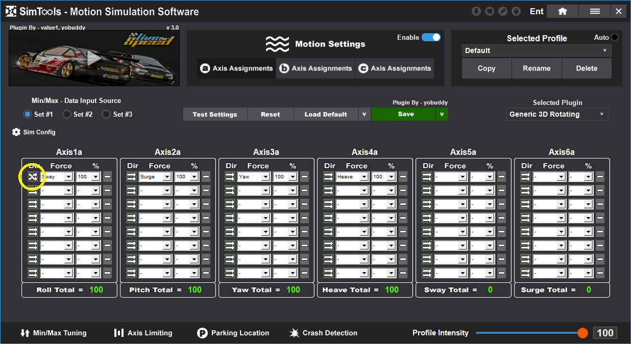

    I want to add absolut value of sway, if the value is positive ok, if the value is negative I must convert it to positive value. Is it possible to do that with simtools ?
    Thanks.

    Click the 'Dir' box by the dof in Axis Assignments, and it will flip the direction of the axis.

    Sorry I miss understood the question.
    What are you trying to do here?

    I read this post but I think it's not that i want to do. This custom SMC3 code allow to cut negative values but I need to convert it in positive value.
    In simtools v3 it's possible to invert value but not to take absolut value. Maybe you have a trick to to do it in Simtools.
    Thanks.

    You can control the direction of the axis here:

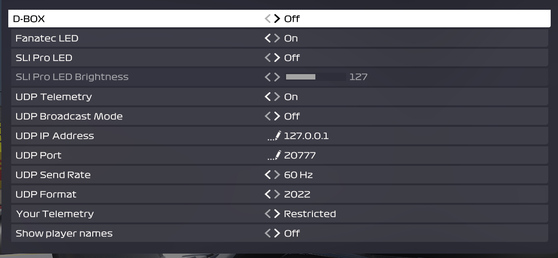

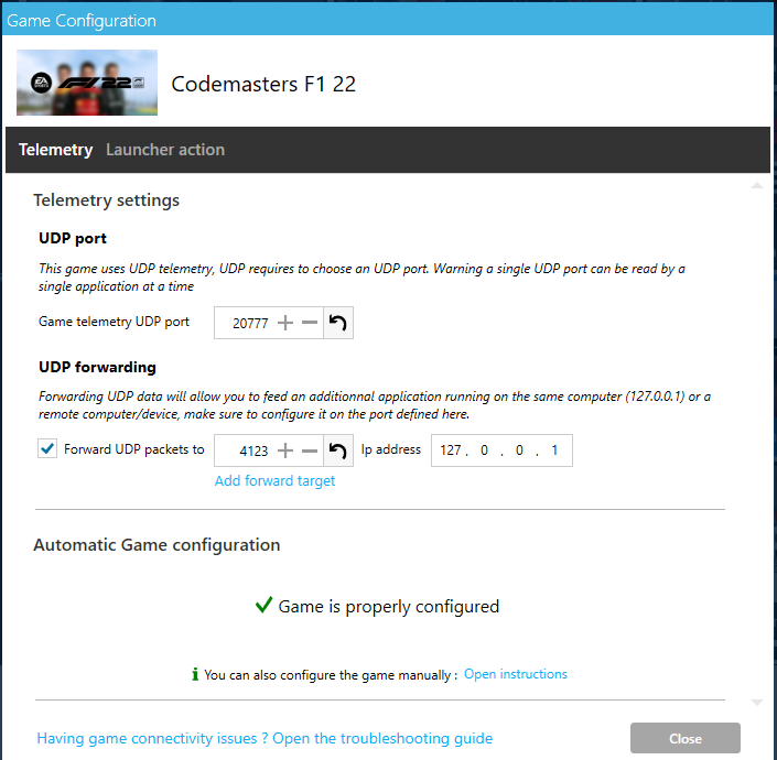

    Hello, the updates for f1 games are perfect with the 2022 format for the 2022 games just a little problem with simhub, simtools v3 alone works but when I turn on simhub works and simtools closes.

    Hi @bruno1210
    I have Simhub and Simtools v3 working fine together using these settings
    Simhub use forward udp packets to Simtools port 4123
    Then in game settings like this
    Hope this helps :thumbs

    simtools closes when launching the game but the telemetry works on simhub weird pity thank you.

    Simtools closes with all games ! setup

    I need absolut value not invert. Is there fonction abs() in simtools ?

    @bruno1210 i had that the other day the only fix i found at the time was to uninstall then reinsatall Simtools and yes pain in the butt to reinstall all plugins and set them back up, but good job i took screenshots of my axis and max min settings lol

    You can only have 1 application accessing the games telemetry port at a time.
    So whichever app you start first will work.
