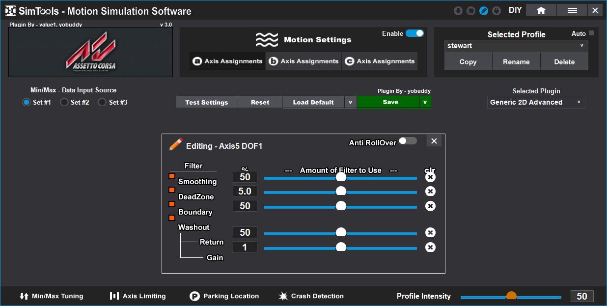

  14. yobuddy
    51,778Coins
    +5,206 / 19 / -0
    These settings are sim protection and they should be global settings.
    You can configure the axis assignments easily to set the about of range wanted per profile, so its not something you need axis limiting for is all.
    Take care!

  17. yobuddy
    51,778Coins
    +5,206 / 19 / -0
    Roll and Pitch has already been reported as having problems in that game.
    You can delete the plugin and reinstall it.
    It's just the dirt 2 settings thou, since it's based on that game.
    In axis assignments, you can set how much of the axis you what to use.
    So if the settings is at20 percent, then it only uses 20 percent of the axis.
    So you can configure it to the needed amount there, without axis limiting is all.
    Take care,

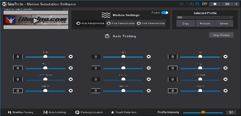

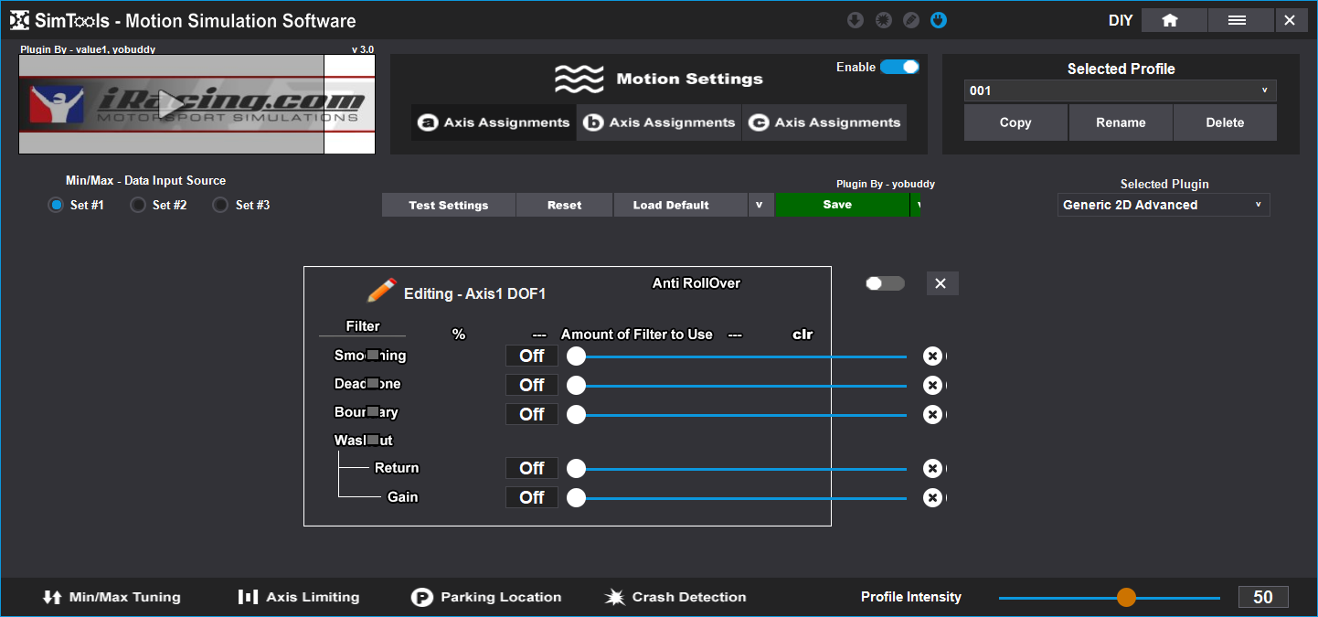

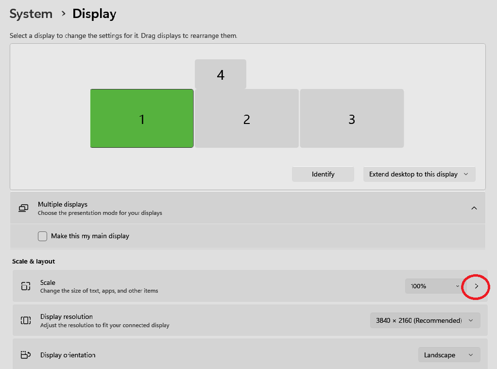

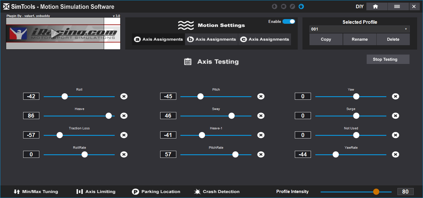

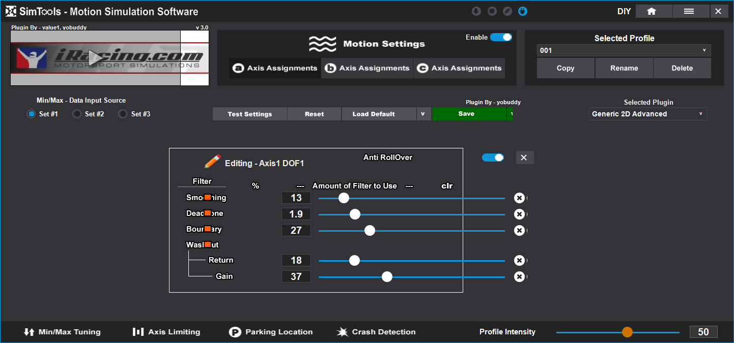

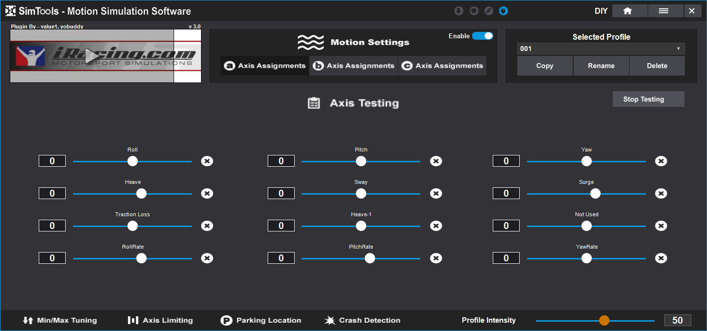

  19. horyoryo
    horyoryo New Member
    Sep 23, 2021
    18
    - 19Coins
    +11 / 0 / -0

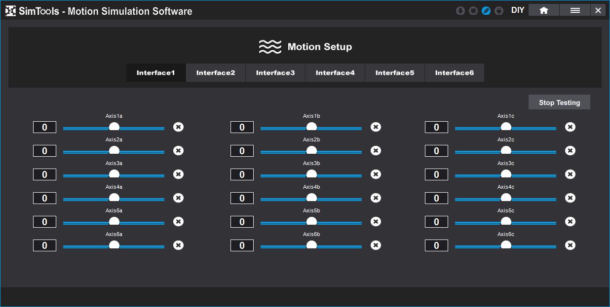

    The drag bar in the test settings can be manipulated by setting the custom scaling to 105%
    The drag bar on the test screen cannot be operated
    OS is windows11 or 10, language is Japanese
  20. horyoryo
    horyoryo New Member
    Sep 23, 2021
    18
    - 19Coins
    +11 / 0 / -0
    From the setting screen of windwosOS, select custom scaling and enter 105%. and sign out.
    Start simtoolsV3 after signing out
    The drag bar doesn't collapse. can be operated.
    The edit screen is defective, but can be operated.
    please fix it soon I'm looking forward to it.
