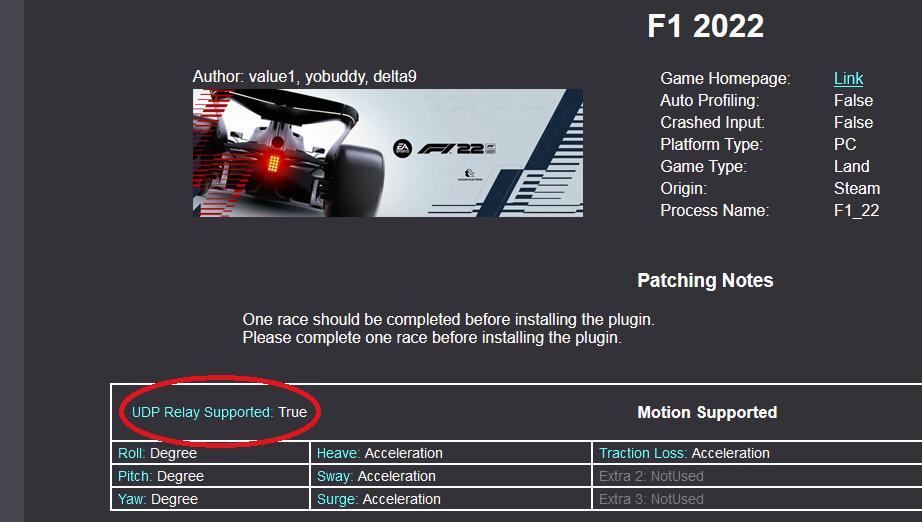

    You can now check online if udp relaying is supported for a given plugin from its data page.
    Like for f1 2022 found here: https://simtools.us/plugin/?varname=24&color=0e97dd

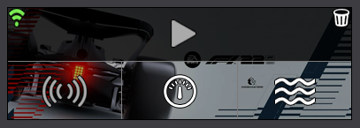

    With a plugin that supports UDP Relaying, you will see a Packet Relay icon on it's game banner menu.

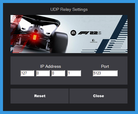

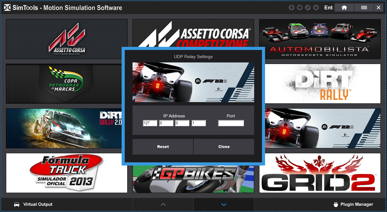

    With the window open, add the port to send too (and IP if not on the same PC) and click close.
    (You can click reset and close to remove the setting too.)
    UDP Relaying enabled for a game will look like this.

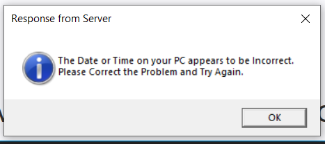

    I'm having a problem when register the license with v3 Beta:
    I do have a pro lisence of V2.
    The date and time on my computer are correct, but may be some timezone issues?
    22,230
    154,849Coins
    +11,228 / 57 / -2
    Try updating to the latest version of SimTools v2 before trying to register v3 Beta, as that has some license related fixes: https://www.xsimulator.net/community/marketplace/categories/simtools.37/
