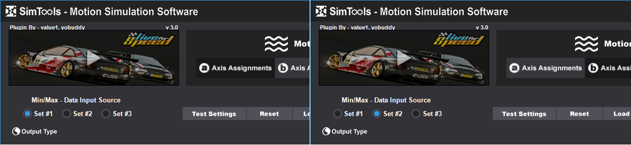

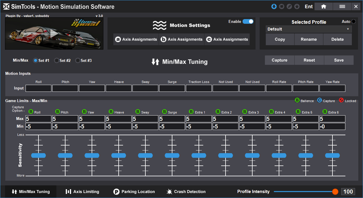

    Hi @yobuddy I test new version. I found 2 bugs : when u turn on test on game profile and test b axis, a axis also work.
    When u set max min on a, b axis. That value is set to a and b axis. U can't set separate values to b axis. I have belt tensioner on b axis and can't set it only for braking for now. In simtools 2 it was working
  5. yobuddy
    51,778Coins
    +5,206 / 19 / -0
    If you talking about axis testing, then this is how it should work.
    (As some people need to use a dof more than once for their motion profile.)
    I don't understand, there is now a Max/Min set 1 thru 3. And I seem to be able to set all 3.
    And know that in axis assignments, you can control what set of max/min's you are tied too.
    My guess is you have both axis assignments tied to set 1 is all.
    Take care!

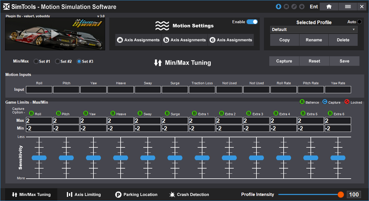

    I don't understand. I have max min data input and I set max min for seat there, and in max min data input 2 I set max min for belts?
  7. Krzysztof Dej
    Krzysztof Dej Active Member
    Jun 3, 2020
    315
    Poland
    1,100Coins
    +74 / 0 / -0

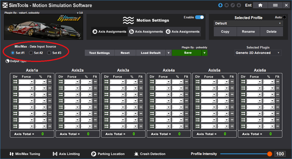

    I don't understand maybe can u show me an exemple haw to set 2 interfaces max min separately? For me how I understand max min data input source is like 3 cars setup profiles. U can set 3 types of movement profile. I want to set max min for a axis assignment for my 2dof chair and only max for surge in b axis assignment. Thanks for answering take care

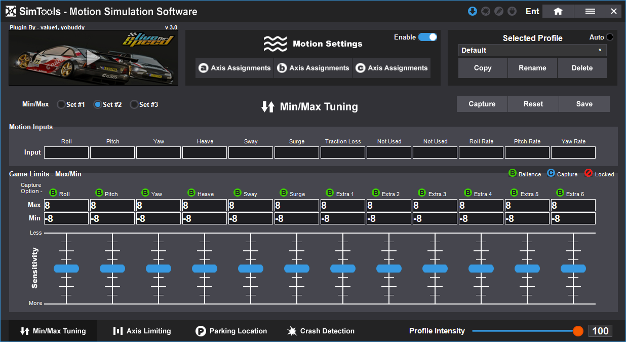

  8. yobuddy
    51,778Coins
    +5,206 / 19 / -0
    All you need to do is set A Axis Assignments to use Min.Max set #1, and set B Axis Assignments to use Min.Max set #2. (like in the pics below)

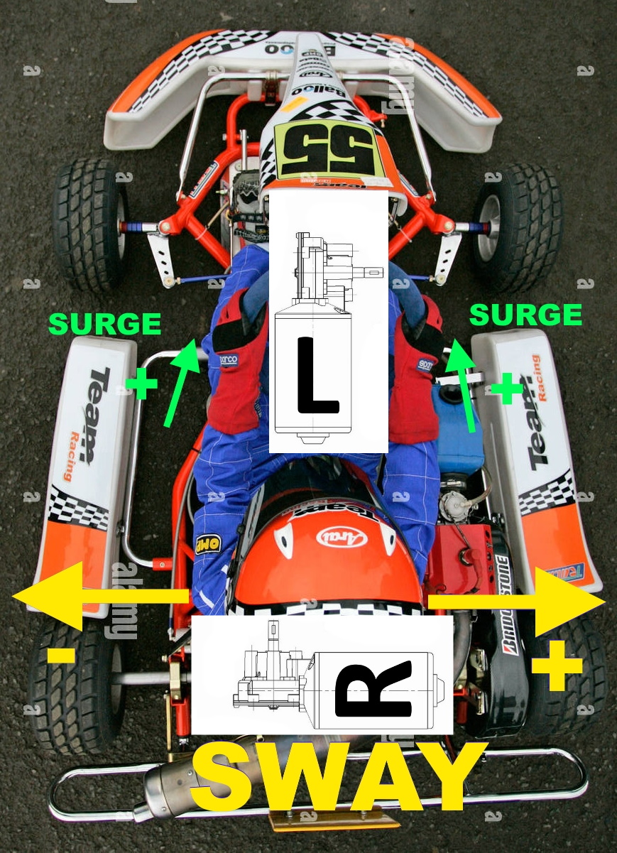

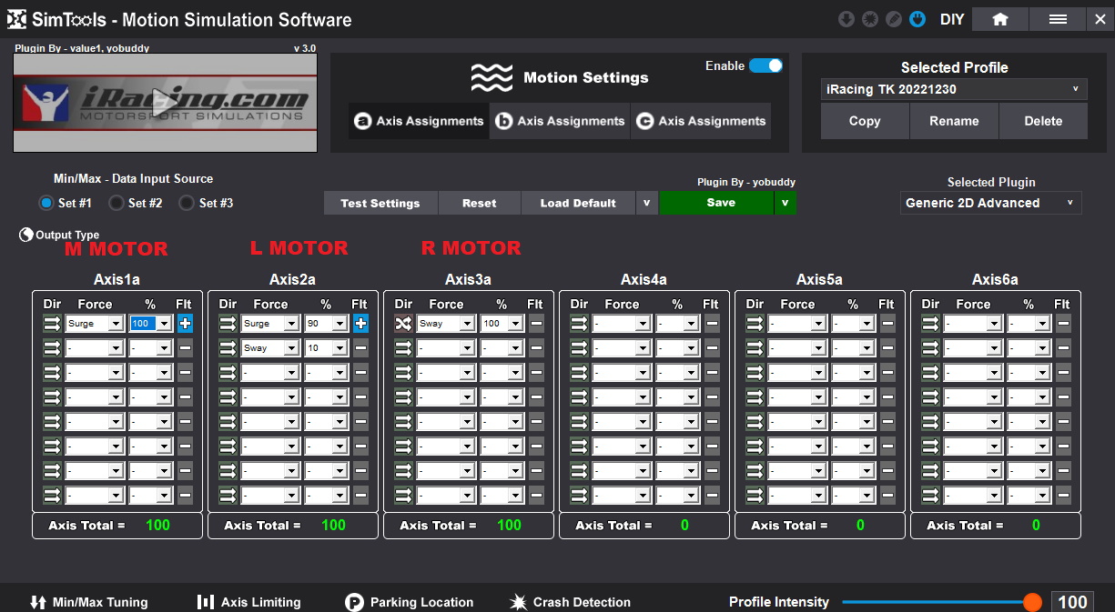

    Hello Yobuddy,
    I must explain you some details on my G-seat to allow to understand why i need the absolut value.
    I don't have any lateral flaps, my upper part seat back can move on 2 directions, 2 motors allow it (axis L et R) (see schematic karting picture joined)
    If i take a positive R value, it's OK but if I take a negative R value i must transform it in positive value to add it on L axis to create the wished effect that you know.

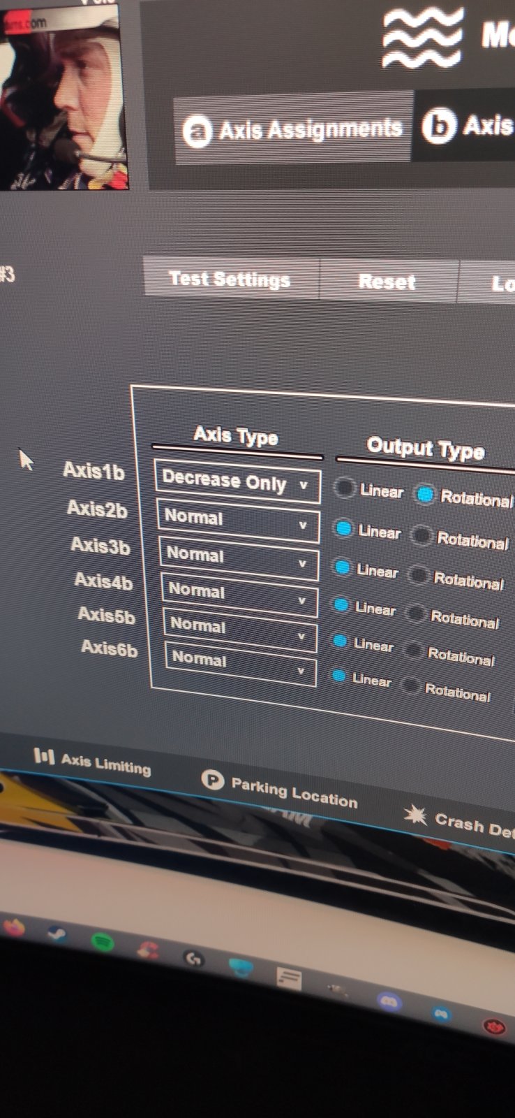

    Open the registration page and click activate.
    Sorry, I still don't really understand, but in advanced axis assignments there is options for Increase only and Decrease only axes. Maybe this will help?

    @TomKlash,
    May I see your axis assignments buddy, I think it may help me get an idea of your sim.
    I would take a pic of your sim too, if you have one?

  16. yobuddy
    51,778Coins
    +5,206 / 19 / -0
    In you pic above, it looks like R does sway by itself, and L does surge by itself?
    What is M motor?
    So R only extends when sway is positive.
    And you need L to extend when sway is negative?
