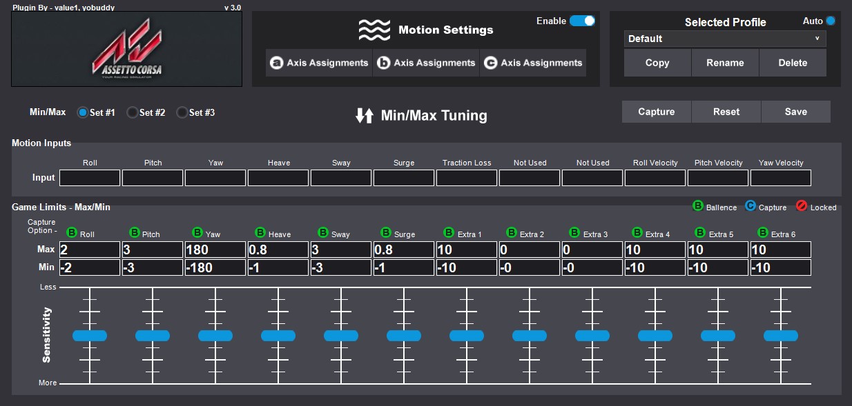

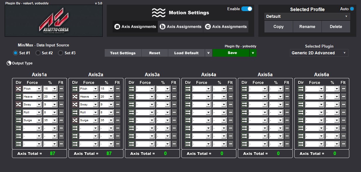

    little update from my test.
    so i try to play assetto and the simtools v3 doesn't detect my game as it should.
    i've done the setting and it works with testing in menu.
    but when i start the game it just wont work
  4. yobuddy
    51,734Coins
    +5,205 / 19 / -0
    You have auto profiling on for the game, please make sure the other profiles created have settings also.
    (Auto created profiles will copy the settings from the default profile for the game. but if the default one at the time did not have any settings, then the profile will be blank.)

  6. itsumairu
    itsumairu Active Member
    Dec 13, 2021
    210
    Psychologist
    Indonesia
    440Coins
    +92 / 2 / -0
    2DOF, 3DOF, DC motor, Arduino
    yeess it works!
    so basically I just have to save it to default setting.
    thank you sir! you're the man!
    love you! lol
    now I just have to fine tune my setting and try it on another game.
    cheers!!

    Or you can turn off Auto profiling for the game too and just select the default profile.

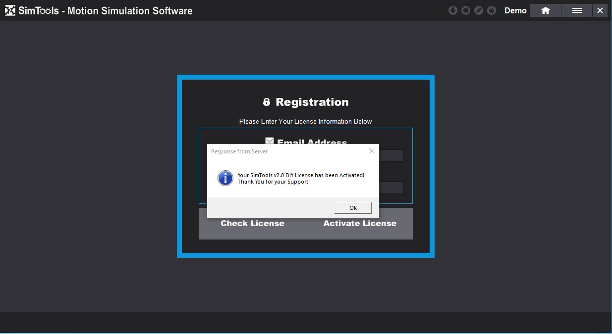

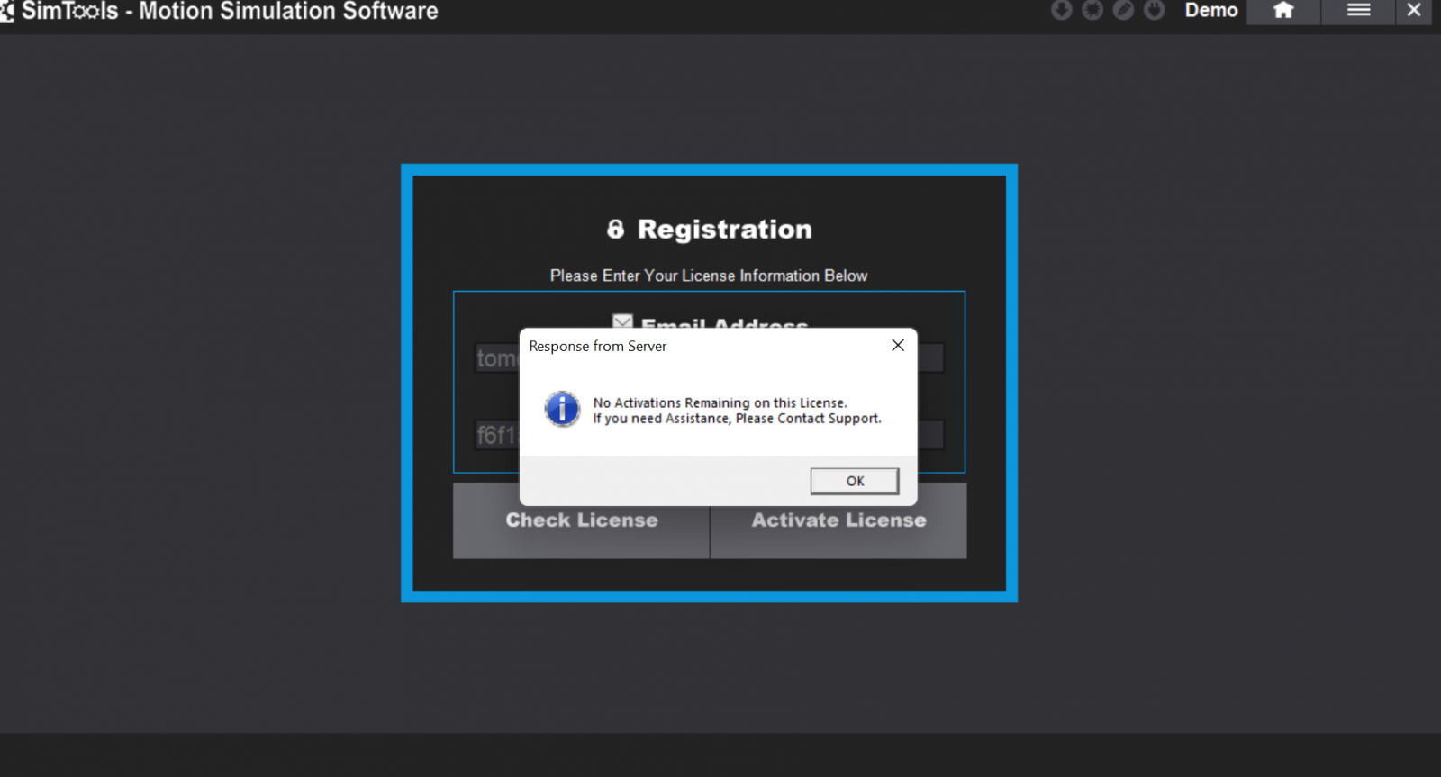

    Ok so when I go to register I get this.....
    Any help?

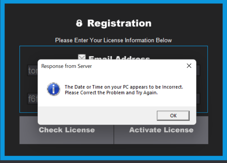

    So updates simtools v2 to v2.53 now gives me a different error.........
    And I can assure you my clock is correct, albeit it's that funny United Kingdom time.

    Hi @p00ky,
    Rich sent you a couple more activation's, so this should not be a problem anymore.
    There is no need to re-register v2 when upgrading, but if you did it should not matter to much.
    Please give it another go as you now have more activation's.
    Chat soon
  11. p00ky
    p00ky Active Member
    May 4, 2020
    117
    Self Employed Laser Cutter
    Wales
    392Coins
    +66 / 2 / -0
    Just woke up this morning and tried it again and the registration went through. Thanks yobuddy. Looking forward to trying this out today :)

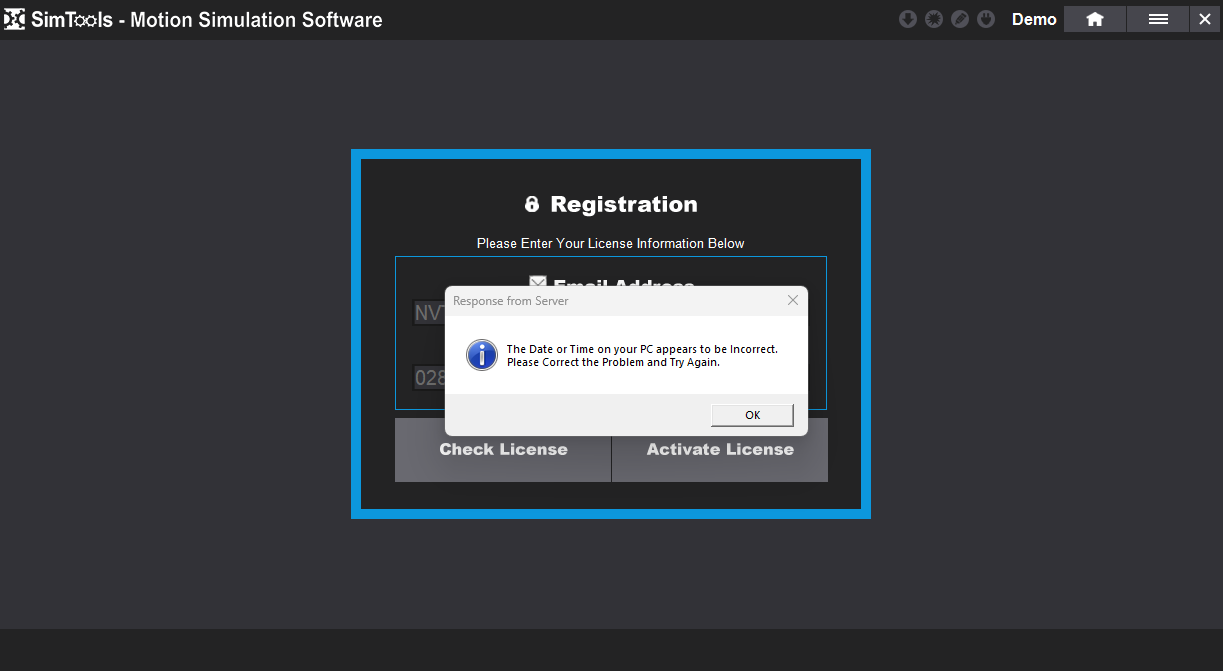

  20. tina540
    tina540 New Member
    Apr 6, 2022
    14
    - 44Coins
    +3 / 1 / -0
    hello here also no way to activate the license
