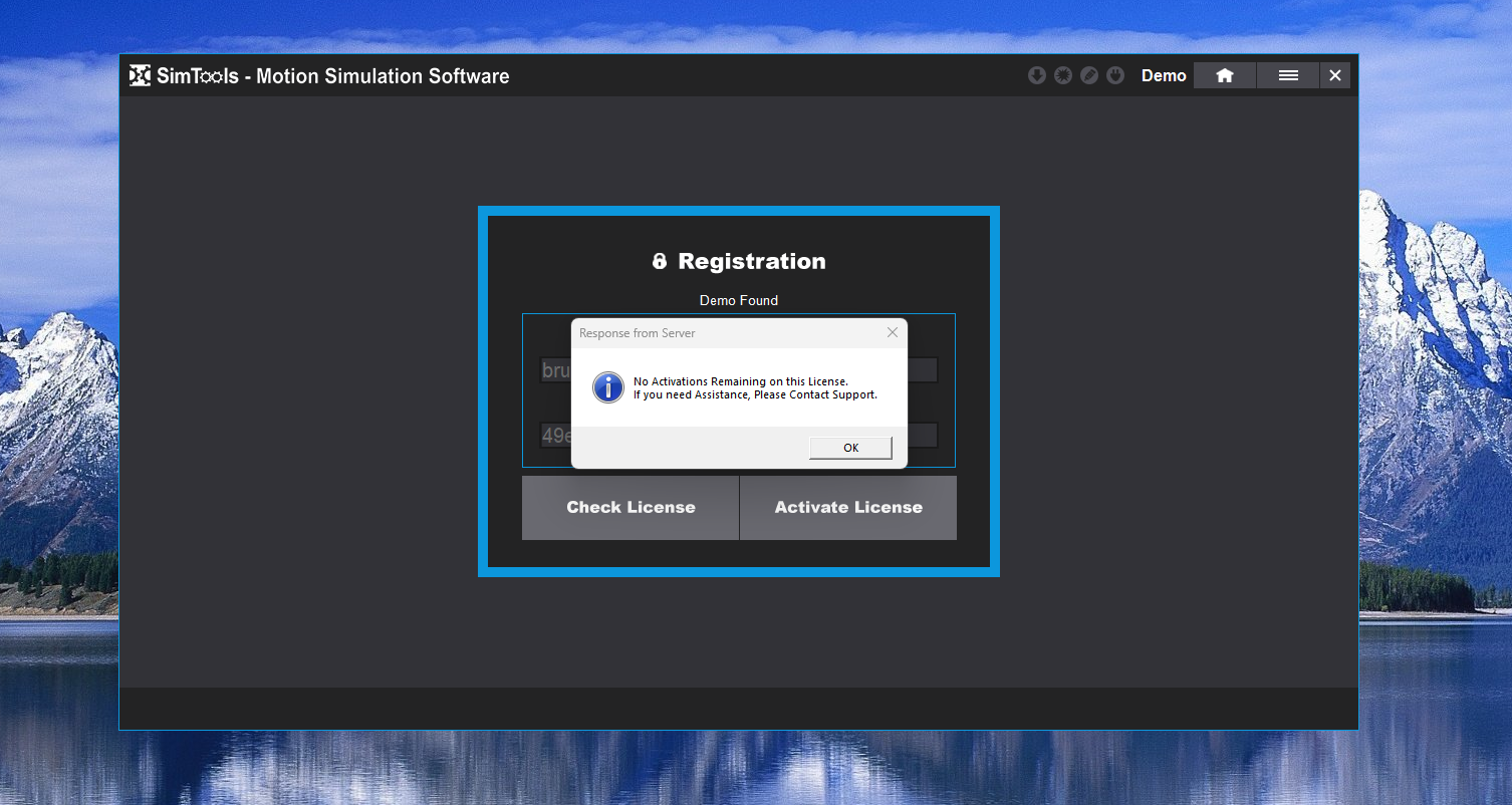

    my license is active with win 10 I updated win 11 simtools v2 works but for simtools v3 it asks me for activation?

    @bruno1210,
    You still have not told me what happens when you try to register buddy?

    Hello everyone here is my activation problem .
