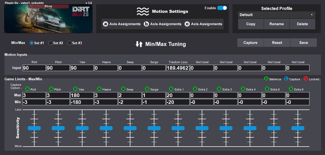

  8. itsumairu
    itsumairu Active Member
    Dec 13, 2021
    210
    Psychologist
    Indonesia
    440Coins
    +92 / 2 / -0
    2DOF, 3DOF, DC motor, Arduino
    hello.. after I finish my traction loss project I give a try on V3, and before its works fine, but now I cant get it right.
    in V3 my traction loss always move to the right side and stuck there, no motion whatsoever.
    here my settings
    I try to capture but the value keep changing to 90 for roll and pitch, and for TL its random number.
  9. yobuddy
    51,778Coins
    +5,206 / 19 / -0
    This plugin is being worked on right now.
    Please give us a bit to get it strait.

    @itsumairu,
    Please let Dirt Rally 2.0 update and give it another shot buddy.
    Take care,

  19. itsumairu
    Dec 13, 2021
    210
    Psychologist
    Indonesia
    440Coins
    +92 / 2 / -0
    wow thats fast.
    okay, I'll test it when I home.
    thx man..
  20. yobuddy
    51,778Coins
    +5,206 / 19 / -0
    Be aware that you may need to remove the old and and restart simtools v3.
    Then install it again from the repo.
    Take care!
