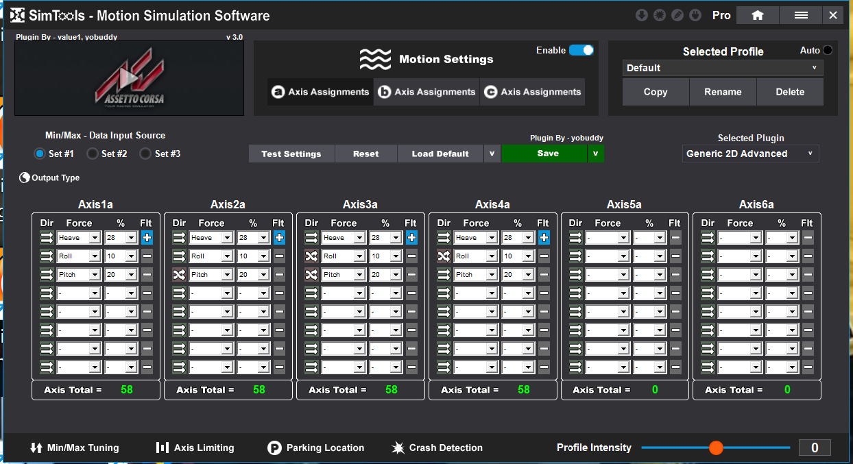

  3. itsumairu
    itsumairu Active Member
    Dec 13, 2021
    210
    Psychologist
    Indonesia
    440Coins
    +92 / 2 / -0
    2DOF, 3DOF, DC motor, Arduino
    thx for your hardwork bro.
    I've done some testing and the TL is working, but I find that the roll, pitch, and sway behave so jerky.
    I try to do some fine tuning and here's mine
    I try v2, and the plugins became weird as v3 before, it move to the left and do nothing. I have to re patch the plugins to make it works. so the v2 and v3 cannot work side by side I think.
    just like before, the v3 doesn't support simhub to work together. with v2, I can play it together.
    addition.
    for the WRC, it work good, but in menu, the motion sometimes jumping around randomly.
  4. yobuddy
    51,777Coins
    +5,206 / 19 / -0
    The output for sway particularly requires no math at all.
    So its the direct output from the game.
    So my guess is you need to adjust the max/min for the game.
    V3 and V2 do work side by side, but you may not be able to load a plugin for the same game in both without re-patching. In most cases it will work thou.
    Not true, both of these v3 plugins now have UDP relaying built in making it super simple.
    Take care!

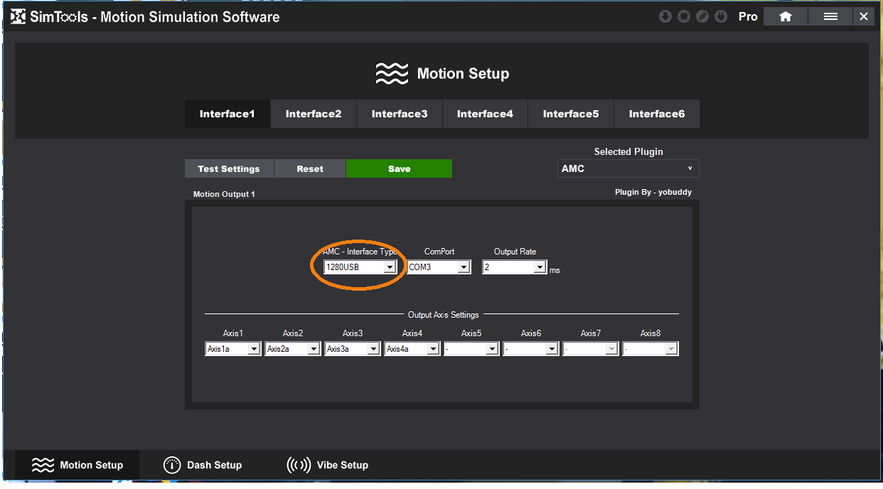

  5. lVlemphiz
    lVlemphiz Member Gold Contributor
    Jul 21, 2022
    41
    Automotive Engineer
    252Coins
    +15 / 0 / -0
    3DOF, AC motor, SCN6
    Hi thanks for the help
    axis assignments seen here. I don't know why SimTools is so small on my screen. It did that once and never went back to full size (4k television)
    Interface here

  12. yobuddy
    51,777Coins
    +5,206 / 19 / -0
    You just need to set the right controller here buddy.
    It's set for the 1280USB controller is all.
    Take care!

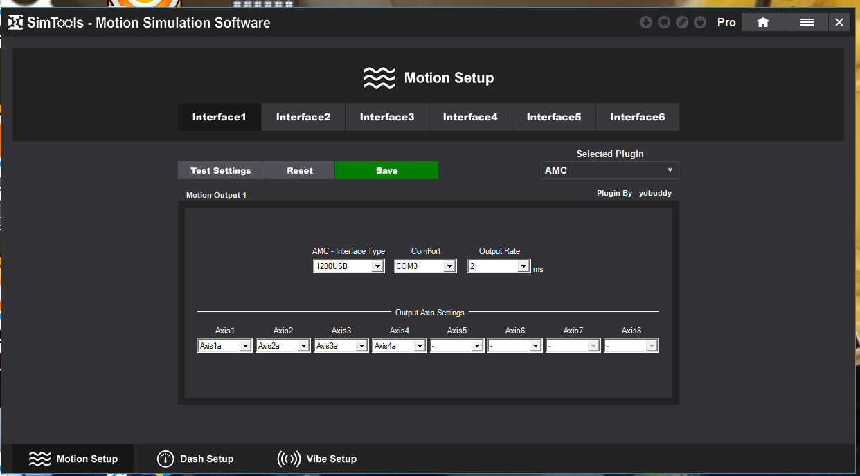

  15. lVlemphiz
    Jul 21, 2022
    41
    Automotive Engineer
    252Coins
    +15 / 0 / -0
    I did change this and unfortunately it didn't help.
    I notice the behavior is identical in Simtools 2 as well. So I'm not sure what's going on. It just wants to register the heave motion twice for whatever reason.
  16. yobuddy
    51,777Coins
    +5,206 / 19 / -0
    Then my guess is you need a firmware update.
    @Thanos, little help buddy...
