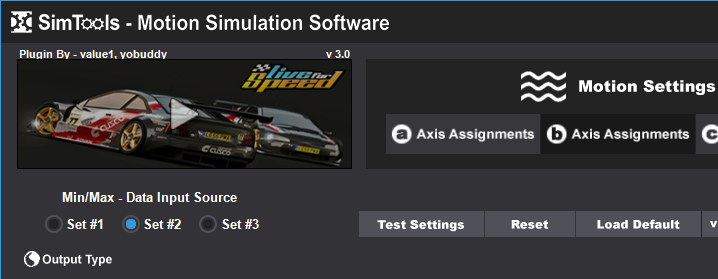

    One question.how can i use set#1 and set#2? I changed in surge in set#1 one value to Zero and i have only move in one Direktion(acceleration)in set#2 i changed this Same value to Higher value and there ist no movement in breaking seems to be the Same as set#1i want tohave two different movement in Breaking and acceration. Do i Something wrong?

    For v3, please go-to (b) axis assignments and make sure that in the upper left hand corner, the (b) axis assignment is tied to Max/Min Set #2

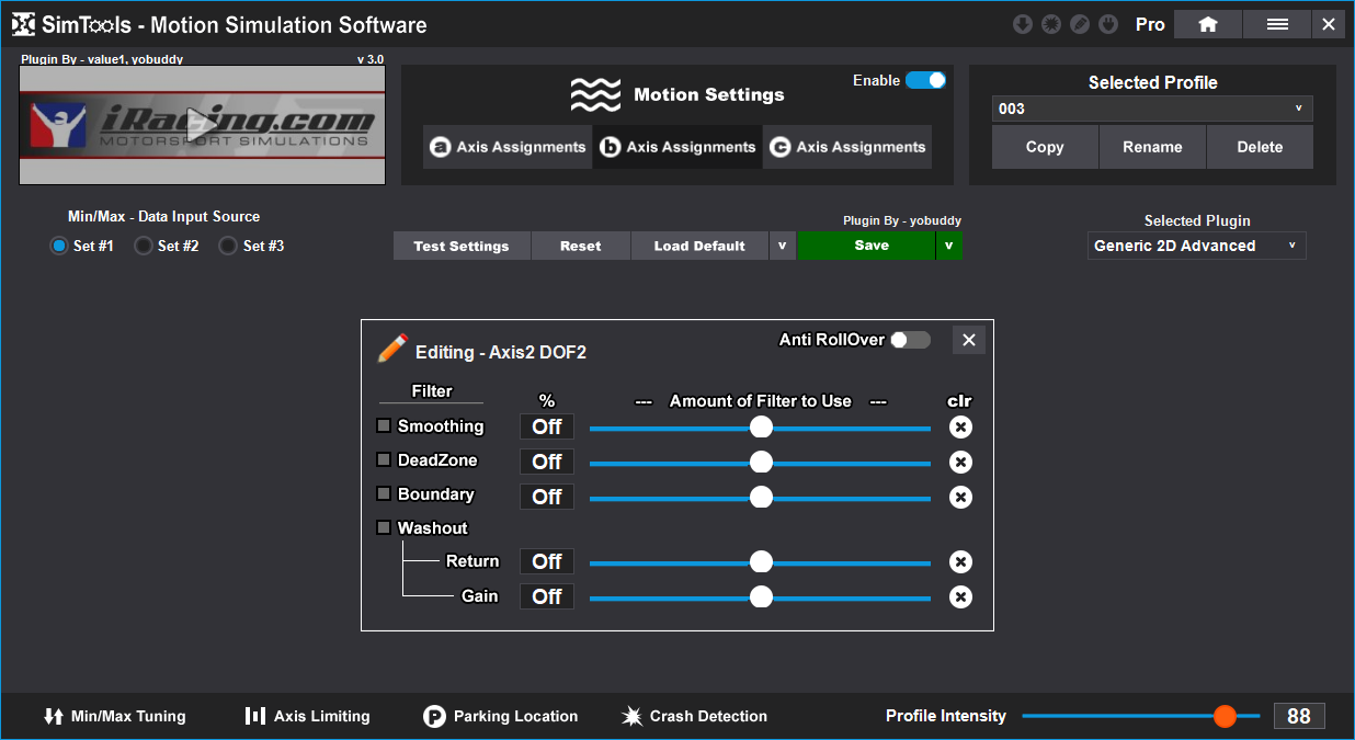

    The filter does not move The slider does not move I want to fix the problem
