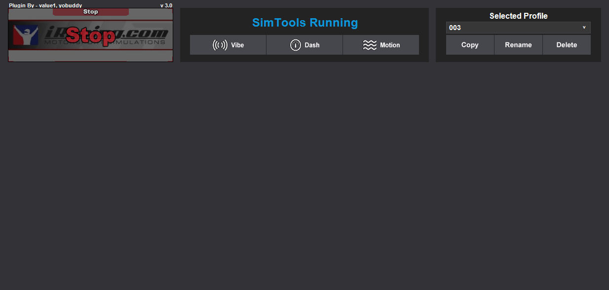

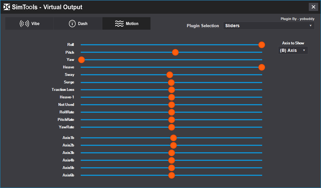

    Start motion on Virtual Output.
    Then click stop or the motion will stop after the game ends.
    At the same time, it is a problem that the Virtual Output screen closes in conjunction
    After that, it's tedious to manipulate the Virtual Output every time.
    Please fix the Virtual Output screen so that it continues to display

    The update for RBR fixed the surge issues but sway is still jerking around.

    I just tested for this and sway is working for me as expected. Please modify your max/min values if you are getting a lot of movement and see if that resolves this.

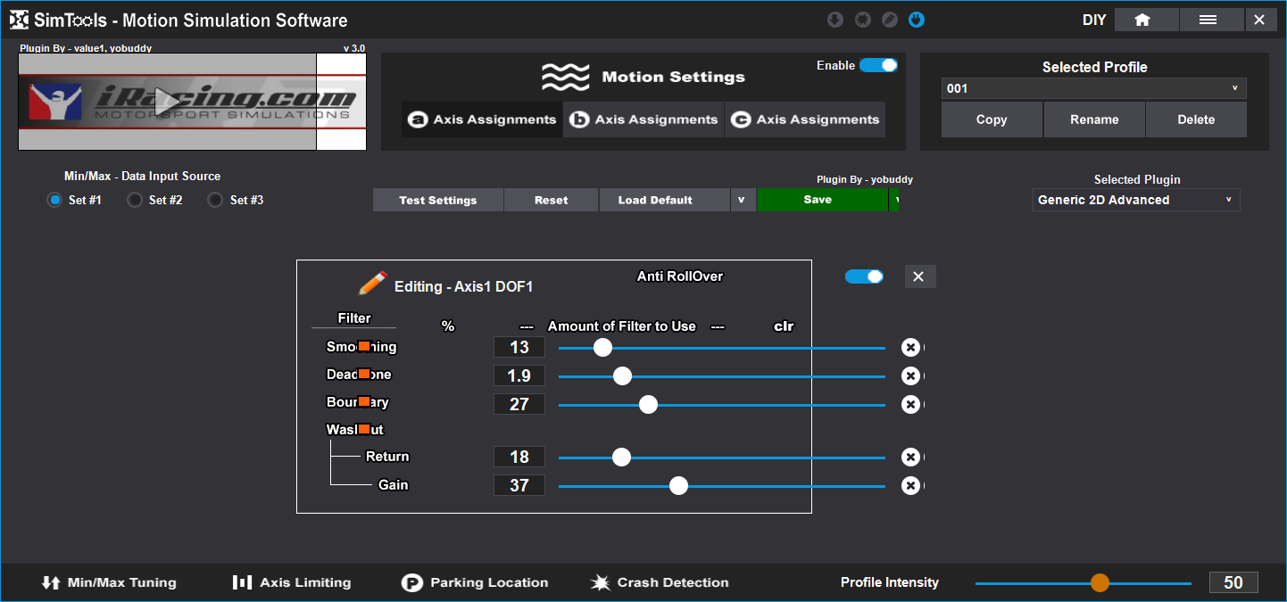

    Hello I'm new with motion. I just bought a prosimu T1000 3m. It's nice to find a community that help.
    I'm using simtools V2 with IRacing and it works well but I can't use V3.
    Is there a process to follow or something to do I missed ? I download the plugin and installed it. Simtools said it's good. I created a motion profile and when I start the game nothing works. it seems the game don't send data cause I can't capture min and max tuning.
    Thanks for help

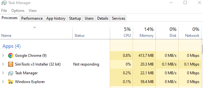

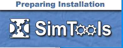

    Hi , i'm just reinstall new Window 10
    and try to install Simtool (V2.6 and also V3.0)
    it stuck at Preparing Installation and show
    Status Not responding in the Task Manager
    i'm try disable all anti virus /install avast antivirus/ run as adminitration
    change region / language to US / reinstall window 10 again
    do i miss something ?
    Thank you in advance
  18. noddyier
    noddyier New Member Gold Contributor
    Dec 16, 2021
    - 384Coins
    Update Some How i can install , no idea why

    My guess is Window 10 needs to updated, and you may want to make sure .net is up to date also.
    Lastly, I would install AVG free and give it another shot.

    Do you have max/min values for the game?
