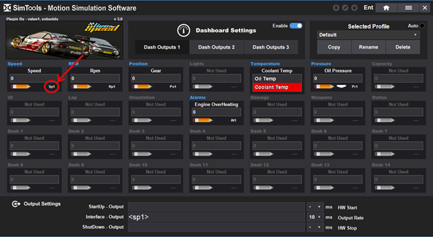

    First, go to interface setup, the interface button in the main menu.
    (Same place you setup motion)
    And click the dash button at the bottom left of the page, and setup the dash interface.
    Next go to the game you want to enable dash for and setup the interface output.
    But now we use the labels show in the gui, so for speed, we use sp1. So interface output = S<sp1>
    Use the pencil for speed to add your commands and your golden.
    Let me know if you have any problems.

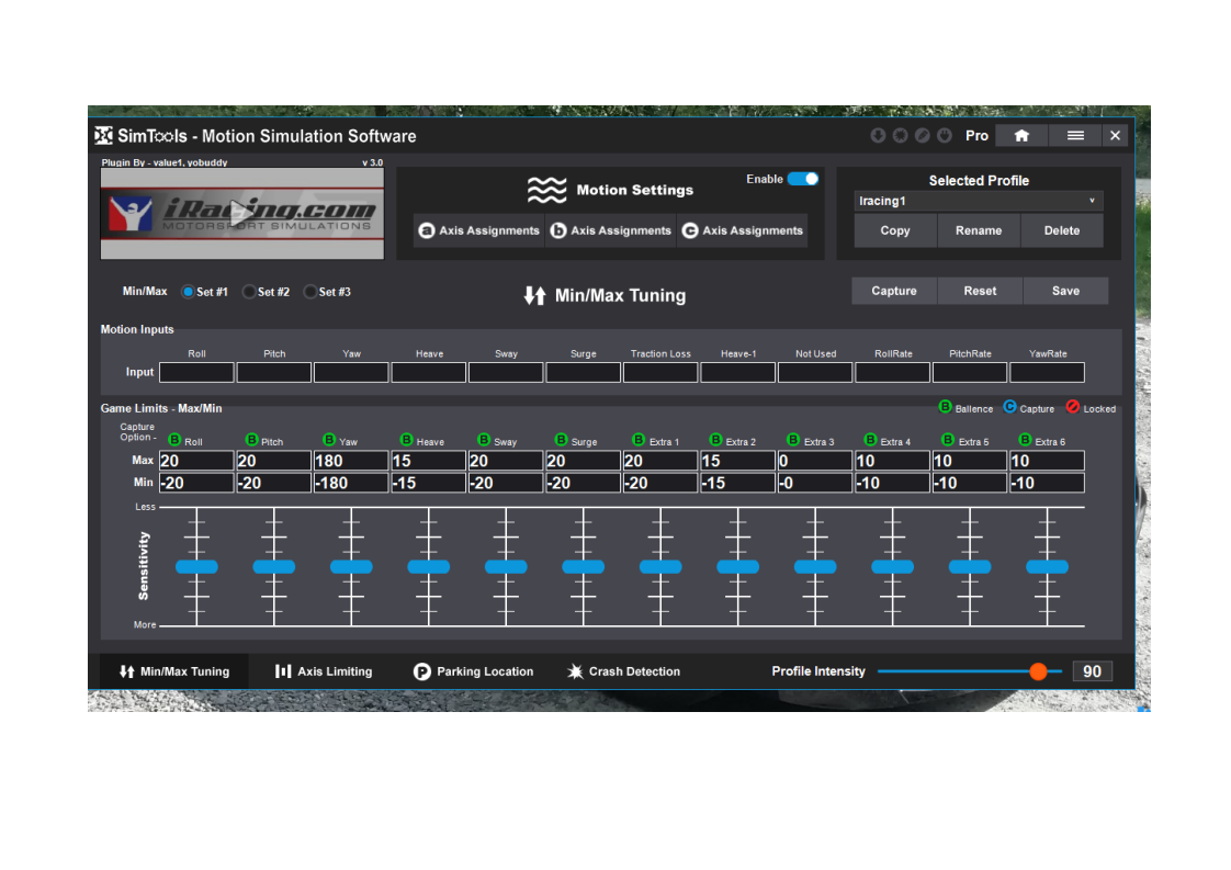

    I installed V3 DIY version, LFS plugin, and set Generic 2d Standard and axis. ...but cant see "Motion inputs".
    I tried: defender: 0ff, reinstall with admin rights - but nothing...
    I installed V2, set same that in V3, and V2 work perfect and see motion input.
    My problem is I want to use race07, but as far as know the Race07 plugin is paid for V2. Its thru?
    Can someone any idea for fix V3 ?
    thx.

    What interface plugin are you using in v3?
    Only Live for Speed is available without a SimTools license.

    I tried : memory map and serial, but after reinstall dont set any plugin. At the first I like see the game datas. Can I see motion input without interface plugin?

    Use the network plugin maybe, if you want to just see stuff move.
    SimTools needs a reason to actually compute the data.

    Thx, its working, now. :)
