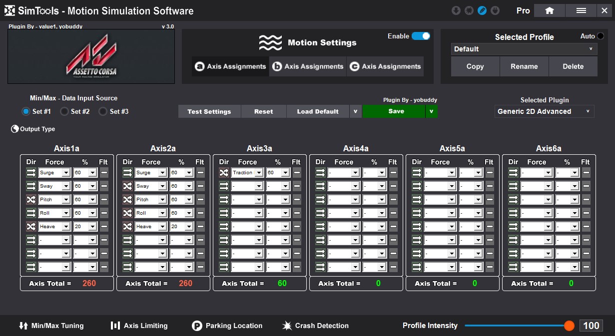

    Here I am too to better test the new SimTools in beta. First of all I proceeded to update SimTools 2 to 2.5.3, as it includes a license fix for those who wish to use the same for the v3 Beta too ...
    I only have a doubt: after having downloaded and installed the update, in fact, if launch SimTools, the word SimTools 2.5.2 (instead of 2.5.3) appears, is this normal this?
    Furthermore, in the "old" SimTools in the Axis Assignments screen were indicated DOF 1, DOF 2, DOF 3 and so on ... while in the screens of the new SimTools 3 I do not find these items but only columns named as Axis1a, Axis2a, Axis3a and so on (which actually can also be renamed), so these are the ones I could change their name to by indicating DOF 1, DOF 2, DOF 3 etc. again...?

    OK... so if I understand correctly, by returning the parameters of the "old" SimTools 2.5.3 in the new interface I get what you see on the screen. Is this normal or is there something wrong?
    Does the total number of Axis1a and Axis2a (260) in red indicate a problem compared to the Axis3a (60) colored green or is it just a visual thing of the interface?
  20. yobuddy
    51,734Coins
    +5,205 / 19 / -0
    260 means you will have a lot of clipping when running is all.
    I suggest keeping it around 125 or so max.
