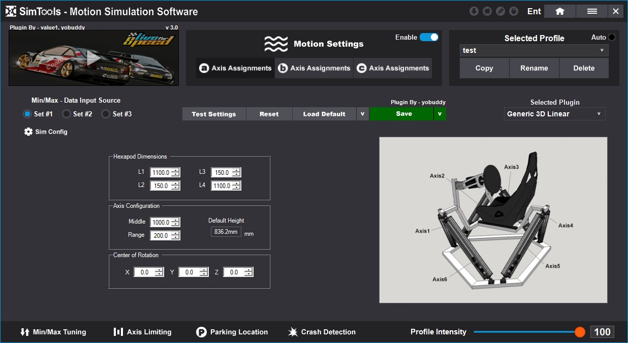

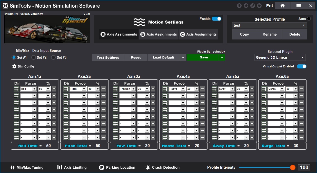

    Can't change the axis number?
    https://www.flyptmover.com/outputs/thanos
    I set it up for Thanos by referring to this page.
    It moves, but it moves in the wrong direction.
  6. yobuddy
    51,776Coins
    +5,206 / 19 / -0
    Actuator #1 is the front right, and goes in clockwise order.
    (Just like mover)
    You just need to adjust the output axis order in your interface settings.
    May I see a pic of your interface settings?
  7. Mu-KwangKim
    Mar 14, 2012
    124
    South, Korea
    - 689Coins
    +33 / 0 / -0
    Ah~ ok. i'm understand.
    It works fine.

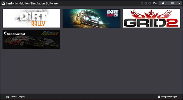

    I can't get AC to work with motion when using content manager? It works fine when just using the ac plugin but don't know how to get it working when going through content manager. If anyone can help that would be very much appreciated.
    Thanks in advance hug:
  20. yobuddy
    51,776Coins
    +5,206 / 19 / -0
    Do you mean when you hit the play button?
    If so, simply go to the .exe of content manager (or a shortcut to launch content manager) and drag it over the games banner in v3.
    Now when you click play it will launch content manager.
